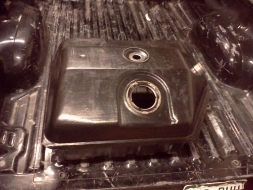

On the Bronco II tank, does the Ranger pump, sending unit, etc. swap right over to the Bronco II tank or were Bronco II units needed? About to start my 1 ton swap onto my 2WD Ranger and have been reading your thread relentlessly.
Thanks for all the info!
You need a efi BII tank that has the larger 3 5/8" opening, then the Ranger pump assembly will drop right in. Then just extend the lines and harness and you are good to go. I believe the split was in 1986 but you can see the difference in tanks in these pics.
84 BII tank
88 BII tank on left, 84 on the right
I don't think the newest ranger pumps will fit though. The pump I am using from the 01 cab is much larger than the 94 pump

I apologize for the delay in getting back to this, but it looks like Crawlin did a good job of answering the question. And yes, I literally dropped my Ranger pump into the BII tank paying attention to how the fuel level sender was sitting. I did not bother trying to make the fuel gauge read correctly, I just know that when the gauge reads 1/4 th tank, I need to start looking for fuel! :icon_twisted:
Despite others complaining about the loss of ground clearance by going to the BII tank, I have yet to be in a situation where it caused me an issue. I can safely say that having the extra fuel capacity its friggin awesome for the amount of driving I do with this thing (I have a very comfortable range of 260 ish miles, though I've pused it as high as 290).
Hope that Helps
I think things changed a bit when they went to a 'returnless' style of pump, but I have not played with one first hand.

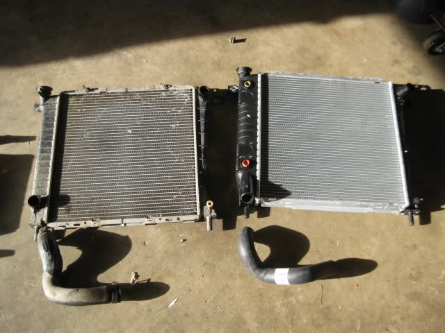

I’ve been fighting a bit of an overheating problem on the Ranger on the trail as well as some highway conditions (pulling long hills for example). I’ve also known that I needed to do something about my leaking intake and valve covers. Over memorial day I tackled both issues.
The first part of the maintenance was easy (though time consuming) and well documented on the interwebz for the lower intake manifold gasket replacement.
You take this:
Pull all the crap off and you get this:
Assembly is the reverse of removal :) I took the time to swap out my rusted though valve covers with some less rusted through ones while I was at it. The big surprise here was that this truck was running as well as it was with the lower gasket in the condition it was in. With all the crap cleaned out of the runner (one runner was blocked about 35%), I now have something called ‘low end torque’. It makes it much more pleasant to drive now though I still need to throw some gears at it in the near future.
While things were tore apart, I swapped out my fan clutch for another one which solved my slow speed cooling issue, though the truck ran warmer than I’d like it too. So I did what I thought was going to be a bolt in swap by putting in a 2 row radiator from a 1994 Explorer with the ‘heavy duty cooling’.
Edit: Info added:
Application:
1994 Ford Explorer
Auto Tranny with A/C
"Maximum" cooling option
Murray 432217 (from O'Reilly Auto Parts)
UPC: 40876422179

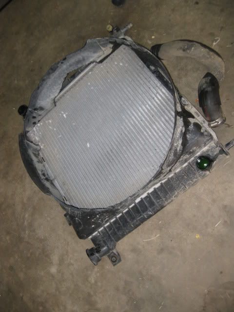

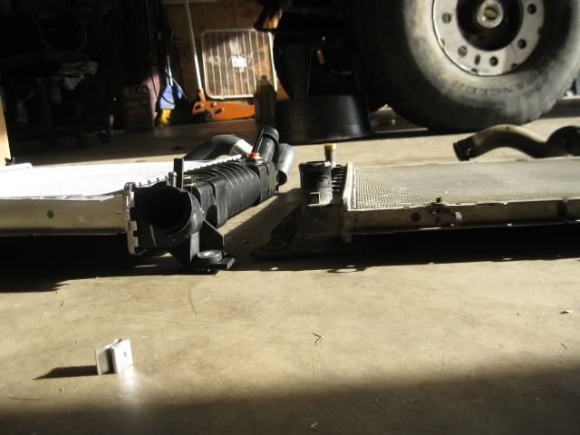

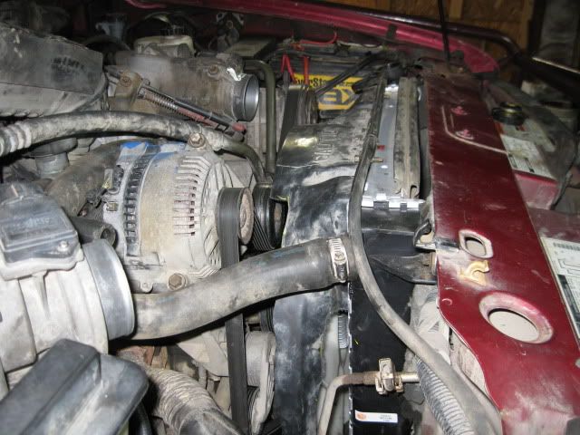

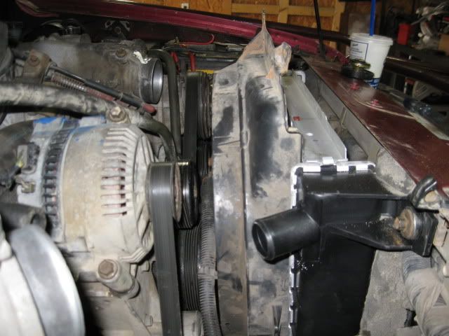

Part of this swap was pretty straight forward. The new radiator is on the Right, the old one on the left (note: you need a different lower radiator hose if you’re running a manual). The inside of the radiator didn’t look bad IMO, but it did have some build up in there:
The problem is here, the new radiator in addition to being thicker, also stands off from the body further than the old one:
Which puts it closer (but not too close) to the fan. This is good as it seems to make the fan clutch lock up sooner:

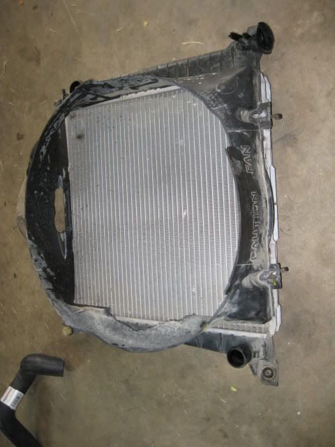

As a quick side note, you can’t really fit a Taurus fan in between the motor and the radiator with the Explorer radiator in the Ranger. The fan is hitting the Taurus fan is hitting the water pump in this photo:
In the end, I wound up hacking on the stock 4.0 fan shroud quite a bit to make it work. I don’t think that even the Explorer fan shroud would work in this application, so you’re pretty much left to make up your own fan shroud, or hack up your original 4.0 shroud.
In the end it worked out:
We took it on a bit of a road trip today (next post down) and it did very well keeping everything cool. I hope that my running hot issues are solved at this point.

I just did the same thing with mine. Still haven't gotten to test drive it to far..
I've only got about 120 miles of mixed driving on mine so far, but the initial results give me the warm fuzzies that the cooling problem has been resolved.
Your post did answer the question as to why the standoff is so much differnt between the radiators. I didn't realize that the exploreres had the condensor attached to the radiator.
Hmmm, I may look into this for the Ex. It gets warm when powering uphill. In crawl mode it's fine, but under pretty heavy power, it warms up pretty quick

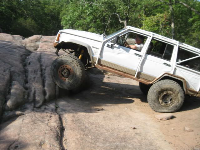

I adjusted my front shackles some, so I flexed it out to see where things are sitting. It looks like I need to adjust my front straps so that I can take advantage of some extra droop:

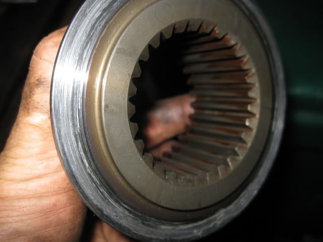

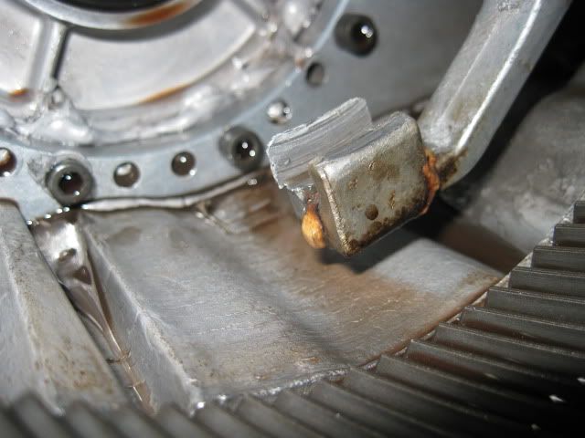

At the end of the day as we were airing up, my buddy commented that the ranger was leaking more than normal. Turns out the damn transfer case decided to loosen up from the crawl box once again. We were ‘just’ outside of AAA towing range for me, and I couldn’t find anyone with a trailer to come get the truck (I don’t like leaving vehicles down at that park). So we ratchet strapped it back together and see how far we’d get:
Turns out, I made it all the way home (over 100 miles), though the last few miles I was definitely limping it as the plastic shift fork pads were gone so it wanted to pop out of gear.
The damage isn’t too bad, wasted the shift fork:
And the Range Hub got chewed on a bit as well:
Anyone got some 1354 parts laying around they want to sell cheap?
I “think” what is happening is that the ford factory tranny mount just isn’t doing a good job of keeping everything in place, coupled with the fact that I can destroy motor mounts at will this setup, is allowing the transfer case to beat itself to death against the cab floor (even though I’ve got over 1” of clearance). This beating is causing everything to loosen up.
I’ve got a poly mount for the tranny, but it looks like I need to also do the motor mounts at the same time. I’ve got the Ruff Stuff mounts, I’ve just been putting off doing them as they look like a pain in the ass to get in there. Guess its time to buck up and get it done.
The only other causality was a rear U joint, but I didn’t find that one until I got home and pulled everything apart (no vibes going down the road oddly enough).
I am also going to bite the bullet here and regear while I have everything apart (4.88’s). I’m hoping this will help keep the drive line from ripping everything apart as well as help move the truck around a bit better than it does right now. With my new cooling setup, the fan will actually engage on these really warm days when going down the road, and it SUCKS the power down hard core.

Hey Ben, I think I might be able to help you out once again. I've got my 54 from my Trac, and i also have a 4405, which is basically a 54 with a clutch front output (torque on demand) we can pull apart for parts. They are both electric cases, but i can pull em apart to verify they have the pieces you need...
SVT
SVT
Sure, zip them apart and let me know, otherwise It looks like Ebay has the parts I need.
Thanks!
