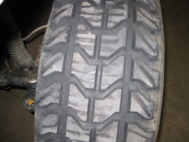

They aren't the most awesome thing offroad, but siped and aired down to 8-10psi they work well enough. No issues with sidewall strength, but they did start to chunk a bit after I siped them.
In the dry, they hook up without complaint, if things are a bit wet, I might have to work a bit harder, but I can still get to where I’m trying to go. I don’t really play in the mud but the little bit that I’ve wandered into, the tires seemed to clean out pretty well.
The biggest complaints I have with the tires is how much they squat as they air down, and side bite (Being able to climb with the sidewall). I know they're not a bias ply, but I was disappointed at how much ground clearance I lost when aired down (my heavy truck didn't help with things I'm sure). I am still farting around to try to find the ideal pressure to run the things at where I’ll still get a decent bite without losing too much ground clearance (Edit- I run them at 12-15 PSI depending on the terrain).. As for the side bite, the Nittos probably just spoiled me with those huge lugs hanging off the side, they made getting out of 'ruts' easy.

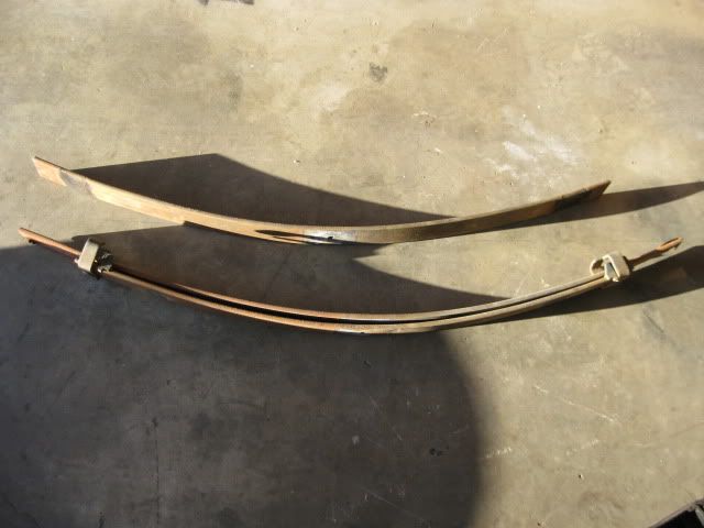

In an effort to try to get rid of some of the vibes I’ve been dealing with, and to get the truck to sit level again, I hacked up another set of chevy leaves to wrap up my bastard pack. In the past, I had already added an AAL ”Boosting the Rear” (Link), but it wasn’t quite enough.
So I took the stock pack that looked like this:
The Lone Ranger – Kage’s ’94 X-Cab Leaf SAS and Bed Bob
Cut down the second to the top leaf of another chevy pack:
Squeezed it into the leaf pack so that the cut down leaf is not 3rd from the top:
And now the truck sits more level, and actually rides a bit better and still flexes rather well. Unfortunately, it didn’t solve my vibration that I’ve been fighting, so it looks like the next step will be to outboard the shocks. It’ll be pretty dang tight, but I think I can get it done.

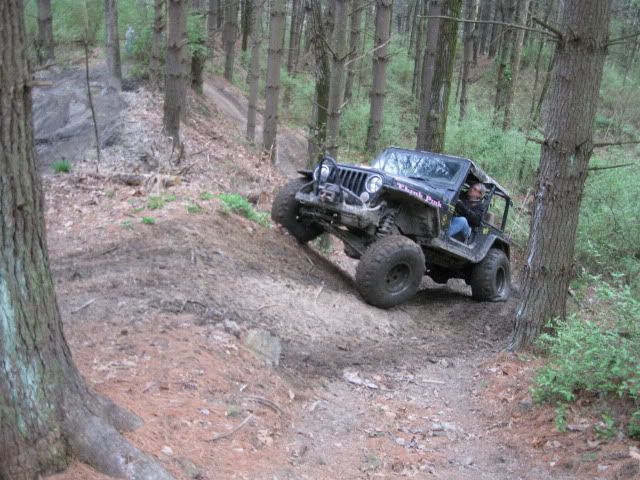

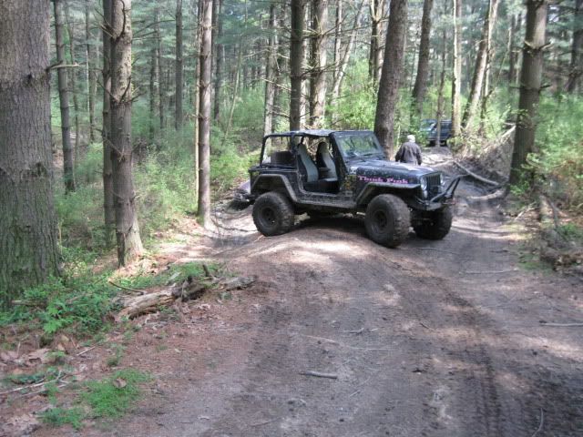

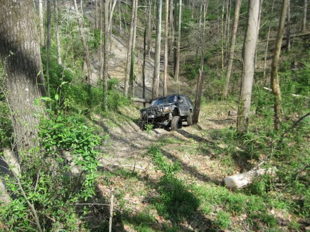

6th Offroad Trip – 3/12/12
There was a pop up run this past Saturday out at Interlake. We didn’t get to wheel all day due to an early breakdown (at a gas station parking lot no less) when the 1 ton XJ managed to snap a ptiman arm. Even with the delay, we covered nearly 10 miles (including the new trail 19). The park continues to improve every time I go out there with signage and such. We were surprised at how dry it was out there as well, since the Greater St. Louis area has been getting hammered with rain the past week
Not to many photos, but here’s what I’ve go :
(Link to all the photos)

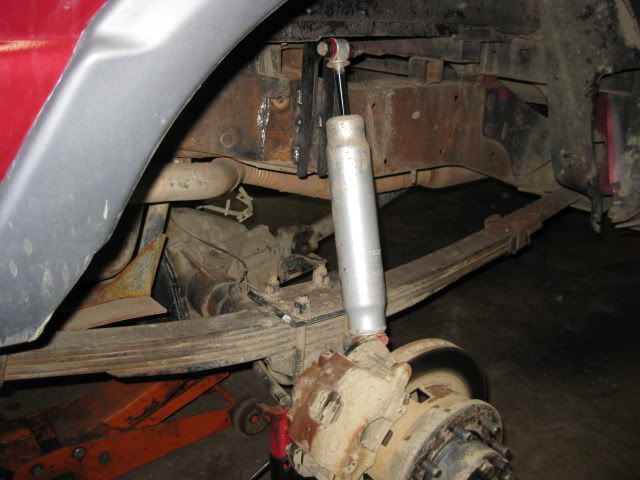

Out boarding the Rear Shocks:
In the quest for better road manners, I went ahead and moved the rear shocks out as much as I could. The end result is a more stable ride, that didn’t limit the rear flex that much (who needs flex when you’ve got lockers anyway :icon_twisted:). Unfortunately, it still didn’t cure my wheel vibe, but it did help calm it down quite a bit.
I went from my original setup:
To something like this:
But that wound up limiting my travel too much, so I laid the shock over a bit more and ran it like this:

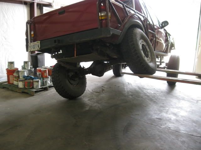

This meant I only lost about 1” of travel in the rear compared to the way it was setup before:
Compressed:
Extended:
I still need to slap some limit straps on it to help save the shocks, otherwise its done. I’m pretty happy with how it turned out, and I’m looking forward to trying it out on the next trip out (should be 4/21/12).
