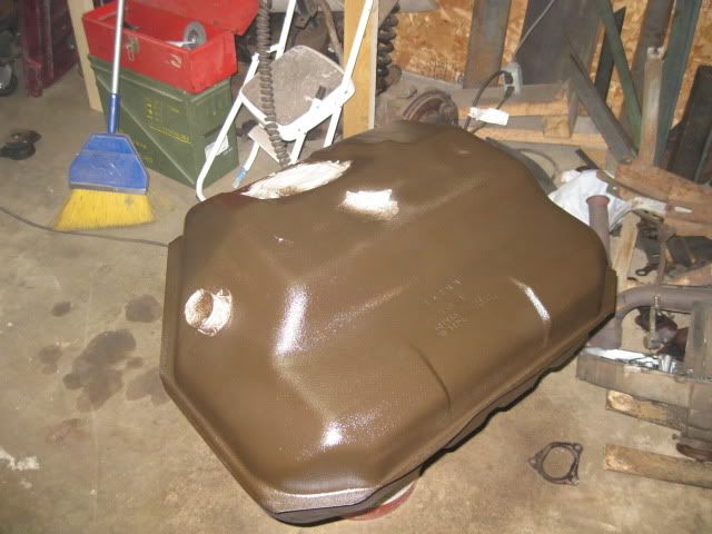

I picked up a tank from Rock Auto for a fuel injected Bronco II. Fed-Ex beat the snot out of the thing before I got it, but it still showed up at my door pretty quickly.
I cleaned up the tank some and threw some rubberized undercoating on it:

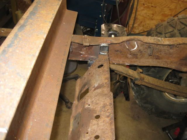

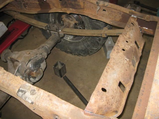

After grinding off the rivets on the rear cross member, I then cut some slots in it for the fuel tank straps. I also took a guess at its mounting location:
The Lone Ranger – Kage’s ’94 X-Cab Leaf SAS and Bed Bob

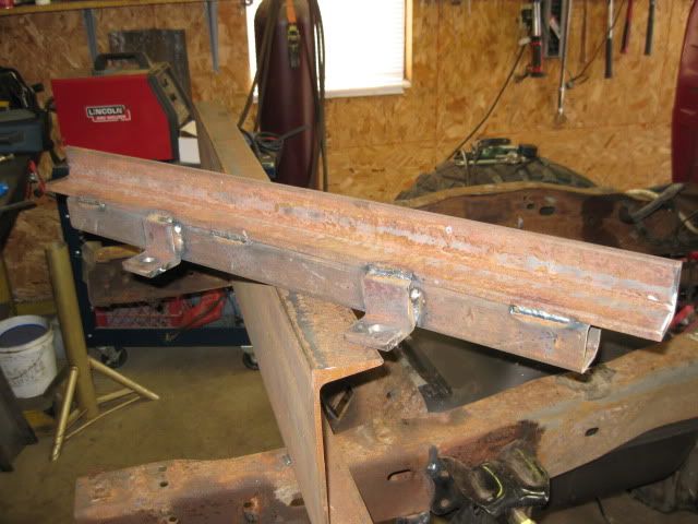

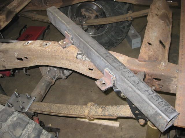

Threw together a quick front support:

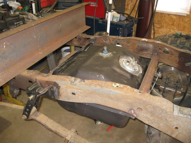

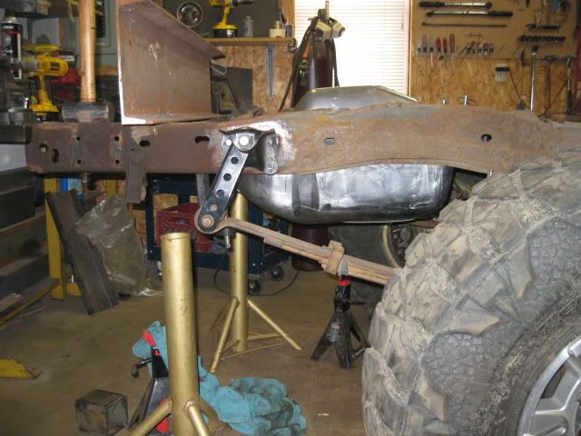

And stuck the tank in:
I liked how high up the tank was sitting, unfortunately, it was going to cause me some bed issues with the minimal body lift that I’m running. If one were to run a 3” body lift, this wouldn’t be an issue.

Whipped up another support for the front:

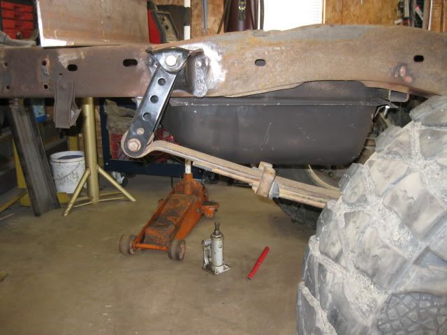

And put the tank in its home:
With the tank lowered to its final height, I shouldn’t have any bed clearance issues, and my tank is still tucked up fairly high. Or at least, its not hanging any lower than it did on my Cherokee. From the lower horizontal surface (on the left hand side of the photo), the tank hangs down approximately 8”

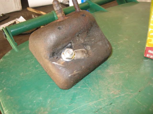

I picked this trick up somewhere, but I cannot find the original thread that I saw it in. In a nutshell, I wanted a cheap/quick way to firm up the stock mounts, and help give them a chance to survive the extra forces they’ll see form the doubler. If these wind up not working out for me, I’ll swap them out with the Ruff Stuff Mounts that I have sitting here. I’m just tired of the detail work right now, and was looking for a quick project to check off the list.
So, take your stock motor mount (mine were still tight, so I didn’t buy new ones):
Take and angle grinder to the rivet head, push the rivet remains out of their home, and slap a 3/8” bolt in its place.
Once the bolt is in place, snug it up some and either weld/secure the nut to the bolt to keep them from loosening up. The goal here is to make it a “tighter” mount than what it was with just the rivet in there. I could move my stock rivets around a good 1/32 – 1/16” when playing around with them.
EDIT:
Yeah that didn't pan out. The tired 4.0 (in 2 high never the less) managed to start pulling the bolt throught the mount, so I had to swap them out for some stock mounts. My hope is that the stock rivet has enough surface area to keep it all together as opposed to the smaller (weaker?) bolt/washer combo I had.
