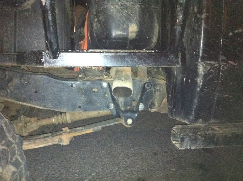

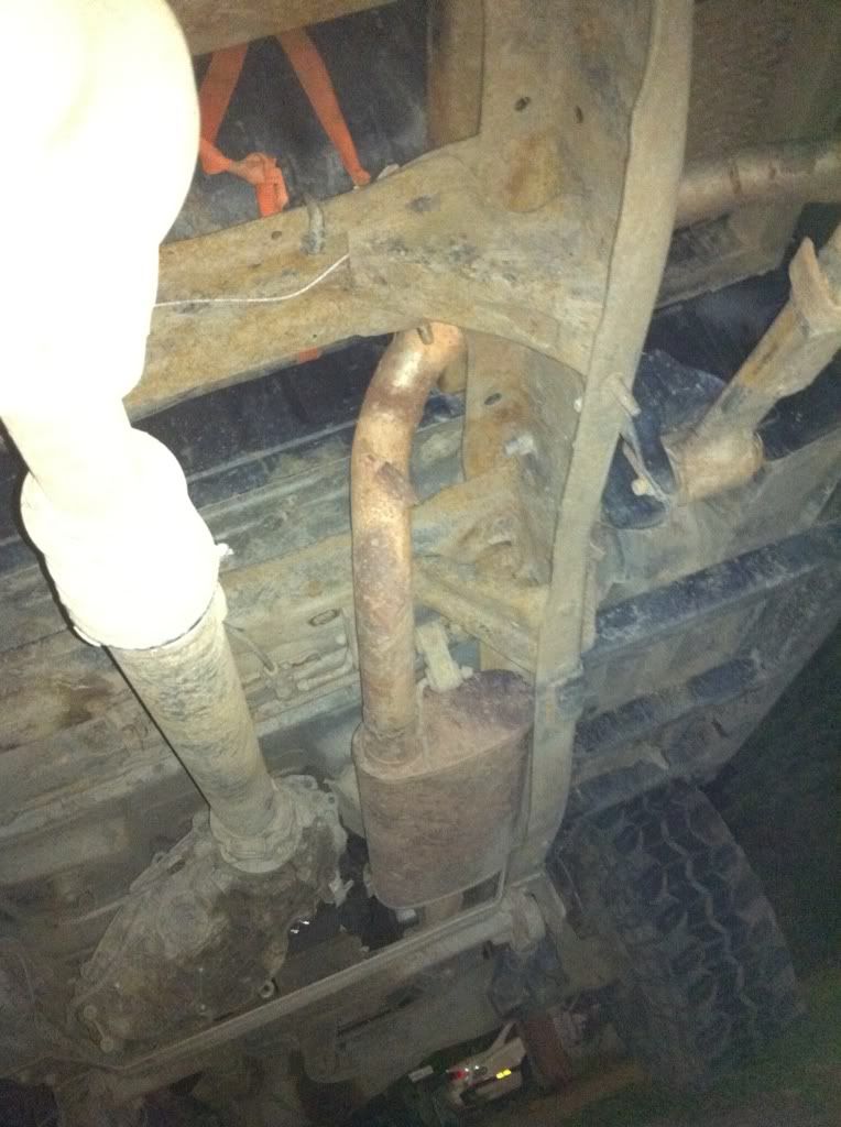

here's those pictures you wanted....

here's what it was with the bed on.

thought i had some better pictures but cant seem to find them

here's those pictures you wanted...thought i had some better pictures but cant seem to find them
Thank you very much! And man, that's a tight fit in there!
Did you ever have any problems with the paint trying to burn around where the exhaust went through the bed?

its deffinantly tight in there...
from the lower body line down i had the truck bed liner which i never had any problems...never a bubble or flaking around it
