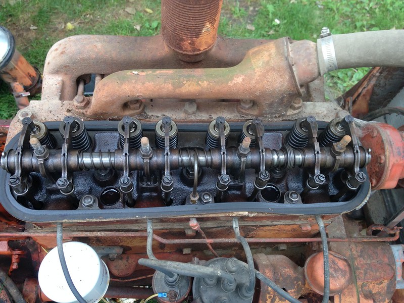

I was amazed when I ripped a valve cover off my 2.8 and saw the valvetrain. It is literally 1930's tractor tech... done stupider

Lookie here, Engine was designed for the late 30's Allis Chalmers WC. With some tweaks for more power this one is in a 1950 WD. Straight levers for even load, huge bearing surfaces to keep things stable. It is almost 70 years old and is in the #2 horse on my acreage... and still runs like a swiss sewing machine. All four of my tractors ranging from 1946 to 1953 use this setup.

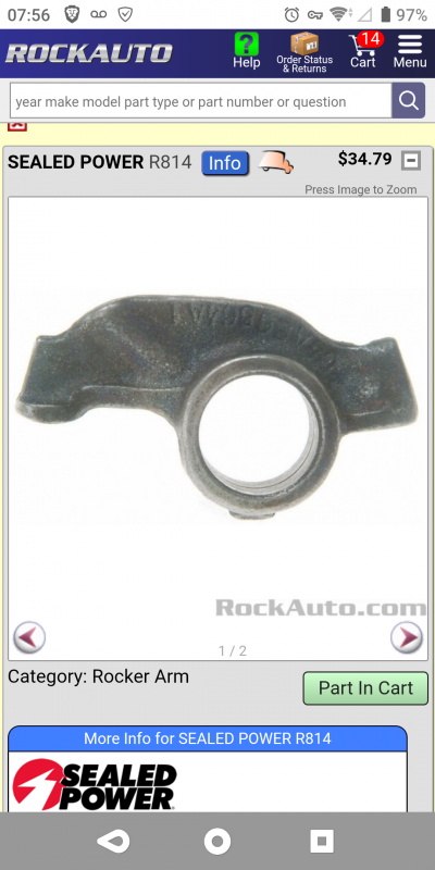

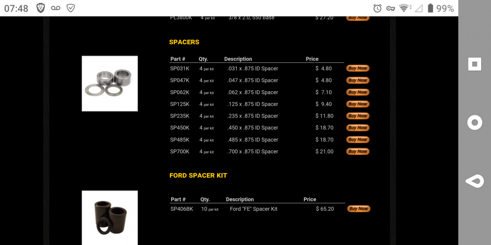

Another random thought... Seems that the FE engine guys have a ton of parts available for stuff like this.
I may actually take the plunge and buy a single 427/428 rocker arm and take some measurements. There are TONS of shaft mount roller rocker kits out there for them. If they're "close enough," I'm guessing we could have them modified for 2.8/2.9/4.0 purposes.
Alternatively, anyone out there with a few FE rocker arms laying around they can spec?
