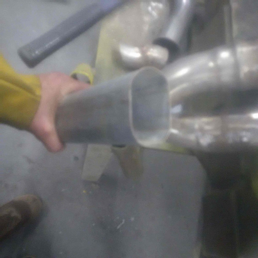

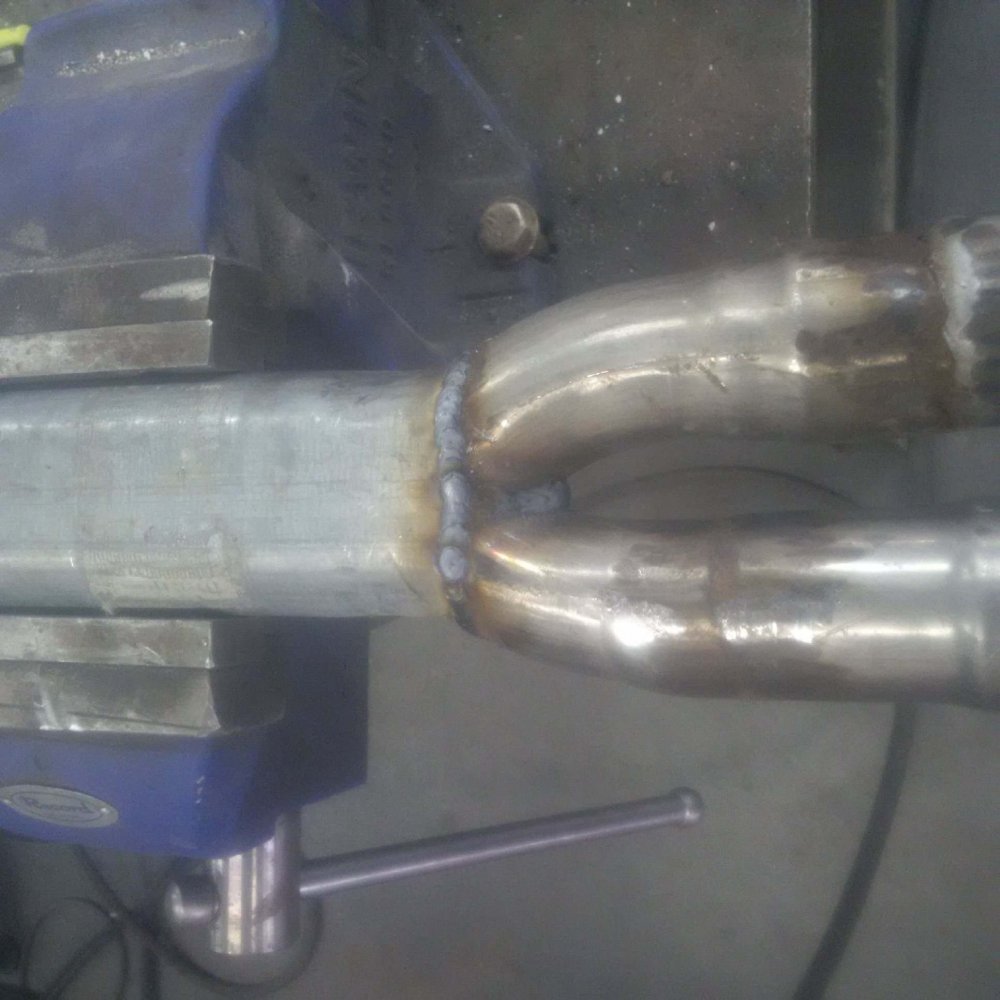

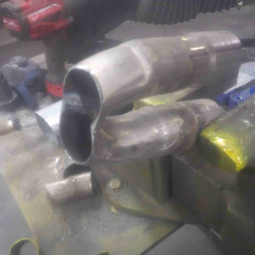

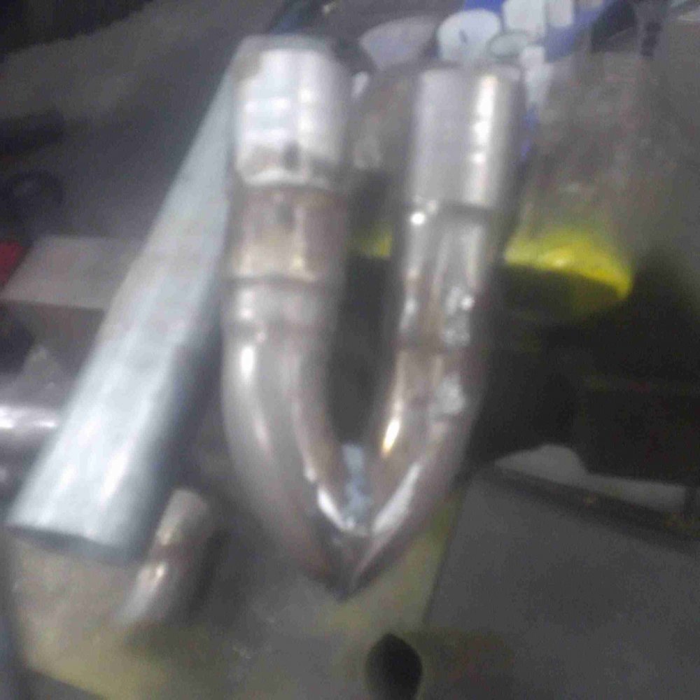

The Y pipe build.
Bend two pieces of pipe and weld them together.
35262
Cut the end off
35263
Get a piece of flat 2 1/2" exh pipe from the race car pile.
35264
Weld it up, voila, a Y pipe that flows well.
35265

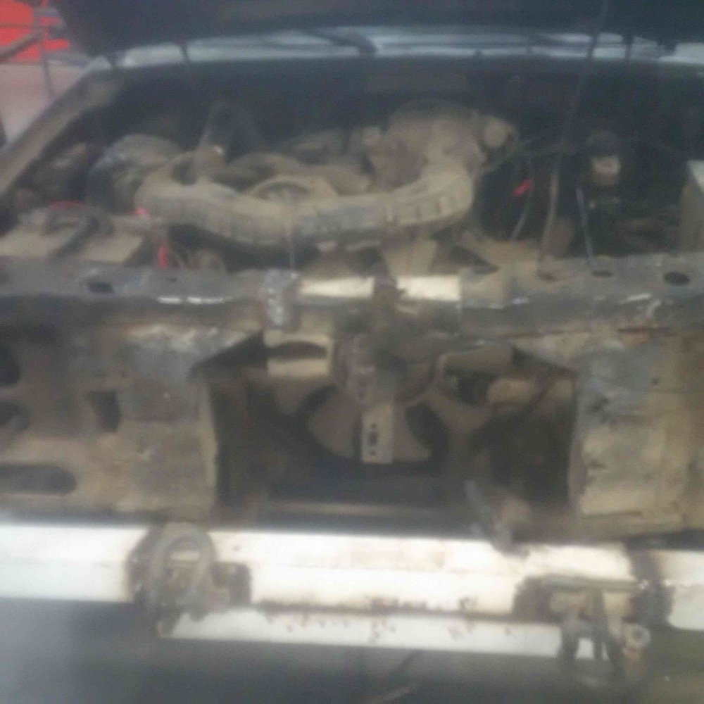

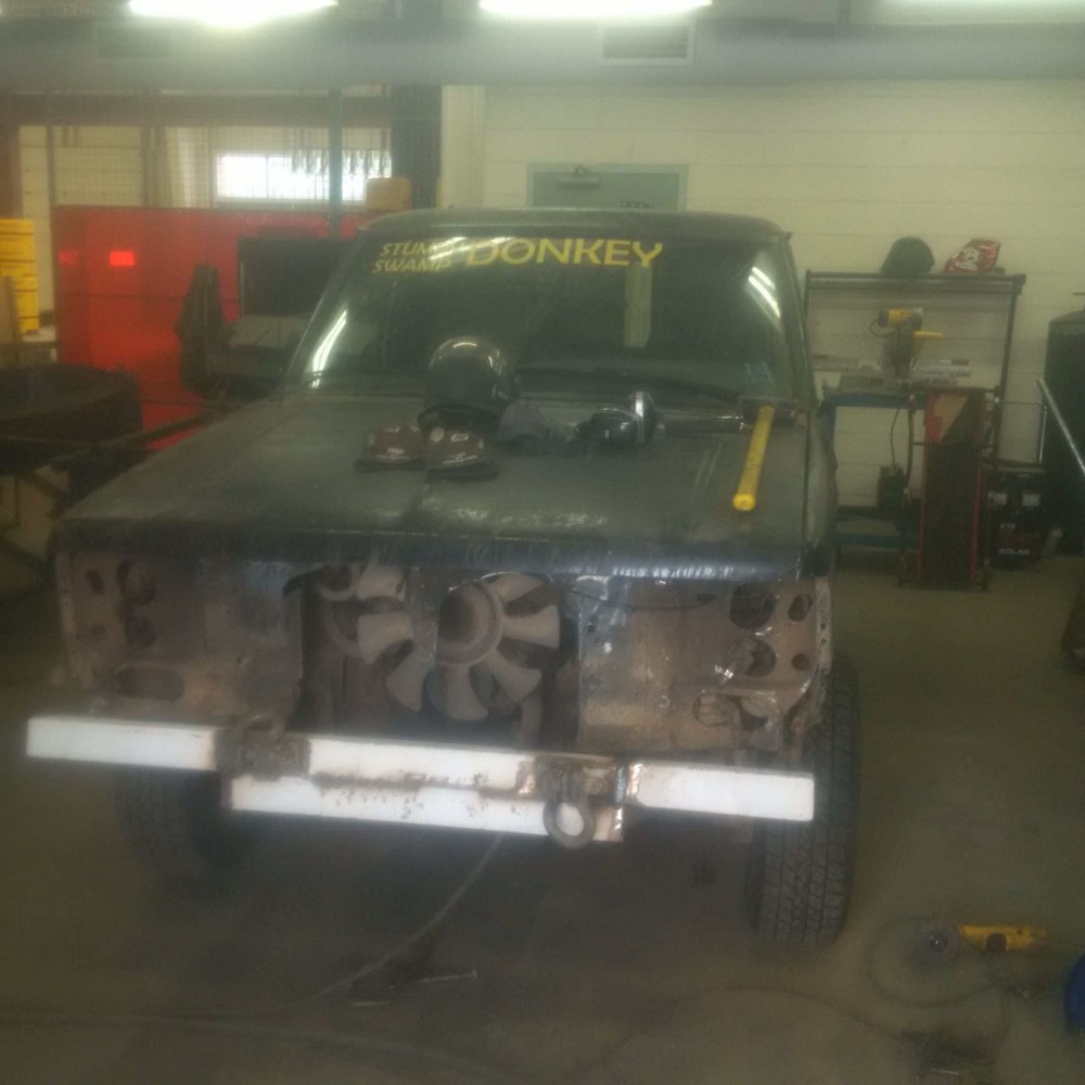

Well I've been working on the donkey at dinner time and got some progress to show. I tore everything I could off the front and cut the rad support so I could pull/bend the drivers fender back to its original position...ish. Then made a new body mount, bolted it down and proceeded to bend/kick/sledgehammer the rad support back across the front of the vehicle instead of sticking straight out the front. Once that was bent back and then somewhat levelled I welded the two pieces of the support back together. The bottom of the support where the rad "plugs in" was tore all apart and I'll have to make another whenever I get a rad. The hood was too high on the passenger side because not only was the support bent side to side, it was also twisted. So I got the support back together but it was still trapezoidal instead of square. So, out came the trusty sledgehammer and beat it into submission. Now, the hood clicks down better and fits tighter now than before the accident! Siliconed the windshield back in, removed all the glass from...well...EVERYWHERE.

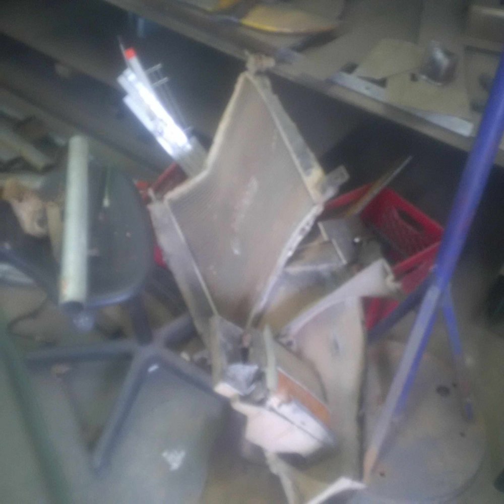

Here's the rad and spare parts...
35526
Front end with bumper extensions from the frame,
35527
Down the drivers side,
35528
The beat-into-submission rad support,
35529

Well I got the explorer rad to fit, I had to cut off the sway bar though because the bottom rad hose is right in line with it. I figured I don't need a sway bar at 20mph and without it I'll have better articulation. Chopped away at the rad support a bit more and used a piece of exhaust tubing to extend the top rad hose as it was too short. Oh, and the top rad hose is not square to the rad, it angles off to the passenger side...right into the battery tray. Cut off disc trimmed a couple inches so that's all good. Building a lower rad support now and when done the rad will sit in it and the two bolts at the top will only keep the rad from flopping around and not support the weight of the rad. (like factory)

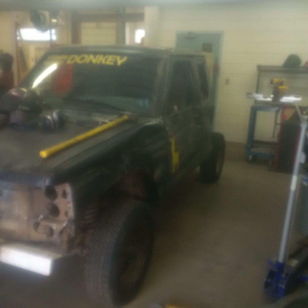

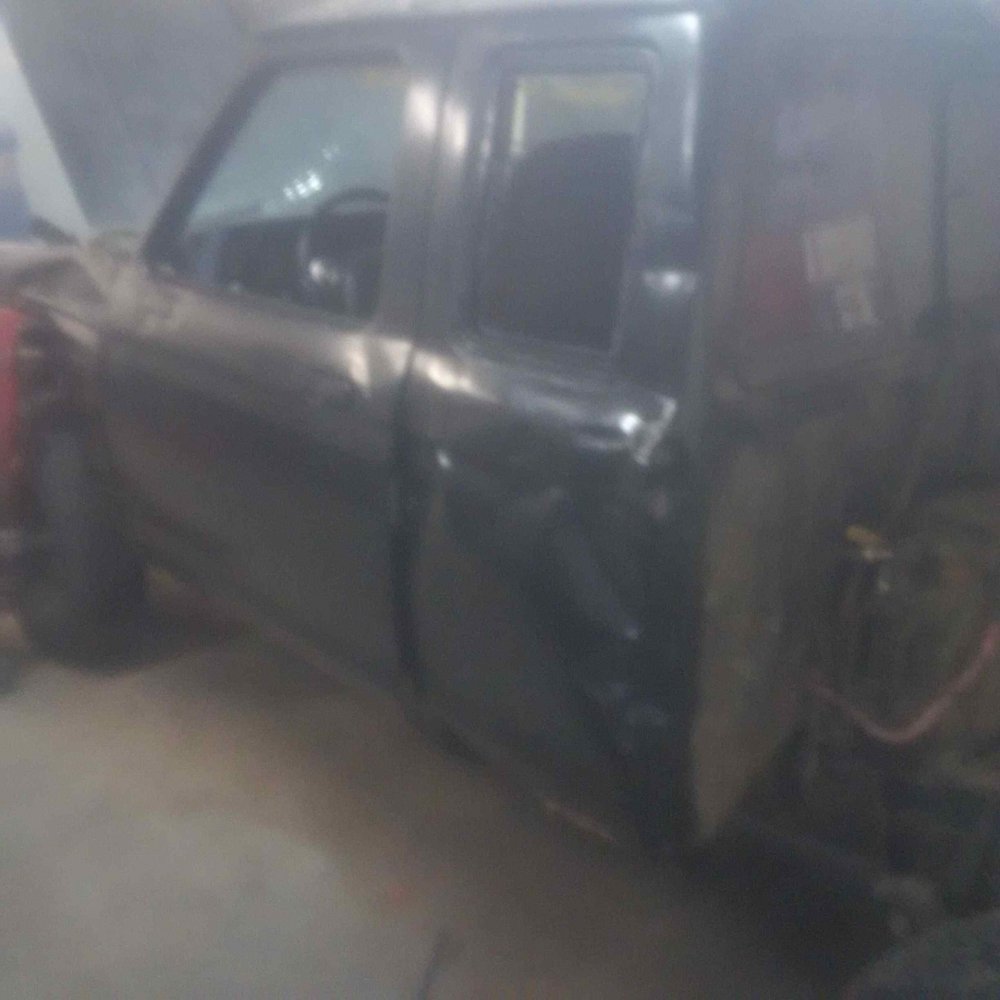

Got a door from the junk yard for $50 and did some head scratching, the side is still caved in way more than I thought. Anyway, used the sawz all to cut away some interior panels so I could get the frame straightener in. Did some more pushing and hammering and got the B pillar when it should be (ish) but the latch pin was all messed up. So, replaced the pin with a metric bolt and adjusted everything (with the maul) to fit. It now closes like new, gentle push and click, its closed! Still looks like crap because I couldn't push the rear panel out anymore but it works!
Here's the new door (painted with black tremclad rust paint)
36237
Just have to put the new "Donkey" decal on.

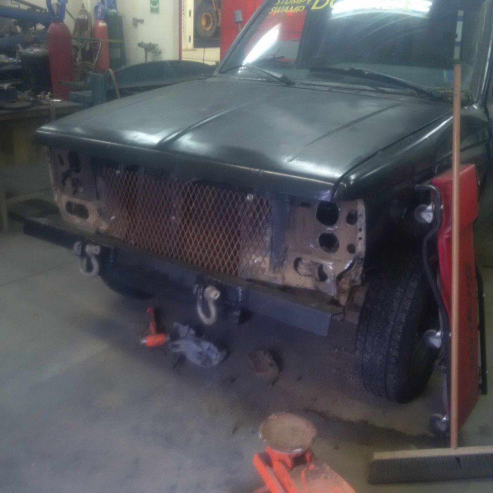

And since I'm posting pictures from my potato...here's one of the front end. just need to finish the rad support, add the expanded metal in front and then start into bending tubing for the push bars.
36238
Holy crap these pictures are horrendous....I need a camera or something.

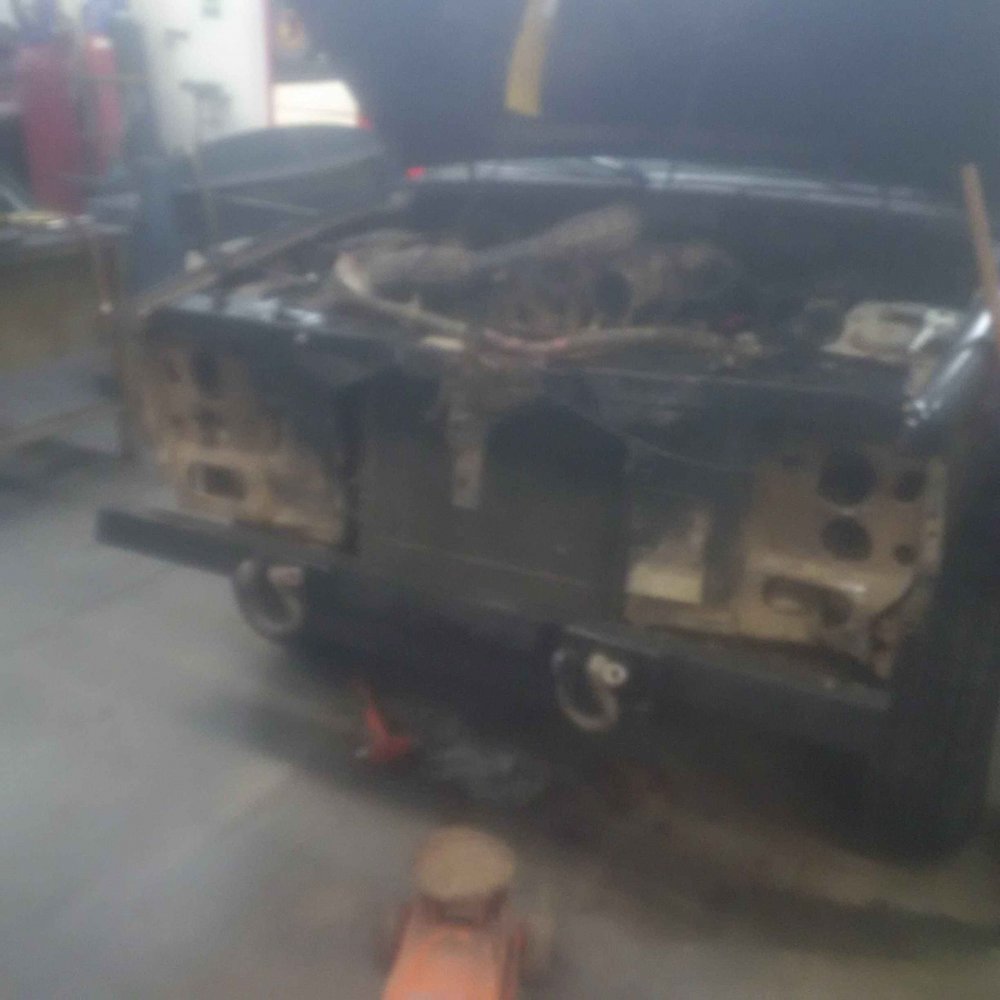

Wanted to get some work done today but that went sideways. Before leaving work lastnight though I welded in the pushbar in front and chopped up some 2" for the sliders. Monday at dinnertime I'll finish cutting that tubing up and start welding.

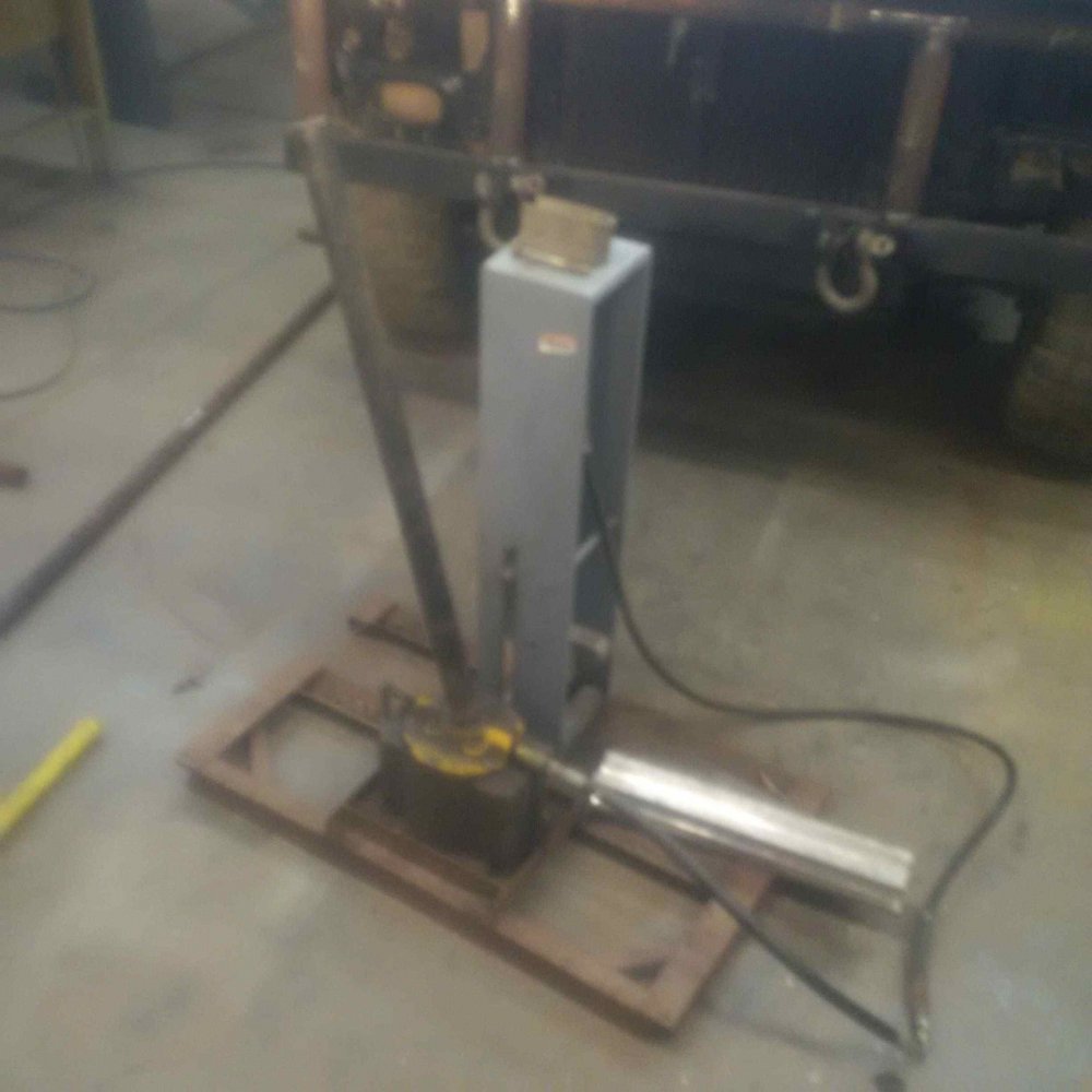

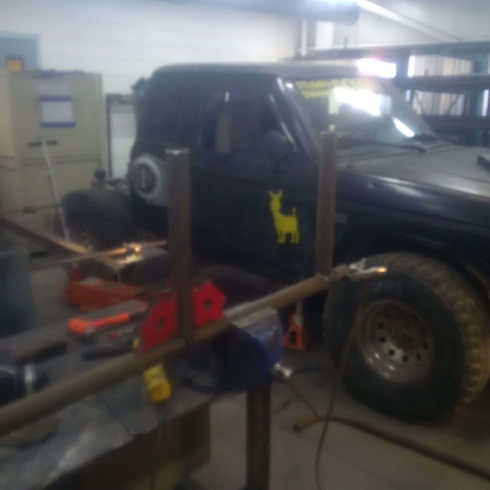

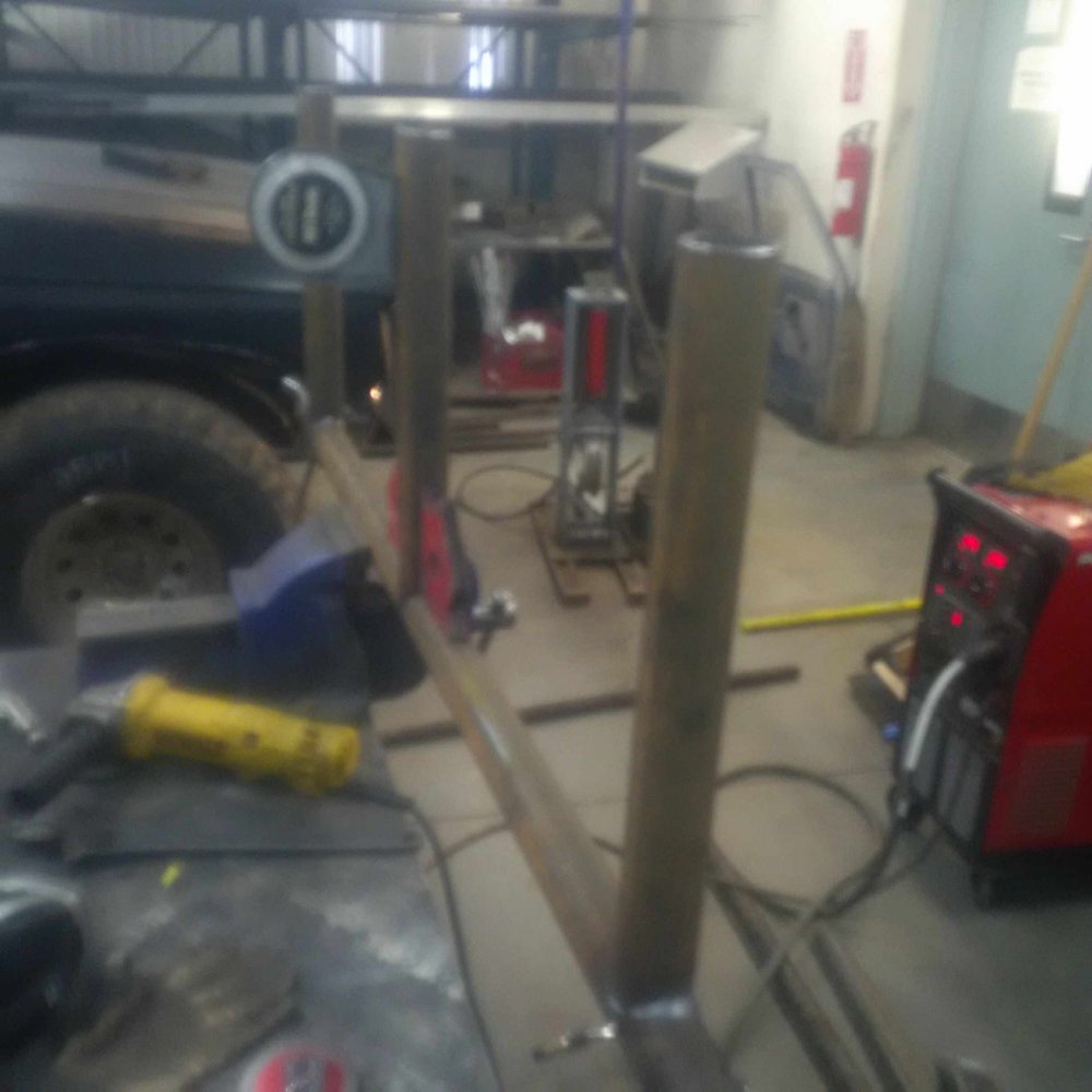

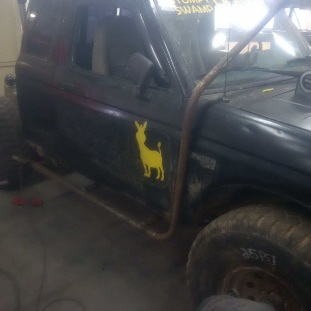

Started the rock sliders using my angle finder and tube bender;
36753
36754
36755
Just realised my camera was dirty...AGAIN!
I'll go take a new picture of the slider mounted and the first tube I started bending for the A pillar.
Be right back.

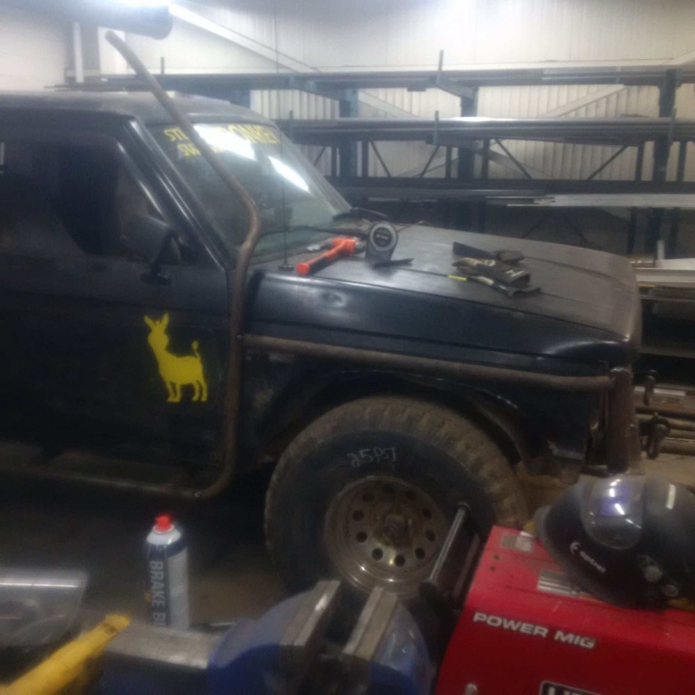

Got the A pillar bar laid back and put the fender guard on. I'll trim all the fender below the bar and I think I'll add some metal on top from the fender down to the bar...
36804
Did I mention compound bends are a bitch? Lol!
