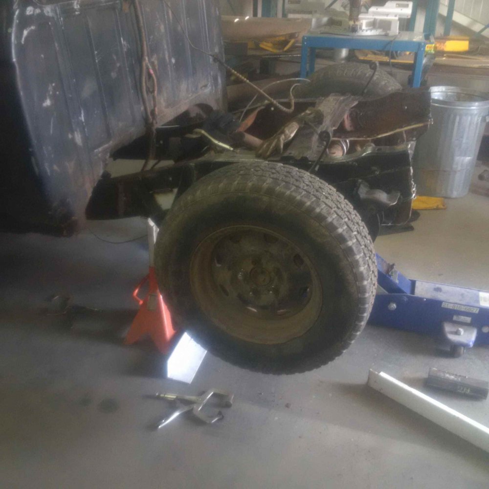

So, I finally got a bit more work done on the donkey. My day job is too frigging busy!! Can't wait to retire next summer, but, I digress....

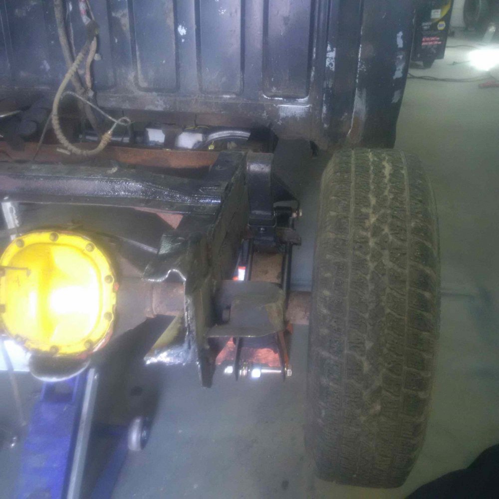

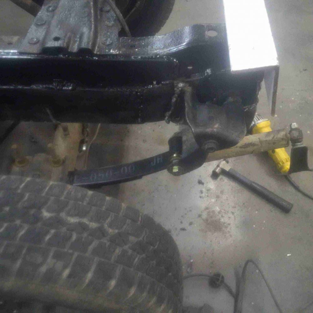

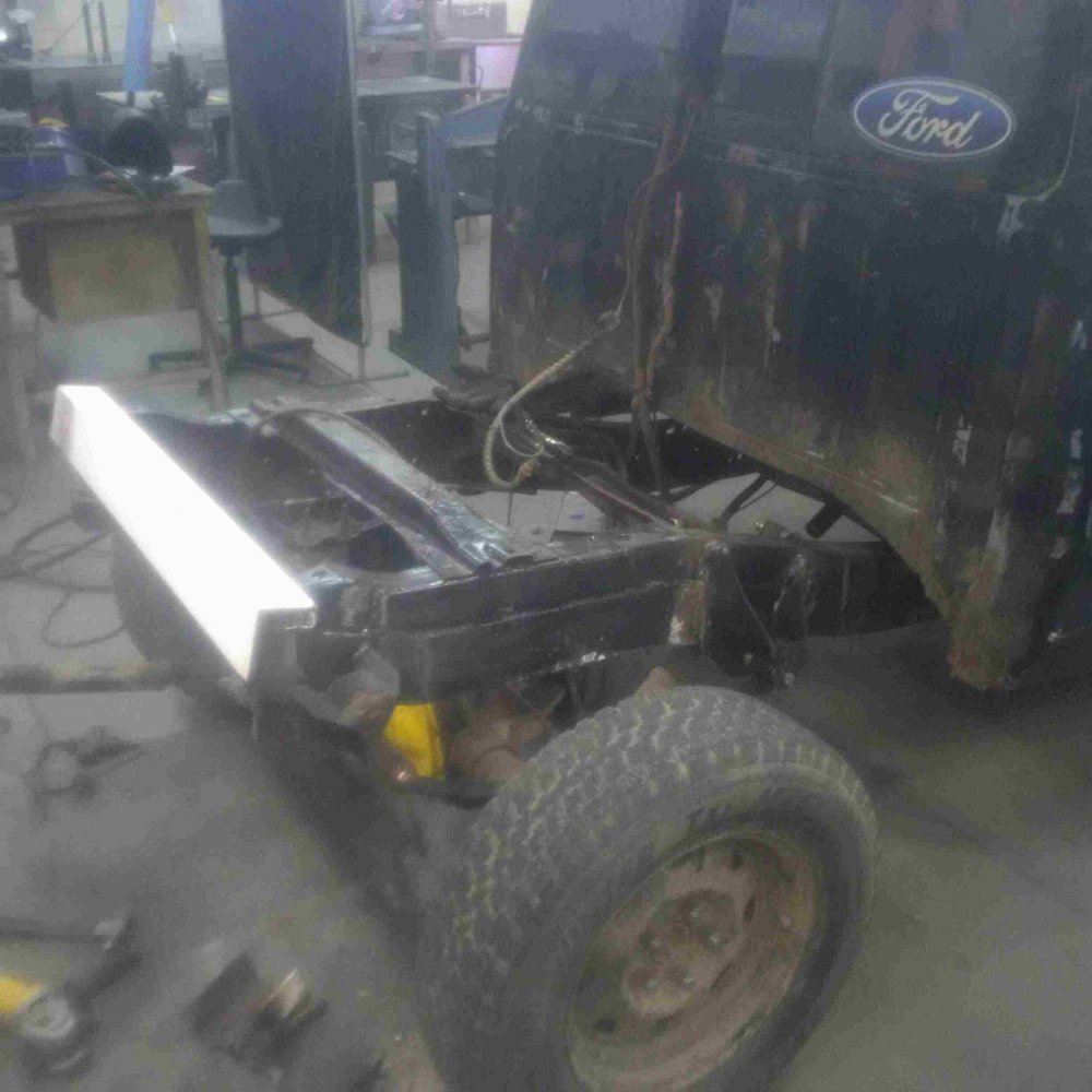

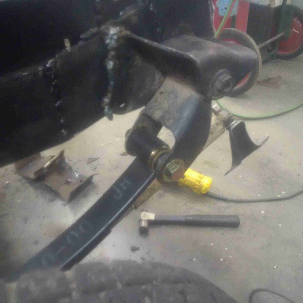

I didn't like the springs I cut down so I bought a set of 1500# trailer springs, that would be 3000# total for the rear...umm, yeah, way too stiff. So, down the road I'll pull a leaf out to soften them up. The main reason was the shorter length, they are 26" long and by welding the spring hanger tilted, I can get the spring up past it when I pull the bolt. The suspension goes up about 13" so once I figure the limit required I'll put in a stop.
And yes, the white piece of angle iron is just laying across the back.
Anyway, here's a few more pictures of next level hackery, lol.

And yes, I welded the hangers on, I just had shoulder surgery and am not going to try and drill holes in the frame...course I'm not supposed to be doing any of this after shoulder surgery...hmmm... LOL!
Those welds look a little scary. After you heal up I'd put some bolts in there!
Also why didn't you leave some room for axle droop? The shackles are at full extension.
Actually they can move a tiny bit but right now there is zero weight on the rear end, its just bare frame I can almost pick up myself. This is the "most upright" it will be, when I put the box back on and add a winch etc it will drop down. Yeah the welds are boogers which look like crap but I did make 2-3 passes so what you see is the gobs on top. While I used to weld a lot (roll cages/etc) and had my stuff certified by nhra, in recent years I've found that I need to take my glasses off to see the welding properly. So if I weld up close and then 2ft away...anyway, they're boogers but they'll hold for now. Last night I welded on the shock mounts and then cut the driveshaft. Clean it up at dinner time today and hopefully take my time and weld it properly lol.

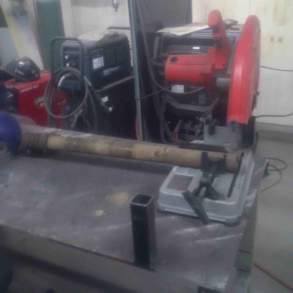

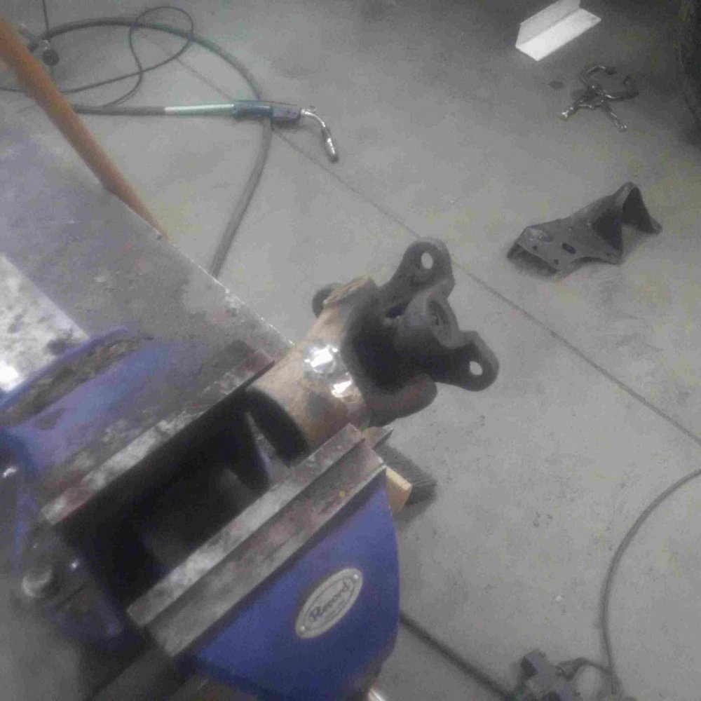

1) Cutting the driveshaft

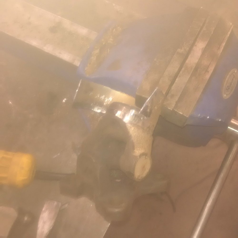

2) Grinding down the weld

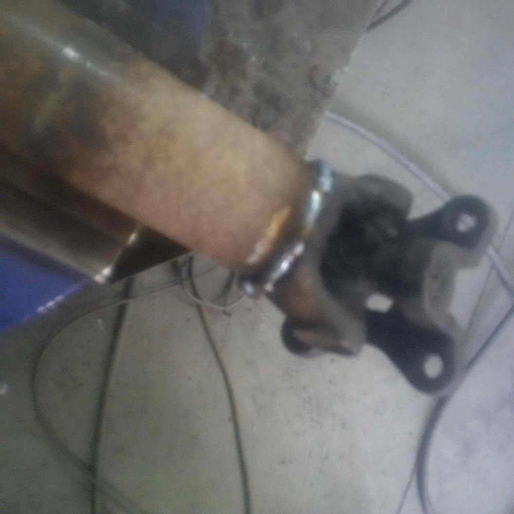

3) peeling what's left of the driveshaft tube off the "head".

Also keep in mind that it's locked in 4 low and 99.9% of the time I'm idling along in 1st gear. The trails here are very rocky and even the "swampy" parts still have a rock bottom. When I take it to N.B. there is mud up to the windshield, but other than roasting it in 1st (4000rpm) even there I idle along due to the 3.55 gears. All this to say, if any of the welds break it will never be a "holy shit" moment, just a "oh oh, what was that noise...something dragging/its lower on one side..."

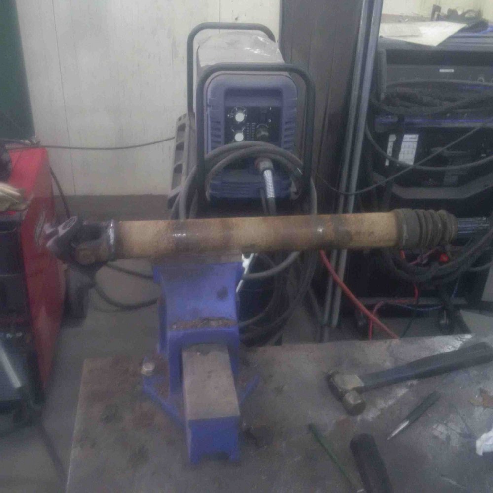

I ground the weld down to see and I do have good penetration, made a second pass on top and built it up. BALANCE?? WE DON'T NEED NO STINKING BALANCE!! Lol.
And the completed shaft;
32745

I don't think much of the angle on your shackle hanger. If the shackle goes too much the wrong way you will bend stuff. Maybe that's what you meant about putting in a stop? Personally I think the hanger should be moved forward an inch or 2. The shackle should be perpendicular to the spring in a neutral position.
Anyway, I'm liking your rebuild mostly.
Its hard taking pictures with a potato....lol. Not my phone, its my work blackberry and pictures was not one of the priorities apparently.
The hanger had to be tilted to clear the spring, but what angle its on, on the frame, is a moot point. The only thing I see is that the shackle has enough room to travel through its arc without bottoming out. Once I pull a leaf or two out and add weight to the backend, the spring will flatten out a bit and the shackle will be more vertical and in the middle of the swing. (perpendicular)
Yes I'm going to put limits on the amount the axle can rise (or ass can drop) Whether that's because the shocks bottom out, the shackle bottoms out or whether the driveshaft doesn't have enough spline left, either way, I will be limiting it before anything can bottom out and bend/break stuff.
