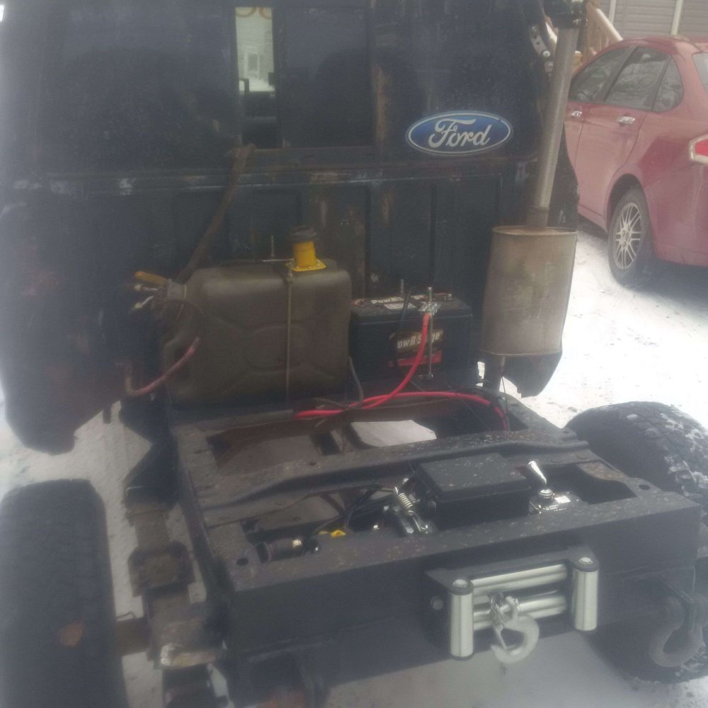

So, no pictures yet but I have the shortened factory leaves on the back, (again) a custom made gas tank (jerry can but retains the factory fuel pump/lines/sending unit/etc) a bunch more welding and cutting on the frame.

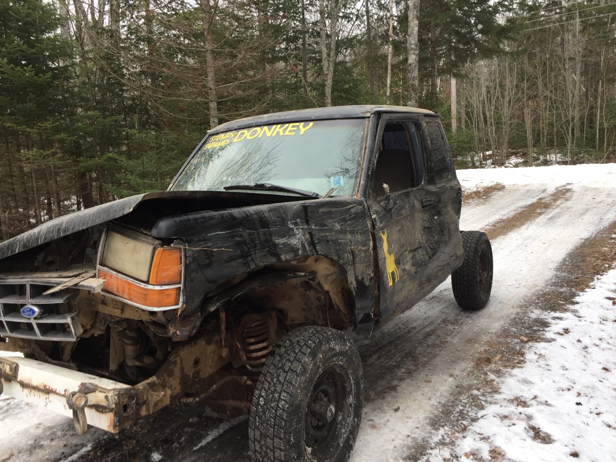

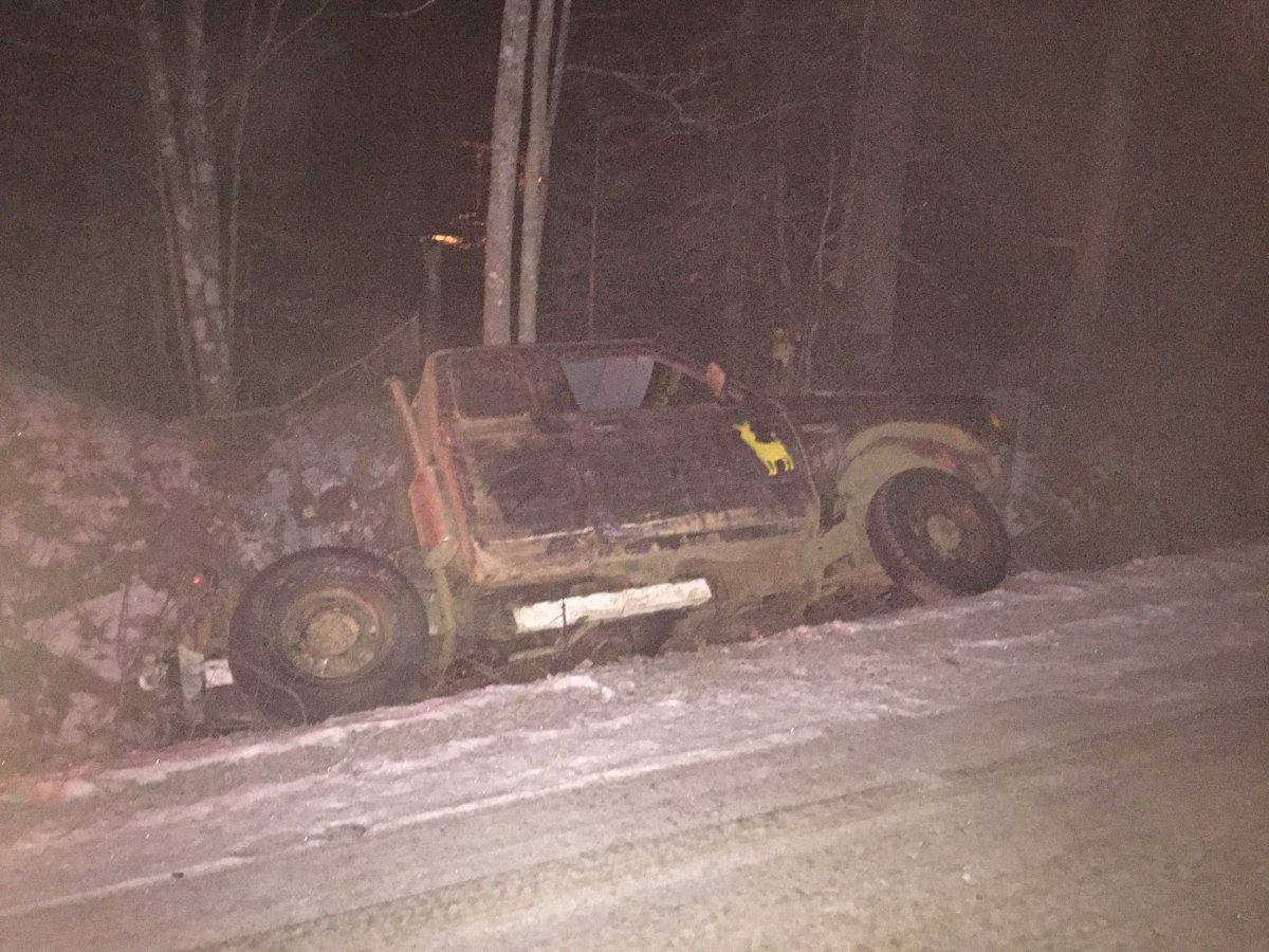

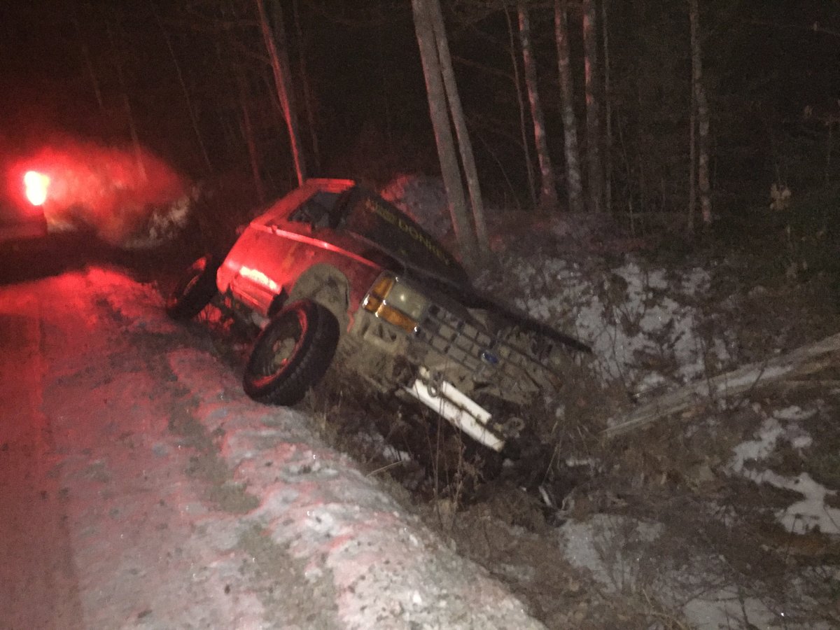

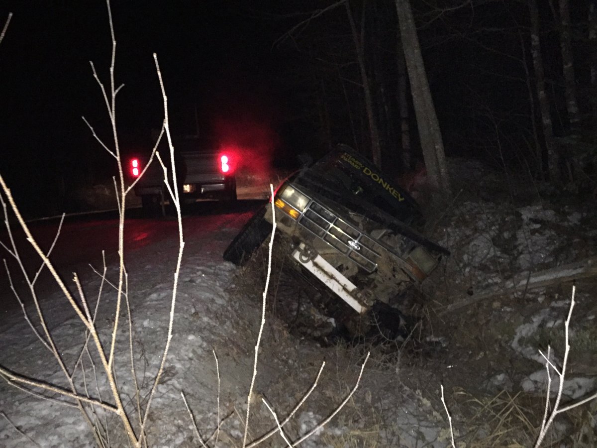

Got the winch mounted, exh done, gas tank filler and vent done, took it home from the shop and went for a drive. 3' of water with 3" of ice on top, chewed it's way through. Went about 23 Kim's on the power line and side by side trails. Was about 2kms from home and I was playing(drifting) on the icy roads. Went around on me and ended on its left side. Mama took out the consol as she landed on me cracking 2 ribs and hurting my shoulder I had surgery on. She smacked her head and got a goose egg. The donkey? Well, the whole drivers side is caved in 6" and broke drivers window and the side glass for the ext cab. Broke the windshield. Tore the exhaust off. Put the drivers headlight a foot higher and a foot closer to the right one. Made the rad a Z. The front left rad support body mount is at least a foot from the frame mount.

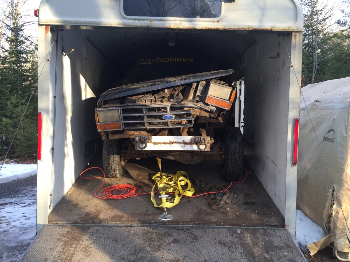

Tried to tow it out with the pick up, not a chance. So I went and got the toy hauler (bus/motor home I use to haul the drag cars) and broke the tow strap. Put a brand new strap on and at first the bus spun, then pull it onto the road. I turned around and the kid fired it up and followed me home. Drove it into the shop today, the rad is a Z and the shroud is jammed into the fan. As long as the clutch fan is cold though, no problem! Lol.

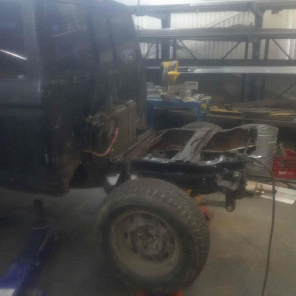

Already started on it, resealed the windshield (only inside pane is cracked, it's good to go lol) Put the porta power frame straightener from the seat bracket on the right, over to the b pillar on the drivers side and 3tons of pressure later, the body is somewhat straight...kinda...sorta...if you squint real hard. Bent the door to fit and straightened out the linkage. Both inner and outer door handles work and the door opens and shuts easily. ( ish )

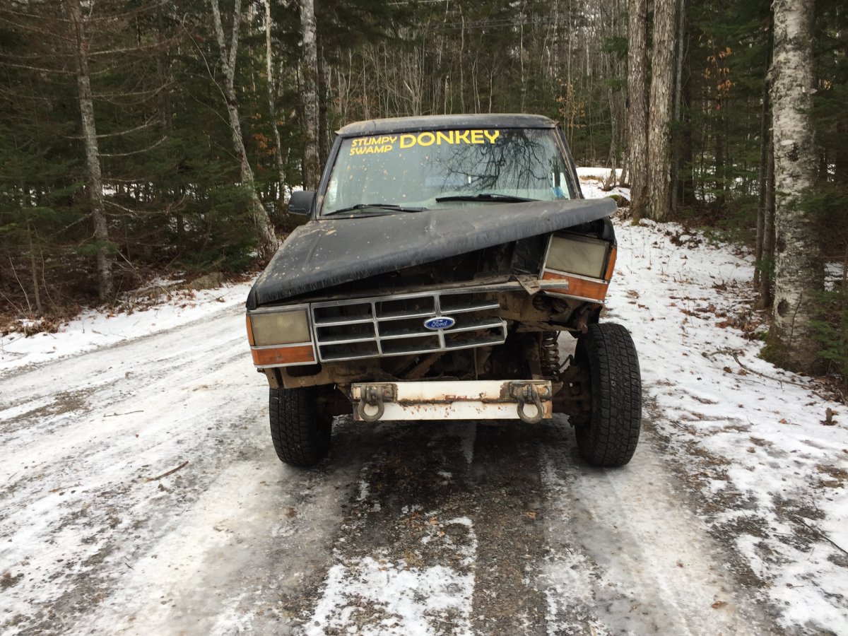

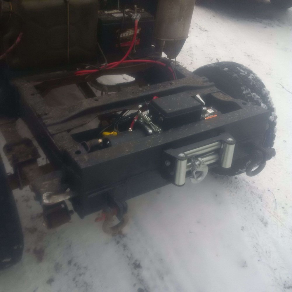

Hey, my other pictures came through too. Here is some before shots.
This is how I mounted the 10,000lb winch and the heavy angle iron braces as well as the 6 1/2 ton tow clevis's.

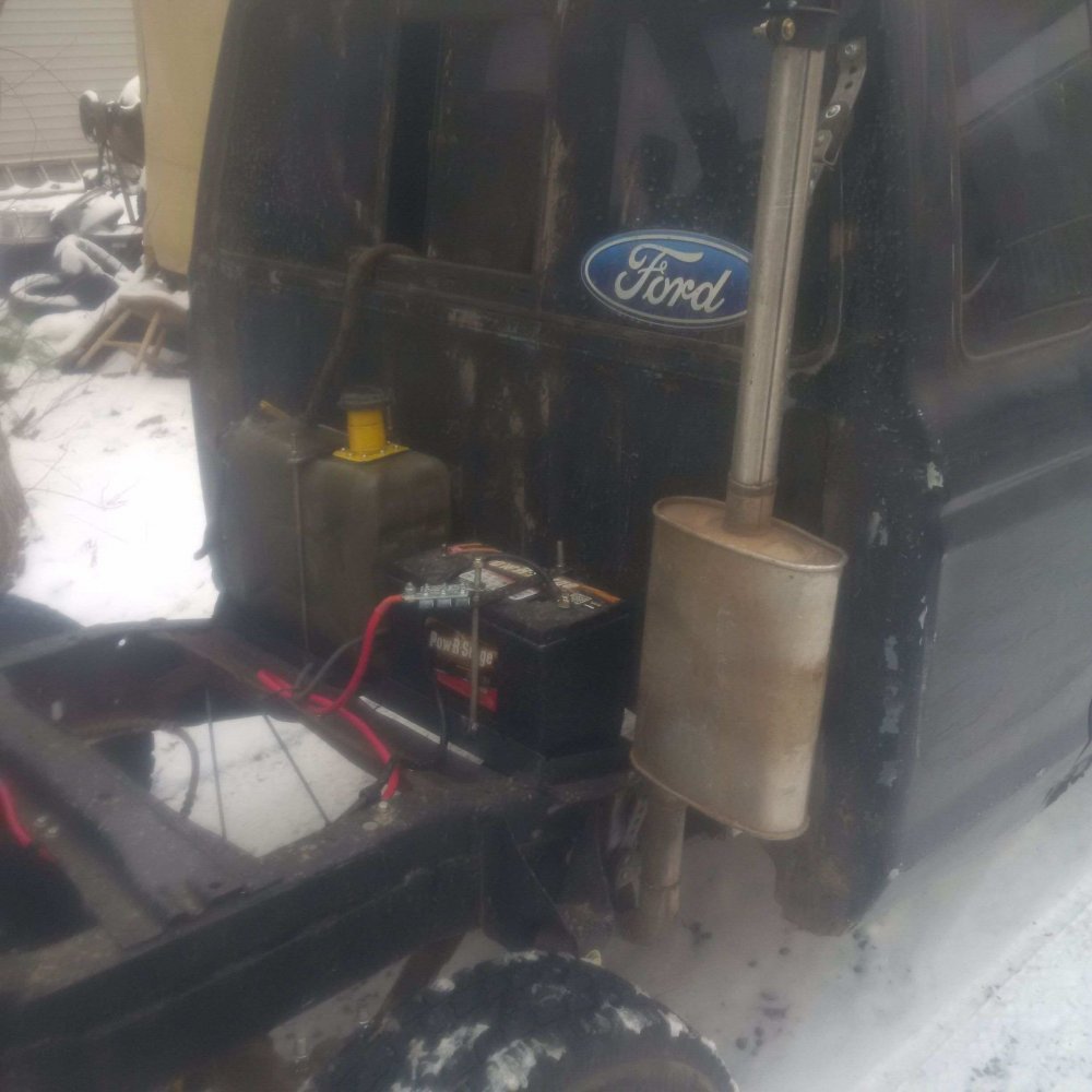

The exh.
Wife didn't like the BRAAAP! When I floored it with the twin stacks and homemade mufflers so I made a y pipe and ran the single dynamax muffler and stack.
