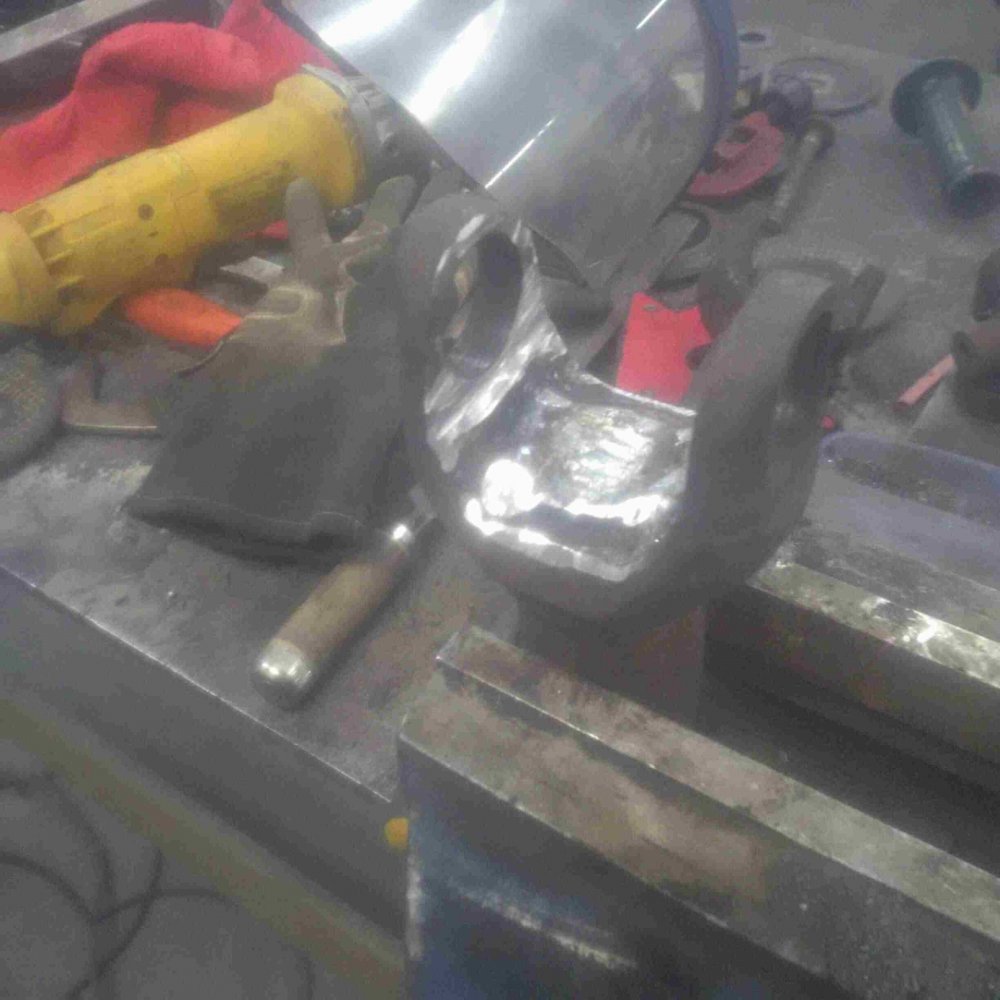

Here's a picture of how much I welded/grinded on the yoke. Thought it was enough, apparently not.

Had a few minutes tonight so I decided to tear the axle back out. Pulled it apart and used the burr to clearance the snap ring. Got it all back together and was about to put the spindle on. Huh! Rangers have roller bearings in the spindle! (Not mine mind you....sigh) who knew? So, knocked the bearing and the remaining 6-7 rollers that were left, out and called it a night. Now I'm wondering what the other side is like since I've never cleaned or greased it.

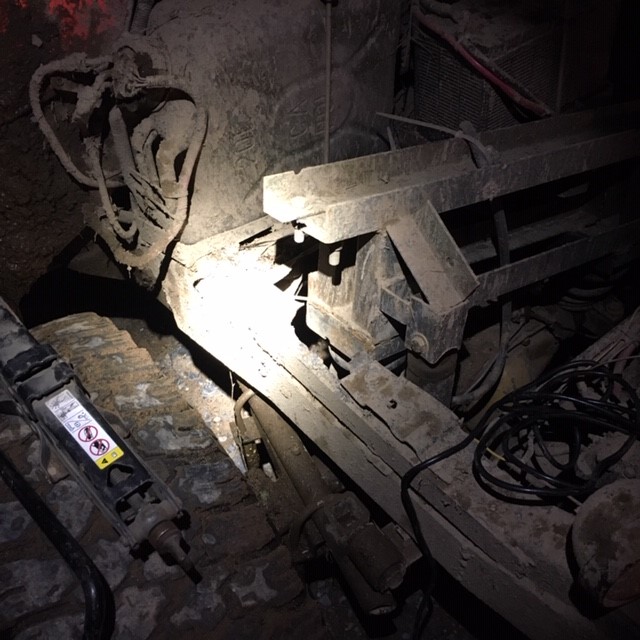

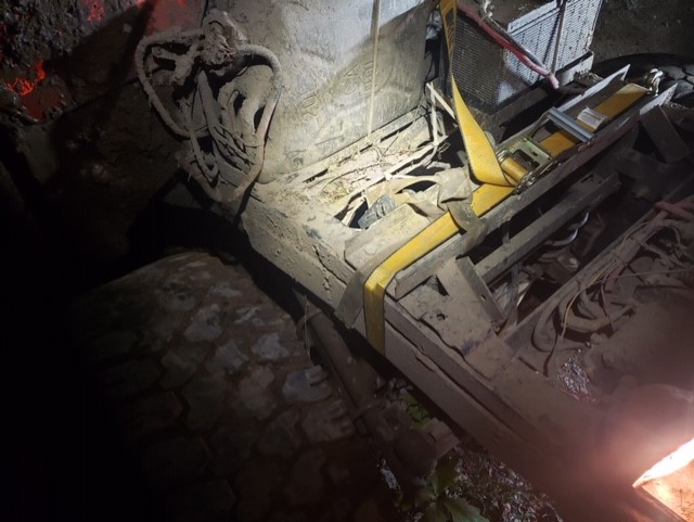

Now, the problem...apparently, jumping moguls is hard on the frame...the only place it was single thickness was the top of the frame in the back where I bolted the suspension on. And of course upon one landing there was a crash and the arse sagged on the drivers side. Ripped the top of the frame completely off on the drivers side and tore 3/4 way through on the right.
43572

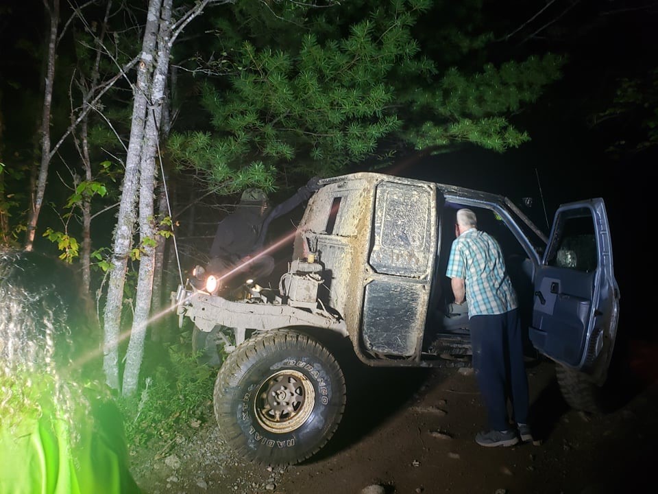

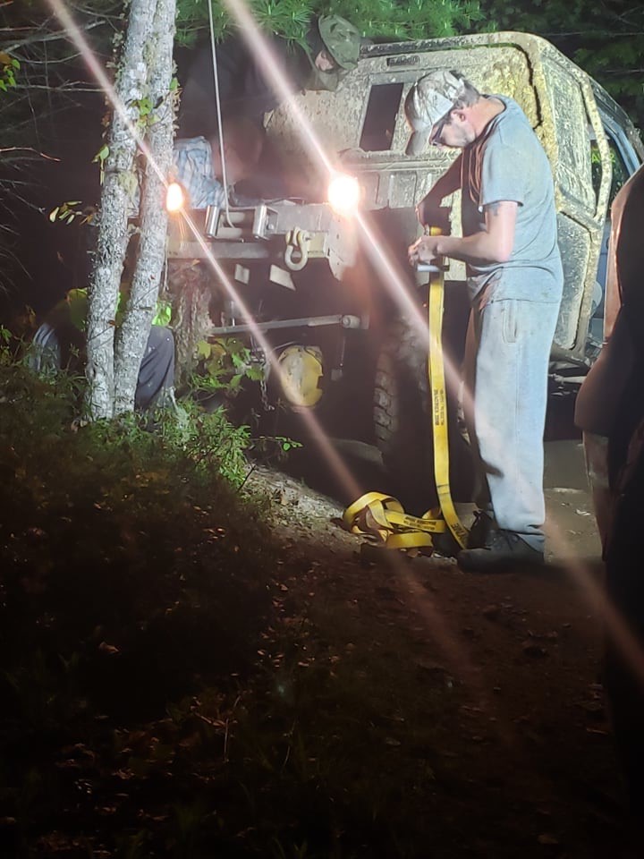

Well, that's not right.... ok, I have a winch on the rear so I pulled up to a couple of small trees, put the winch up high and jacked the ass off the ground dropping the suspension back into place.
43573
43574
and then used cargo straps to hold it all in place.
43575
and then proceeded to hill climb some more. (but no moguls)

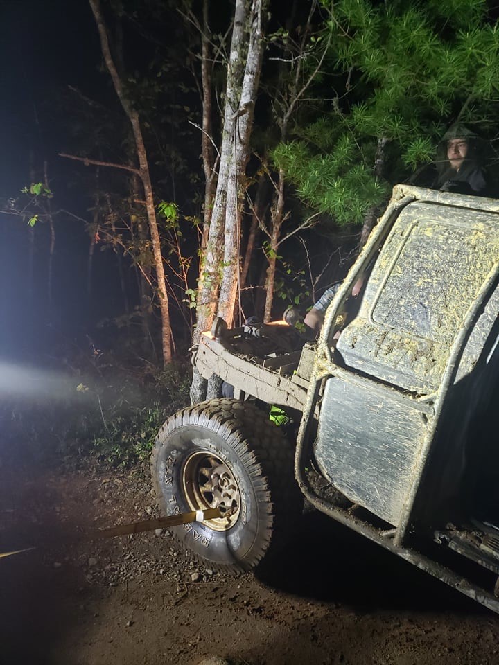

Since we were about 20km's from home in the woods, it was quite the drive getting home over the rocks on the powerline. By the time we got home, one cargo strap was cut and snapped but the second one still held.
Everybody says "man you beat on that poor thing like a rented mule" Well, yeah but it always gets home!
When in doubt, throttle out!!

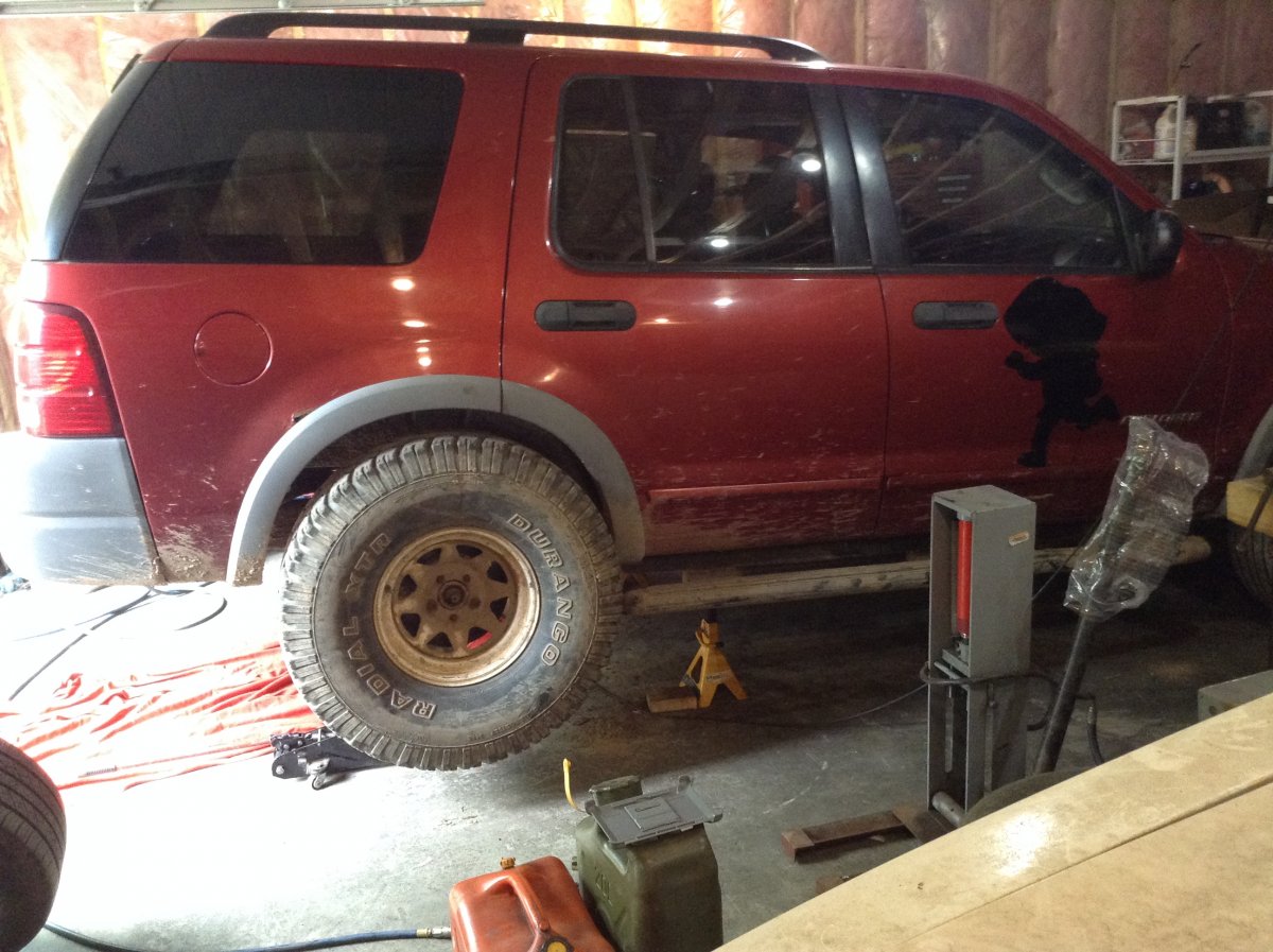

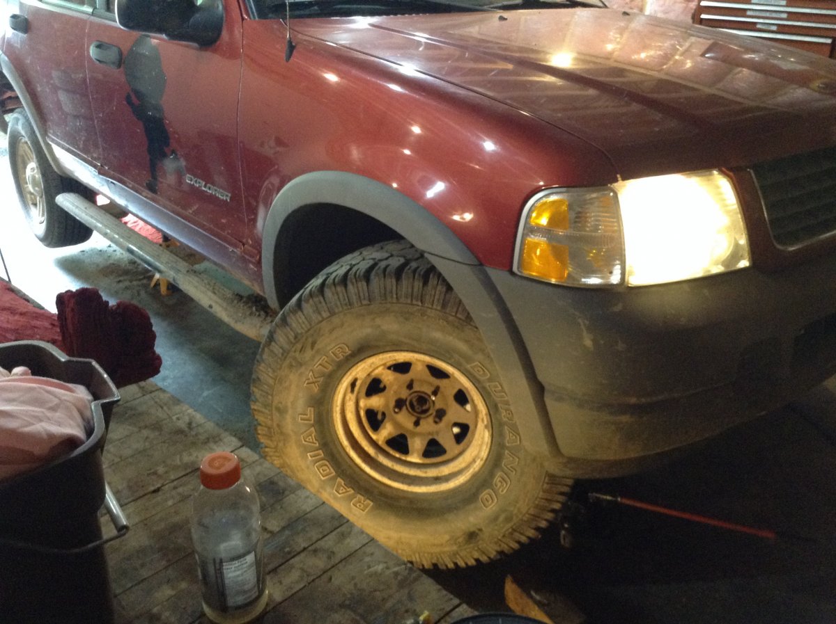

So...I found a 2002 explorer and got that. She wanted seats for friends and it holds 7! A woman owned it and parked it 5months ago when the ps line blew and was quoted $1200 to fix! Brought it home and fixed the line in about 15minutes. Need to do a couple brake lines and that's it. Could be shafted and put back on the road.

However...Dora....I took the donkey, a buddy took his truck and the wife and a couple girls took Dora on a run. Found out the rear left lower control arm was rusty when it snapped off . Used jacks and cargo straps to recover home. Wife said it's too low and wants bigger tires. I tried the 35's off the donkey.
So, now I'm looking for 33's and will clearance (zip cut, lol) to fit.

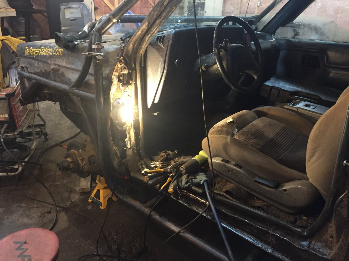

So, replaced the right axle and welded the caps. Went for a run and made some bad crunching noises.( detailed in my axle thread)
Pulled the left axle and welded the caps then kept going as the door was sagging due to rust.
Another shot of it tore apart and me putting more time into it....
