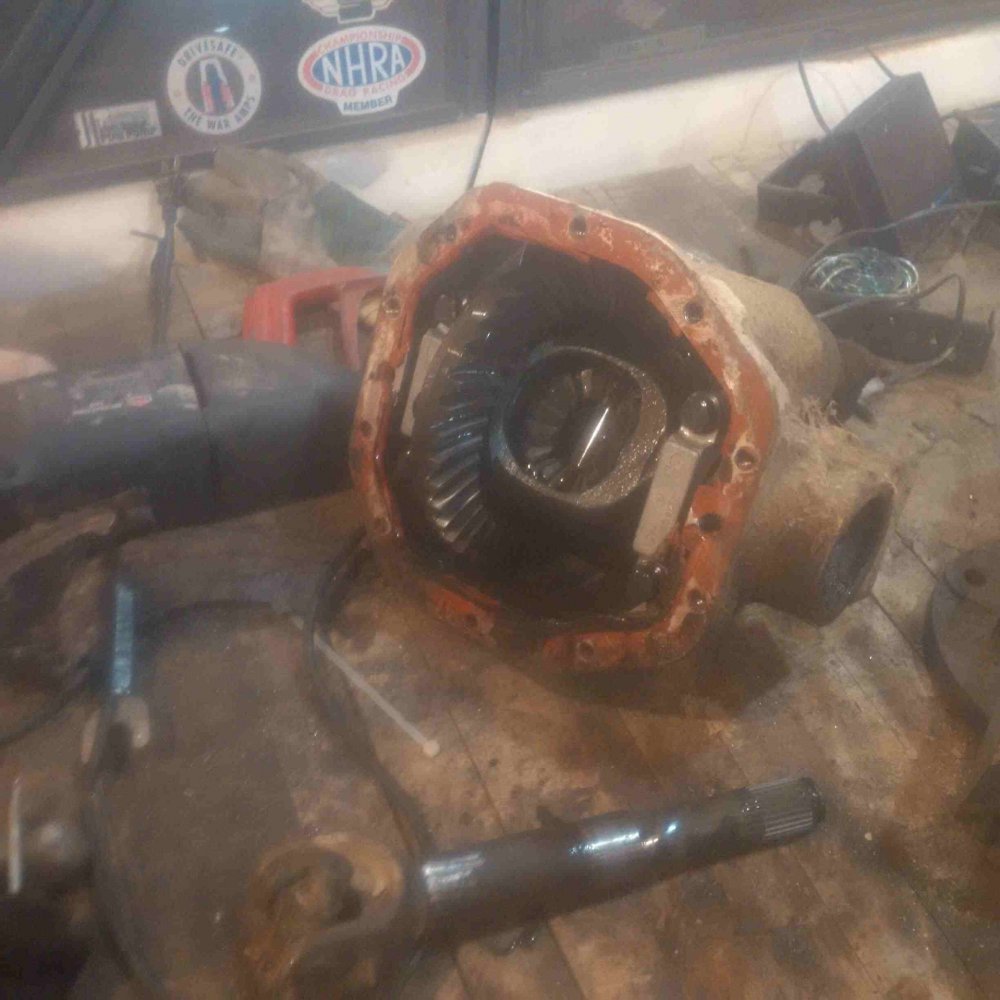

Got the diff out last night....wow, that's a pretty shitty design there ford!
Had all the bolts out and even the nut spun right off the one big bolt, diff would swing out but no way would it go by that bolt! I frigged with it for an hour and finally said...you tube! There was only one and it wasn't much help (looking for a short cut or easy way) Went on firefox and found several threads about pulling the diff...on the ranger station. lol.
So I read through and someone said about grinding the top of the radius arm. So that's what I did. Ground a half moon shape in the top of the radius arm and pulled the bolt out then wiggled and frigged and got the diff out.
The c clip popped right out! It shouldn't have, you're supposed to pull the pin and slide the centre pin over, etc, etc but I see on this they put a roll pin! I was like, how the heck can I pull a roll pin out when I can't get at it?? Frig it, I'll just whack the clip and..holy poo, it came out!
Here's a picture on my disgustingly dirty bench. (just put a front diff and axles in a 2010 dodge and never properly cleaned up before moving on to the next job...)

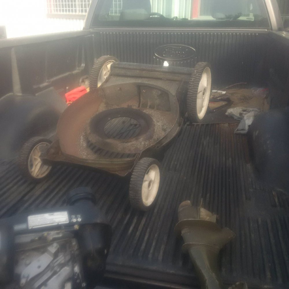

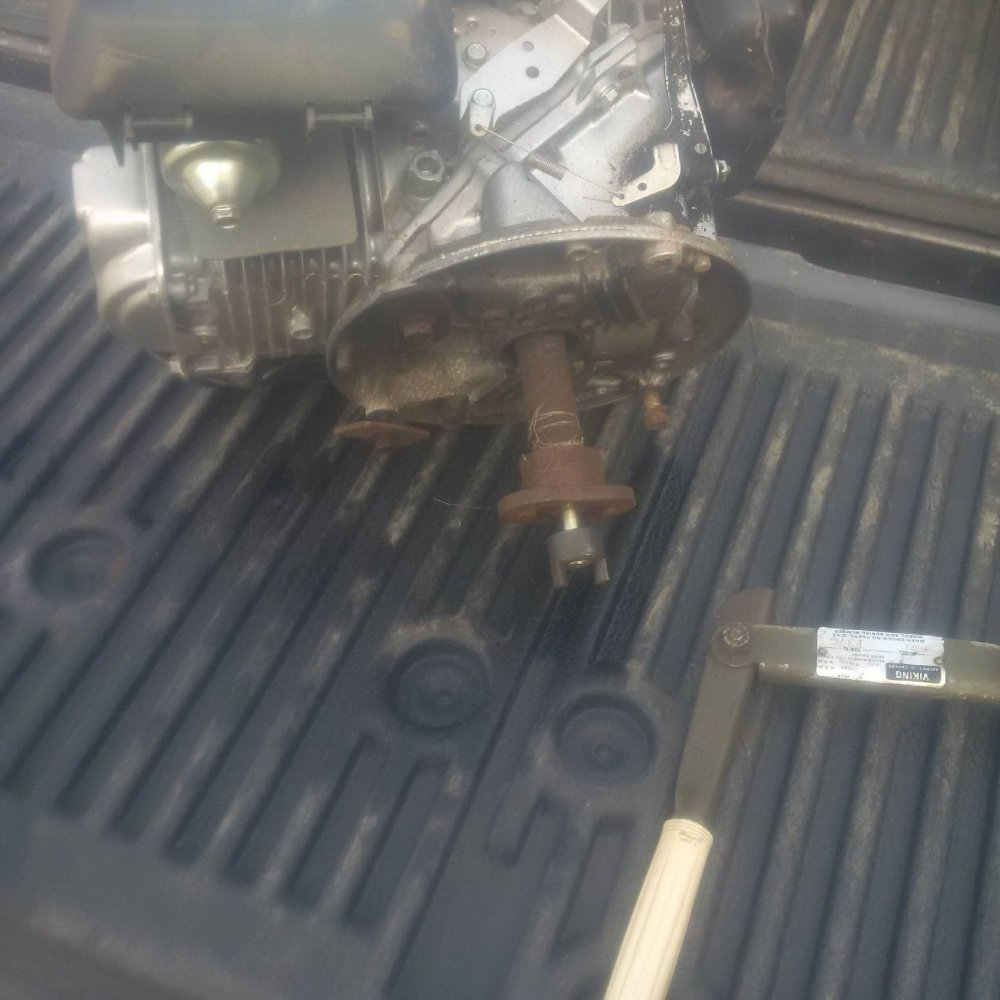

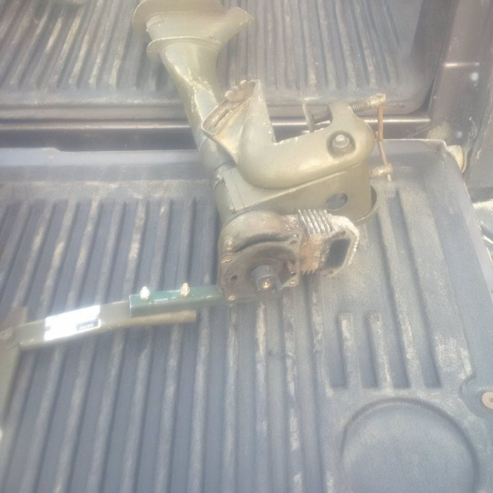

And since we're on the subject of boats, I already had a 2 stroke 3 1/2hp outboard but I hate the sound of a blubbering, stuttering 2 stroke. So...I grabbed a 6 1/2hp lawn mower from the dump and got the engine running and now am swapping the engines.

If you look you can see the lovejoy connector I used to mate the engine/outboard shafts together. I got 1/2" lovejoy connections and made brass bushings in the lathe then drilled the lock screw holes deep and will be using extra long set screws. Just have to make the mount today after work.

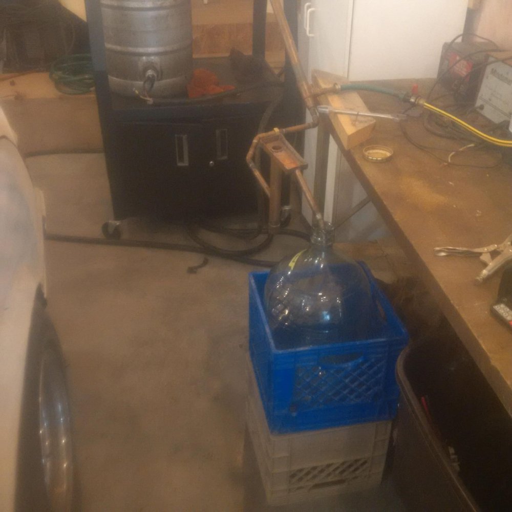

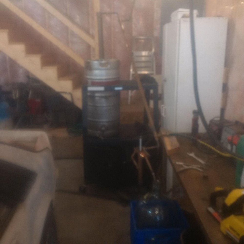

So, what I was doing yesterday from 9:45am to about 5pm was running a batch in my 114L still. Put in 100L of 10% sugarwash and got out about 20L of 65% low wines. Ran that through the second time and got about 18L of 73% neutral. (vodka) I'll cut that to 40% for drinking when I get home tonight.
Again...pictures...
The whole set up;
42683

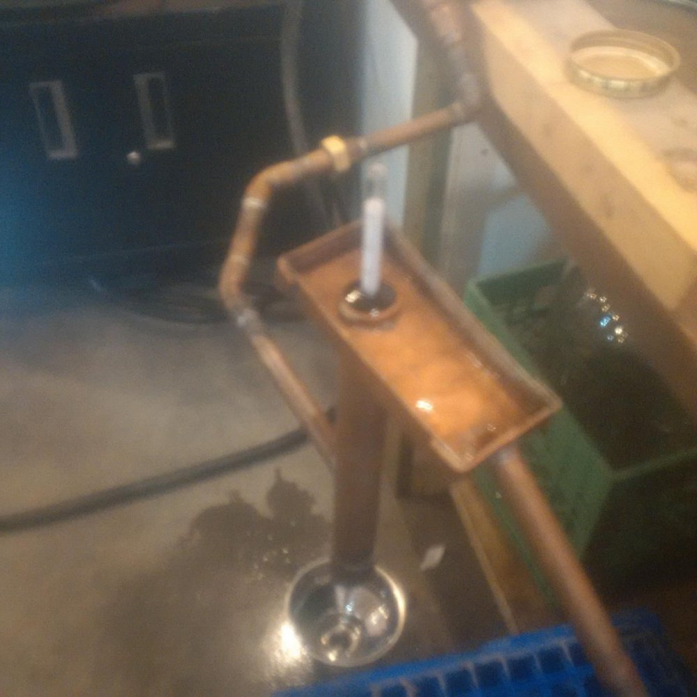

Close up of the parrot (where I put the hydrometer to measure ABV (alcohol by volume) as it's running
42684
and one of during the run, hydrometer is low as it started out at 89% (this is the foreshots, acetone, etc, the stuff that's thrown away)
42685
Garbage pictures, apparently the "autofocus" isn't so auto on my BB and I don't see anywhere to make it manually adjustable.
But, you get the idea.
