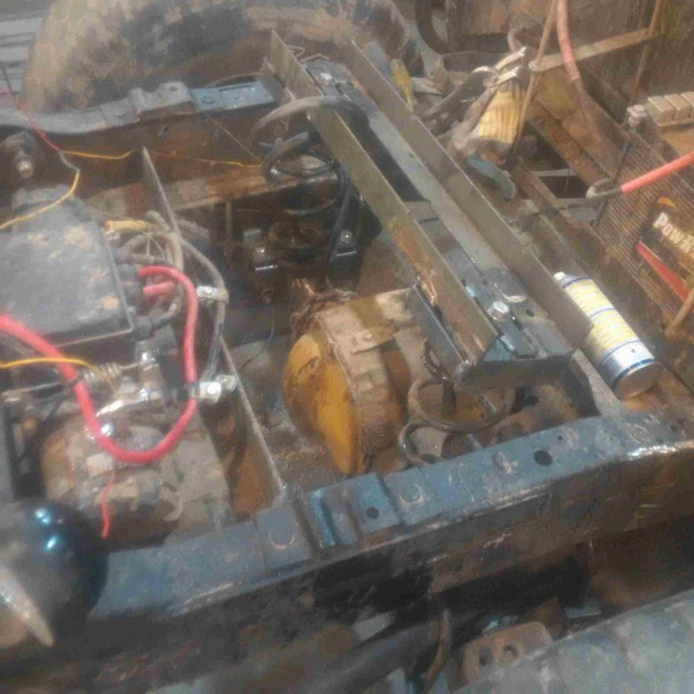

After finding only 1" of travel with the original set up, I cut the mounting tabs off so I could drop it into the frame.
41218

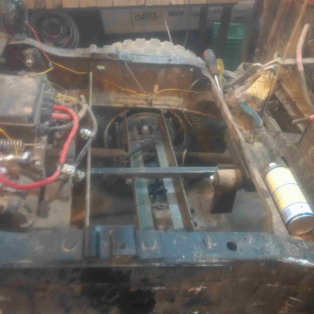

Stuck a one inch bar across to see how high I wanted it
41219

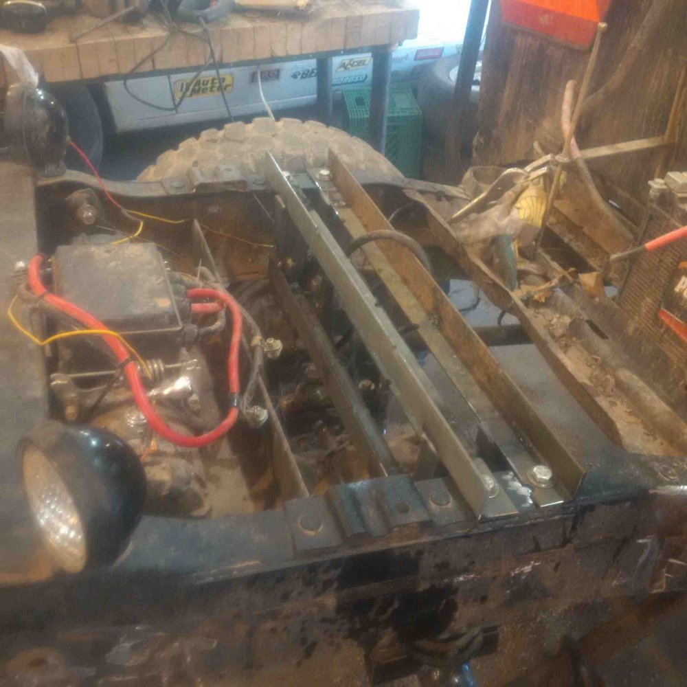

That was 7" so a little less than that would be good. So I put 6" long 2" square tubing on top of it and made new tabs.
41220
NOW she's sitting up! (maybe a little too high, lol)

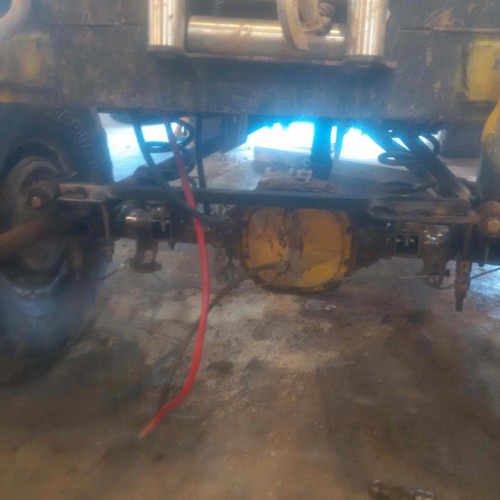

Built a track bar out of the old broken spring because it had rubber bushings in it already (less fab work) As I was heading out I realised that I didn't fully weld it on the right side. Do that when I'm installing the shock mounts. (those red and black cables hanging are for the winch)
41221

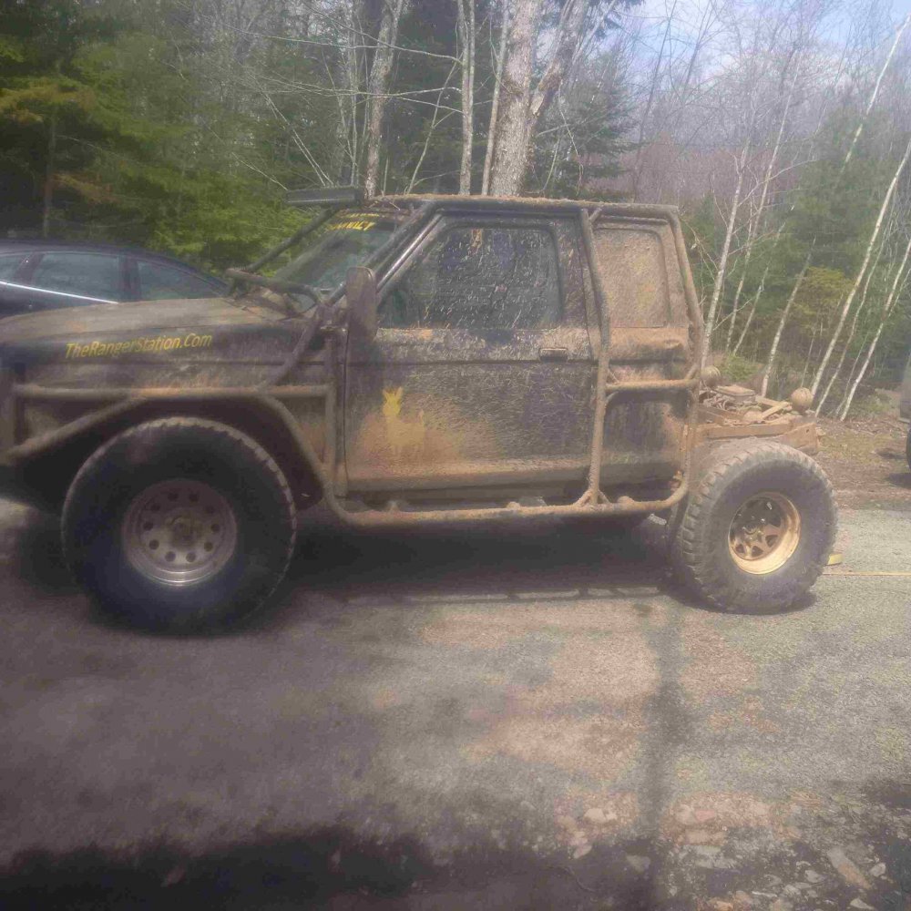

Here's the donkey sitting home this afternoon. (when we got up...)
41398

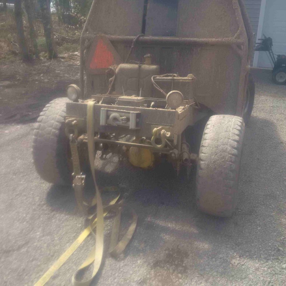

Why does it have a tow strap on it you ask????

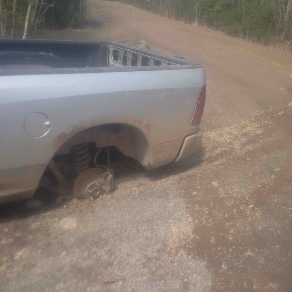

It towed a full size dodge 3 wheeler home!
41400

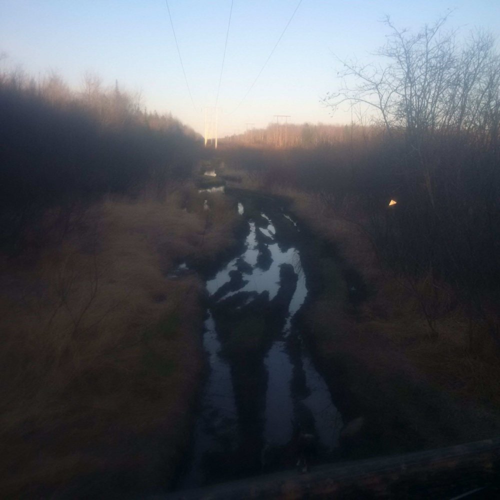

Well, this mud hole
41864

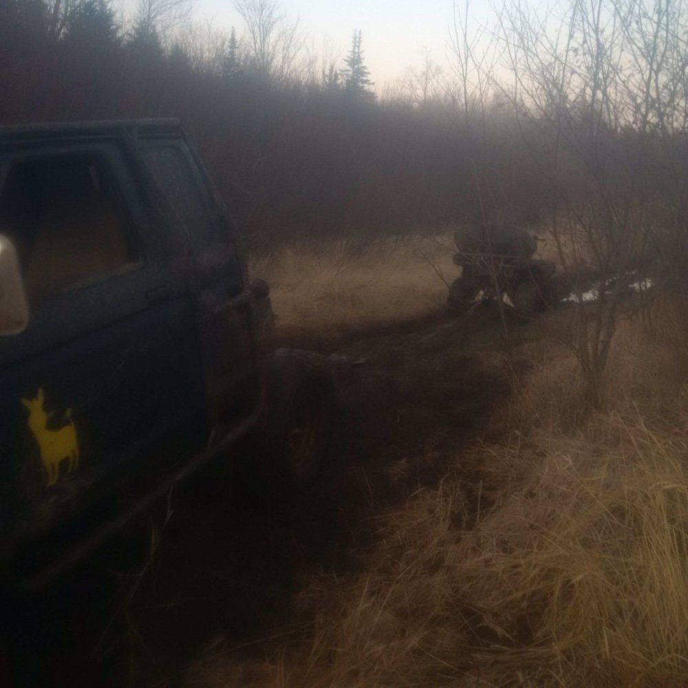

was so bad that only I could get as far as I did. So far I had to get towed out by this,
41865

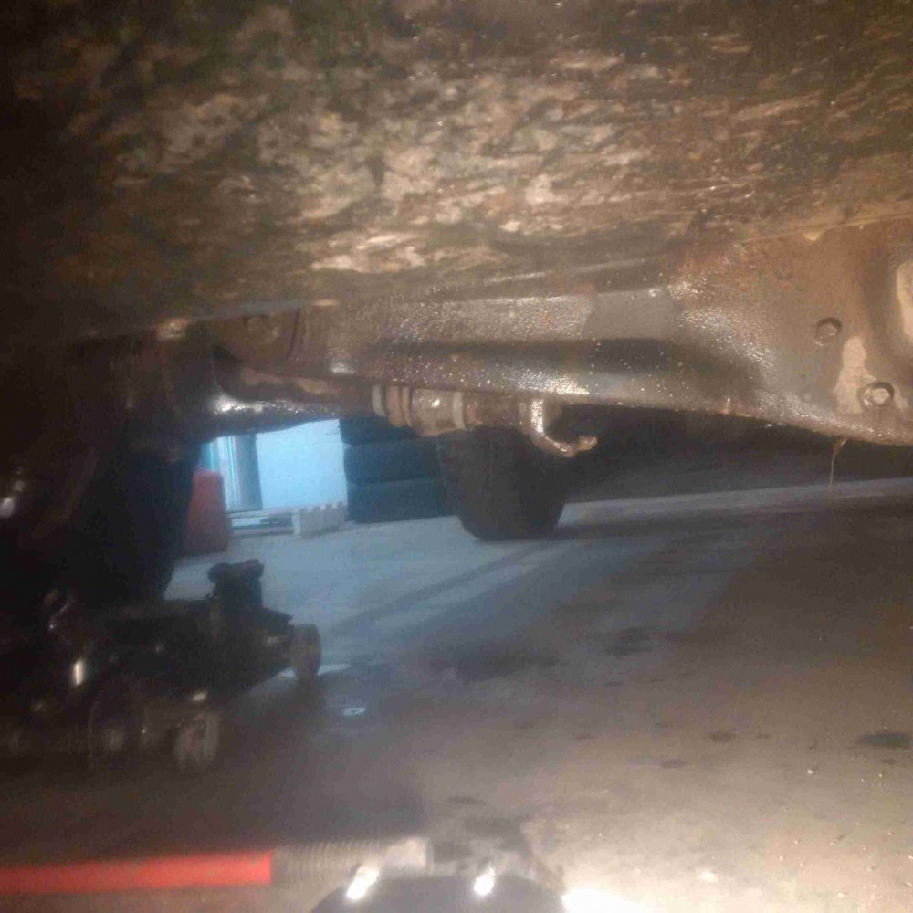

Drove home in 2wd and when I got there I looked underneath and saw this dangling out...
41866
Blew the front right axle u-joint. Snapped the ears off and everything.
