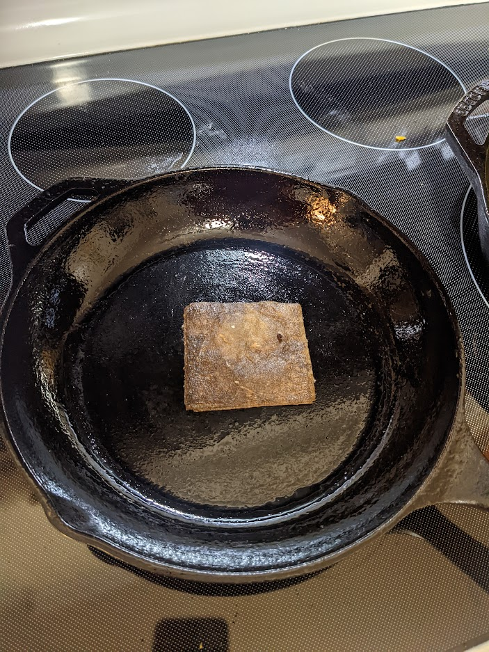

You can eventually get away with occasional soap on a cast iron piece that has years of seasoning bonded to it. But I wouldn't want to use it daily, and you shouldn't need to anyway. Between a decent brush (Lodge makes a good one but there are lots of options), or a simple scrubbing implement like a scrub daddy, there's really no use for a soap.
Like Snoranger, I always put the skillet right back on the oven at low heat to dry it out and then give it a quick wipe with vegetable oil. A paper towel folded down to about 1/4 it's normal size works perfectly, and you can just stick it into a zip lock bag afterwards to reuse it. I retired the last paper towel after... a year? They get really saturated with oil after a while and it only takes a few drops of new oil to put a nice coating down after the skillet is cleaned and warm.

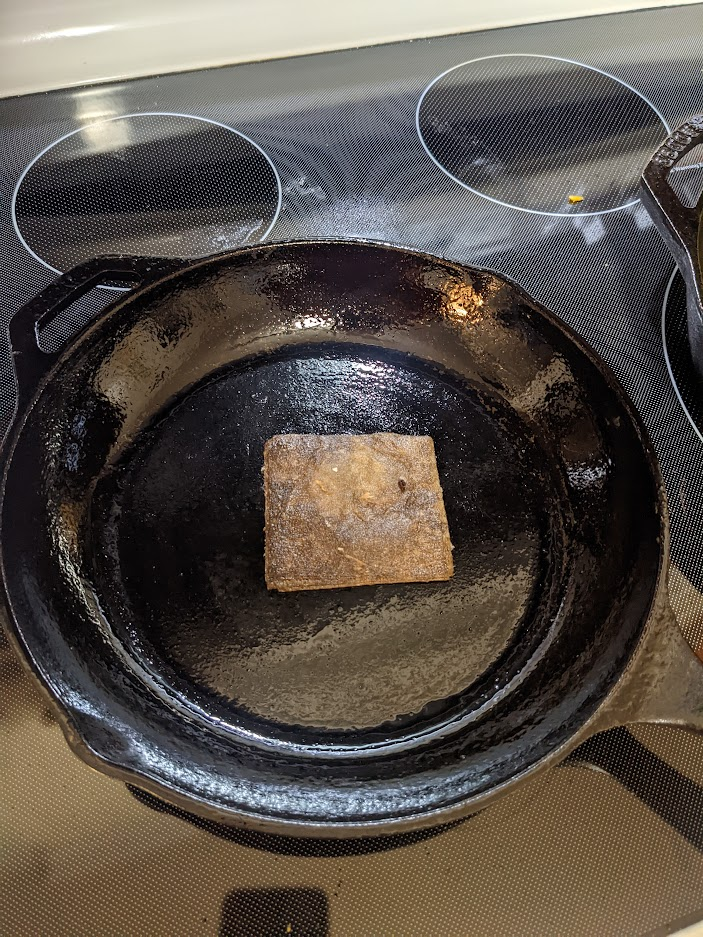

That oiled pan would collect so much cat hair at my house, in a days time, if I left it on my stove top. I like the idea of that process though. I'm definitely not against it and understand the concept. Most of my process is just what was handed down with the skillet. Which was mostly " Don't let it sit outside for too long" lol. I do most of the stuff you guys mentioned, but didn't think about "the process" very much. 2nd nature stuff I've been doing for decades. My wife won't even use it and has a Baby blue one with white cooking surface (ceramic, maybe). It's heavier than a dump truck but is super easy to clean. And apparently does not have seasoning, lol.
