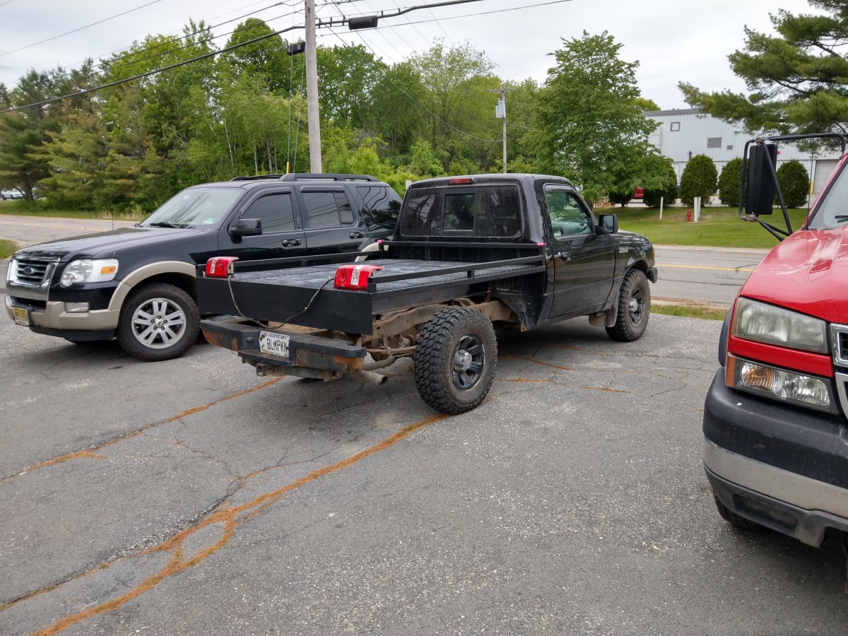

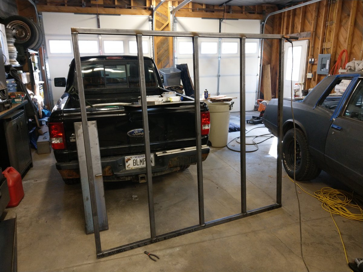

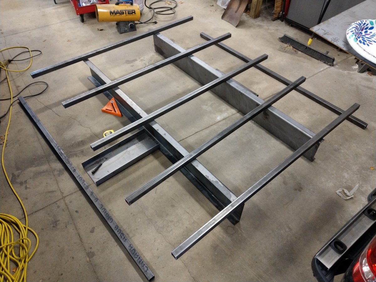

Started to fabricobble my flat bed.
.125" thick for both the square and channel. Had the channel bent at a local fab shop because all I could find for channel locally was .25" or better, which would of been too heavy.
The 4x8 sheet and 48 feet of tube ran me 300, and the fab shop trip was 100. I'll probably be 600 bucks or so into it when finished. Not awful I suppose.
43361
Made enough progress on the flat bed to leave it on the truck.
Hopefully it'll be 100% done this weekend. Then I can start thinking about ordering the windows&door for the camper myself and the fiance are going to build that'll sit on top of it.

The flat bed looks great. I was thinking about one for my truck, but I came across a great deal on a Spacekap, so went that route instead.

Tell ya what about the bed... Next time I'd probably just buy one lol.
I'm at 600 or so already for material and getting the c-channel bent at a local shop, still need to purchase wood for the decking (right now it's just expanded metal "grating"), buy stain and brushes to apply stain, gallon of tractor paint was 40$, a metal blade for my circular saw was 30$,a a few cutoff wheels and flap wheels, bottle of gas for the mig, a bunch of welding wire, tail lights, Will need to fab a rear bumper that looks more at home under a flatbed than the factory one.. And time. I'm no fabricator.. so it's taken me quite a bit longer than I expected to get all this together. It was a solid 8 hours or so tuesday to get it to where it is now.. Spent at least another 8 on it a few weeks ago.. and I still need to spend another day slapping on more coats of paint and a few other things.
1200 or so for a nice aluminum one, in hindsight.. Probably the better deal. I'll probably be close to 1k into this one all said and done so... Yeah...
Oh well. I enjoyed the time I spent making it lol.
