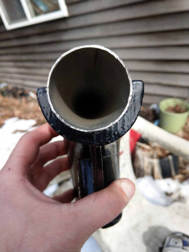

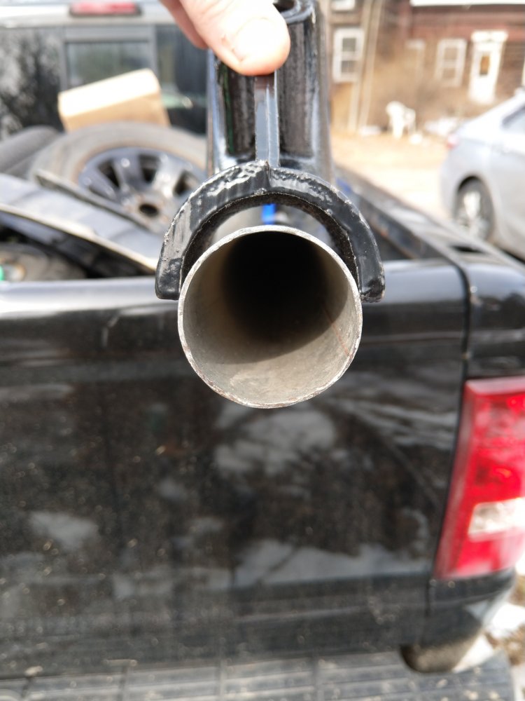

As pipe and tube are measured differently, the dies that come with the China benders are largely useless for tube. I forget the size of the die in the picture (I'll update), but as you can see I needed to open it up just a bit so my 2" tube could fit in it.
39039
My grinder made quick work of what needed to be done.
39040
It fits!
The bending rig needs a couple mods to really make it easier to live with, but for what I did today it's not bad. Definitely worth the 65 bucks I snagged it for on eBay.

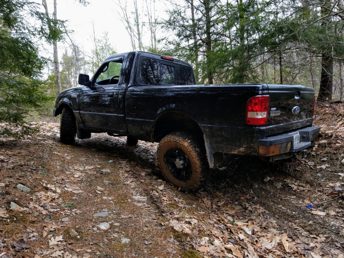

Ordered some Ching chong mud tires today, achilles desert hawk x-mt's in 30x9.5"
370$ shipped to my door, not bad. As long as sped-ex doesn't botch the delivery (knock on wood) they'll be put on Thursday or Friday, and.. with any luck.. get thoroughly tested this weekend.

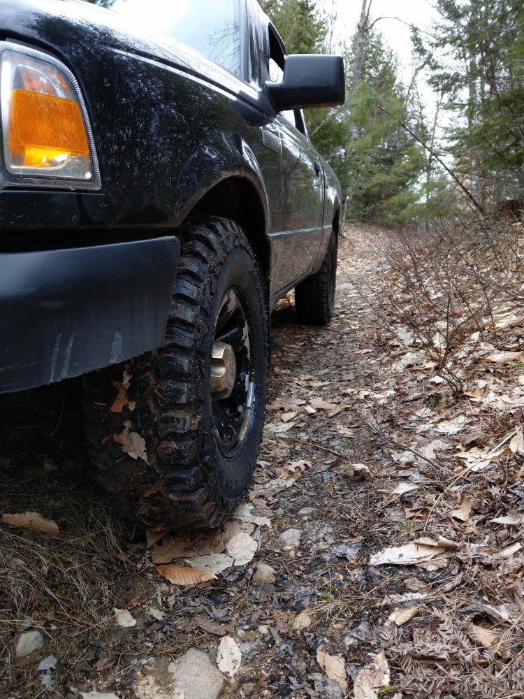

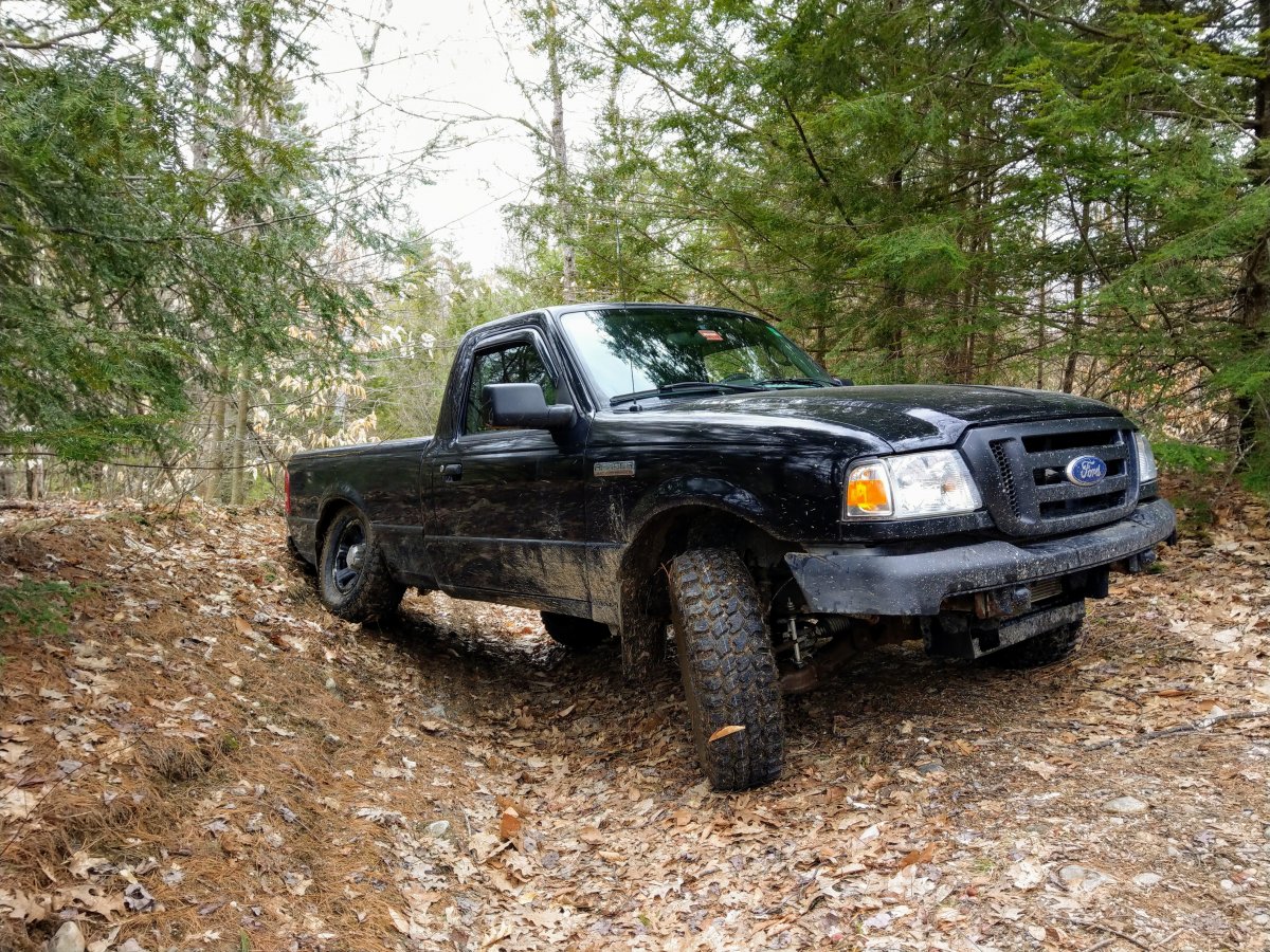

Got the tires on, really pleased with them so far.
First time driving on mud terrains and the added traction is comparable to upgrading to an lsd from an open carrier. Super impressed with my little 2wd truck now.
