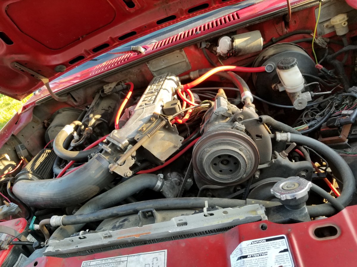

Was concerned about that with one. Usually I have to keep half of my rad blocked in spring/fall to keep the engine temps up on the highway. May still put one in on a thermostat. Meh. We'll see.
Three e fans + high flow thermostat + remove cowl plates + water/methanol injection + phenolic intake spacers + ram air = engine that runs stone cold if allowed.
A few times on humid nights I've opened my hood to find my upper intake covered in condensation. Weird feeling to see your IAT 20 - 30 degrees below ambient haha

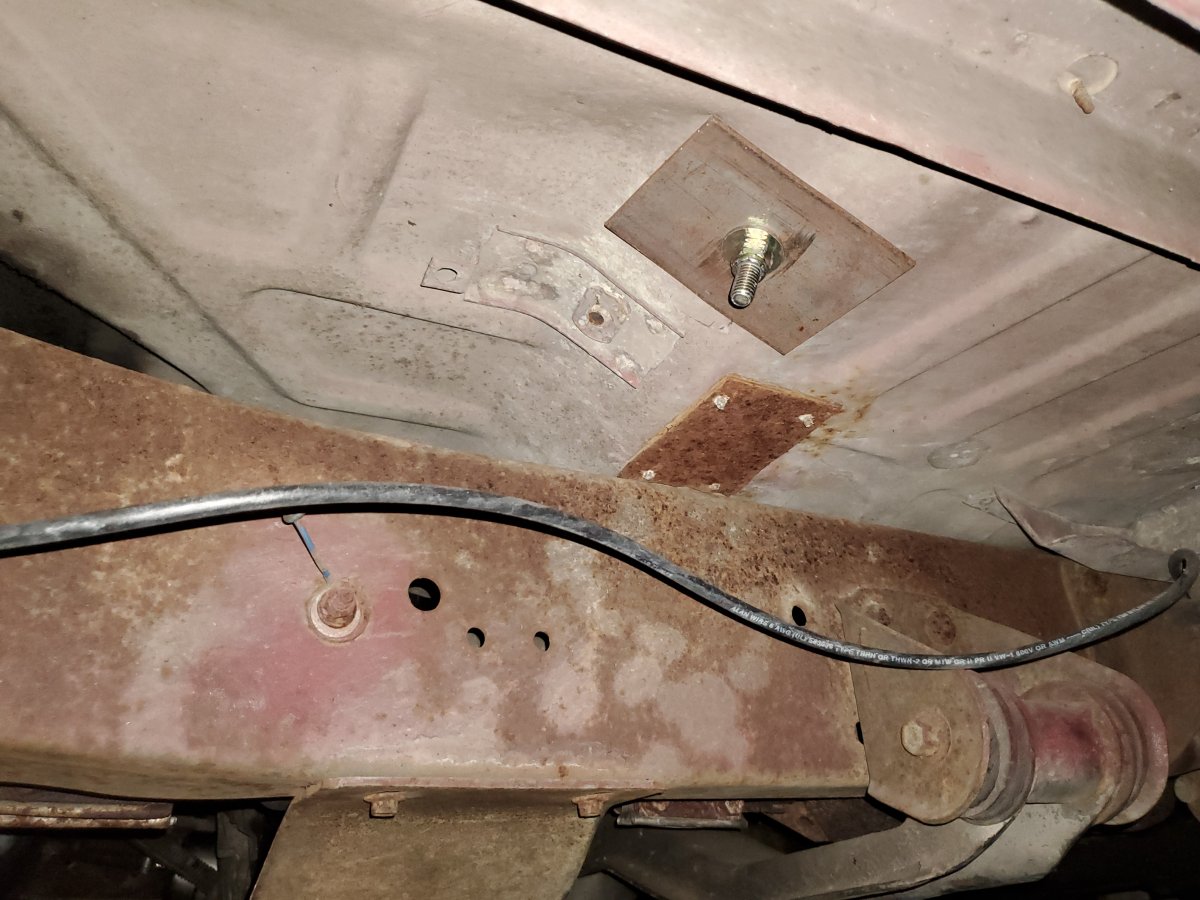

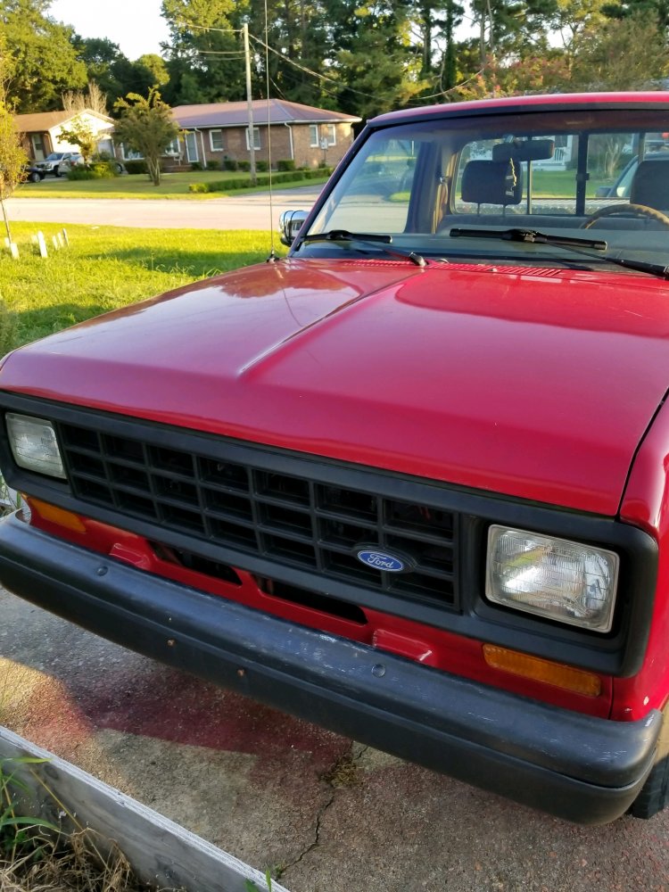

Your fuel pump switch is great anti-theft! Great looking truck too, by the way. Are you planning on keeping power close to stock specs or have you snuck in a cam/port job/chip/etc?

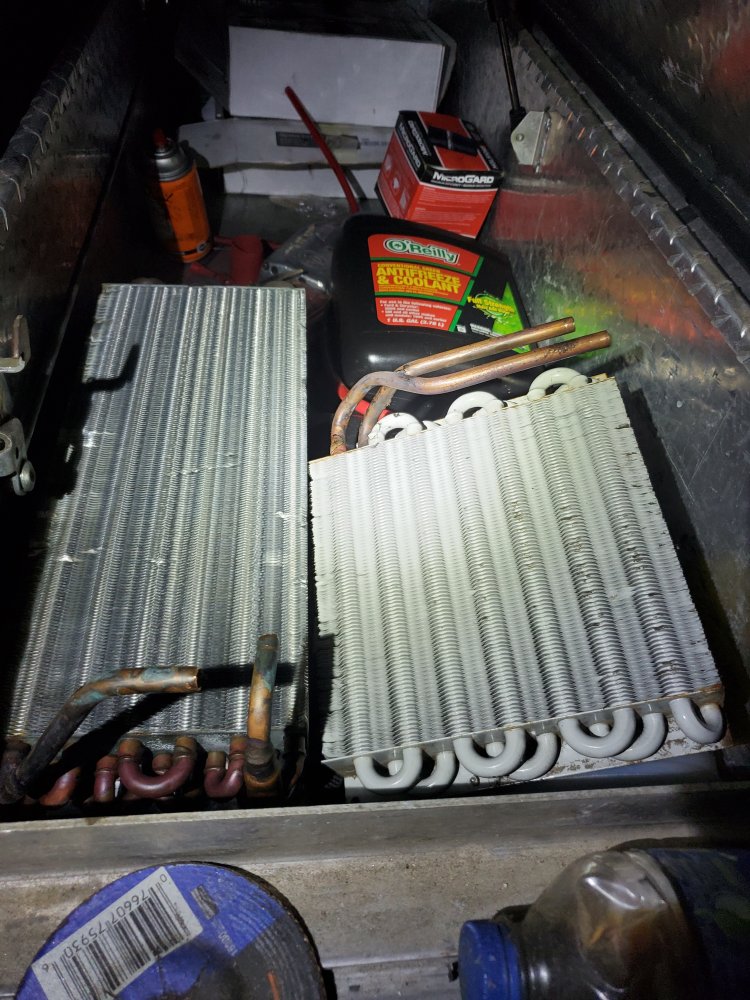

Those look to me like A/C condensers. They should have great cooling capacity and no problems holding oil or pressure. If you live anywhere cold, you're going to want to block the front of the truck off especially with an oil cooler. My temp gauge still barely lifts off the peg in the winter.

Yeah I told myself the same thing when I installed that switch lol. "Its a good replacement for your missing impact fuel cutoff and will stop the thieves who do know how to drive stick, plus you dont have to replace that bad fuel relay so it saves you money" the list goes on lol

Exactly what they are lol specifically from ac units for electrical cabinets. I get them all the time at work.

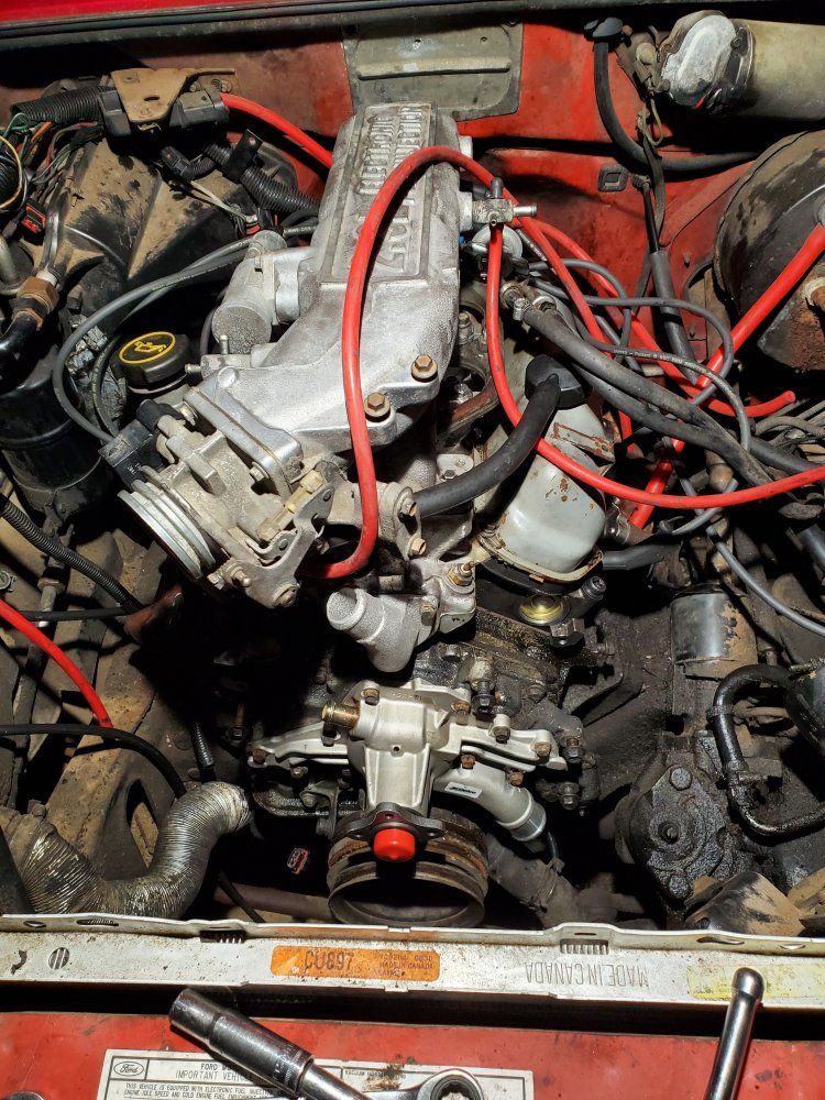

I'd keep the 2.9l if it didnt tick like hell
How's your camshaft? Lifters? Valve lash? 99 out of 100 ticks I've fixed have been easy stuff like improper lash or a worn cam.
As for the rich running... What's your fuel pressure? If you're out of spec, replace the regulator. If you're in spec, how old are the O2 sensors? Old O2s, even newer Chinese ones and especially the 1V narrow band sensors, will get tired and enrich or lean out the engine.
Solid front axle from the JY would be my cheapest bet. That Bud truck looks pretty damn good!!
The valve lashing may need adjustments I set them according to the trs guidelines it has new valves and lifters. The cams original didnt have the time to swap it out and wasn't sure what would be a safe cam to go with. I'm probably going to take it to a shop here soon and have someone who has a more experience adjust the valves.
I picked up a new o2 and am going to replace the ecu thermostat both have 30+ years on em so its probably due anyway. I replaced the whole fuel system tank to injectors and installed an inline pressure regulator so its getting exactly 40 at the rail.
