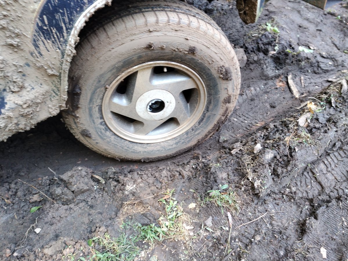

I never had wet pavement problems with the Firestone ATX tires (yea, the recalled ones) on my 1997 Ranger 4x4 reg cab and the few other rangers I have owned, I had no troubles. Granted, almost all of them have been manual transmissions. I have been using first the green diamond and then Kwedge from Treadwright tires for decades and they offer superior grip on wet and icy roads. Even on my E-250 4x4 which was extremely nose heavy, I had no issues with traction.
So. I think it is first the tire, then maybe the age, followed a small bit by the truck. I do know certain brands of tires can become rock hard, so to speak, and it becomes more of a hard plastic then pliable rubber.
I have a set of Prodigy HT tires that came off an Explorer I bought and scrapped and they have had wonderful traction in everything except for mud on my B2.
Note all the siping and water channels front to back on the tread that go the circumference of the tire. There are channels going from the circumference channels to the outside of the tread and then you have siping in each of those shoulder blocks. I have only had occasion maybe twice driving on ice, this being GA, and they did alright. The tires have to be at least six years old and are still pliable and they are going to wear out from weather cracking before anything else.
IMHO, These would make good trailer tires.
