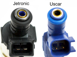

Your Ranger uses Jetronic EV-1 injectors. EV-6 injectors are the same height, just a smaller diameter and different connector. Both of these are common on Fords. They’re very easy to tell apart visually.
I guess I should have mentioned that they’re interchangeable as it’s just main body diameter differences. The O-rings are the same diameter.

So If I say "Jetronic" or "EV-1" what's the difference? Are they just different names for the same thing?
They're interchangeable as in just the Jetronic EV-1 and the EV-6 are interchangeble, all Ford injectors are interchangable, or all injectors (period) are interchangable? I often read about people on forums for various makes swapping in Ford injectors, I doubt that every make runs the same injector and connector style as Ford.

Here’s what Ford states:
About electrical connectors:
  • The USCAR connector is sometimes referred to as EV6, which is a Bosch term for the generation of injector.
  • Jetronic is the older style connector, sometimes referred to by the Bosch generation EV1.
  • Neither EV1 or EV6 is technically correct because those generations of Bosch injectors could come with either connector. However most EV1's commonly seen use the Jetronic connector and most EV6's use the USCAR connector so it's easy to see the connection.

To Summarize:
  • EV1, EV6, and EV14 are Bosch Fuel Injector Body Styles
  • Jetronic / Minitimer, and USCAR are Fuel Injector Connector Types.
