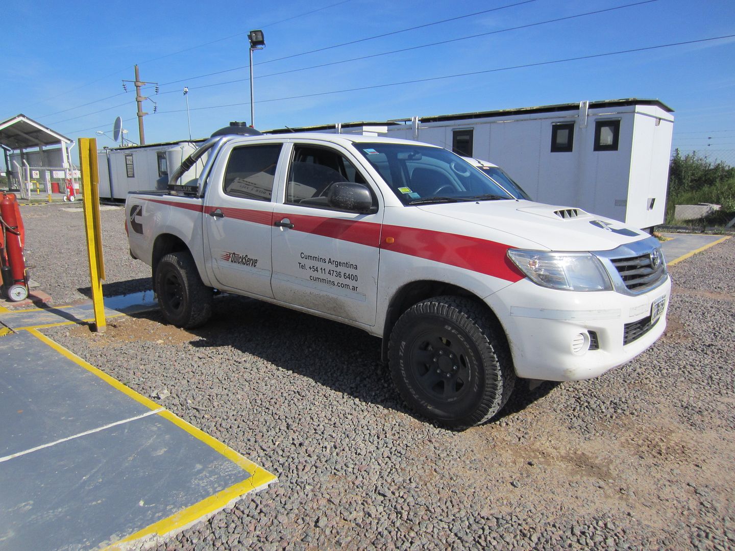

Another trip to Argentina, another opportunity to covet thy distant neighbor's crew cab Ranger...
Among other awesome trucks that we don't get stateside.
