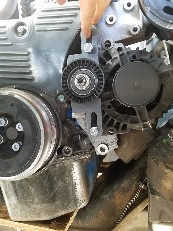

My 95 has a box which sits very close to the alternator and made it so that I had to cut the A/C compressor mount off of the accessory bracket. This picture is the best I have to show how close they sit. I had to rotate the engine a bit to make sure these cleared. I'd estimate about .5" of space between the alternator and steering box. I can grab a better picture if it would be helpful to see.
