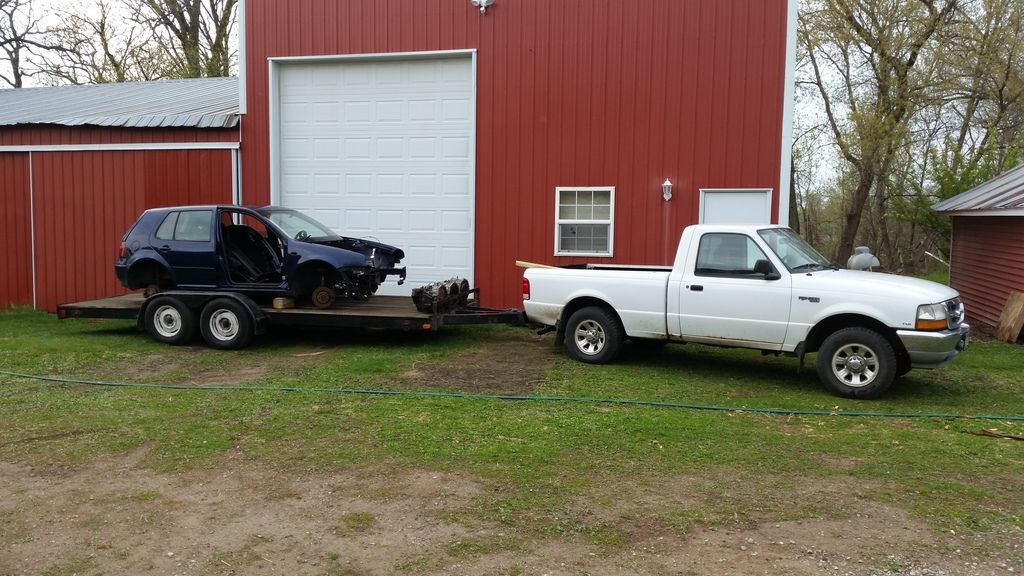

Just ran this guy across the scales yesterday. Picture is of the Golf before I stuffed it. 75# in the bags leveled her out and she handled the weight just fine thanks to the trailer brakes.
8540# loaded
5880# truck and trailer
3xxx# (I forgot what the truck weighs by itself....it's somewhere in this thread :dunno:)
Oh, scan gauge showed 25mpg loaded and 35 on the return trip. :icon_thumby:

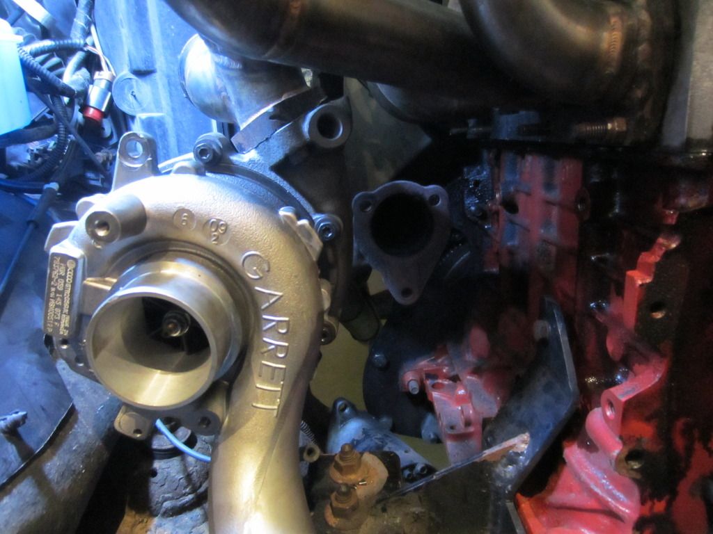

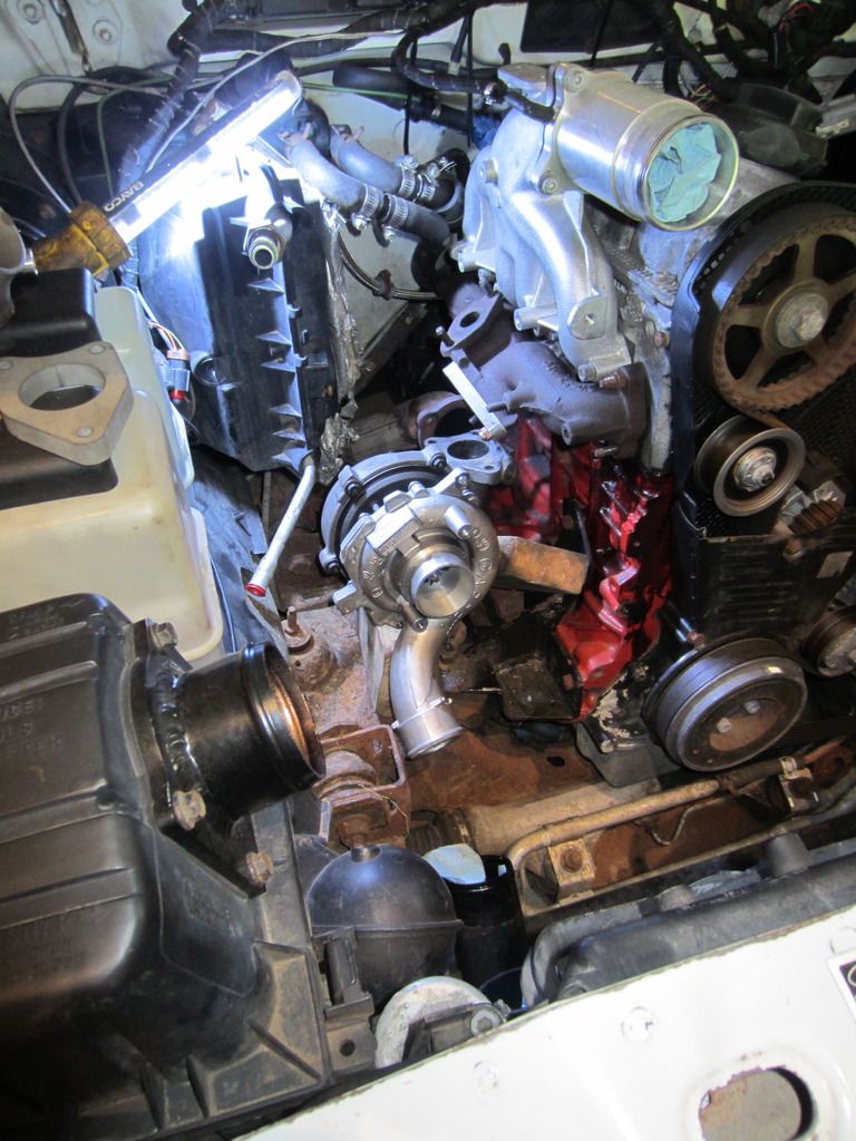

I've been amassing parts for the install for while but didn't know how everything would fit in the truck until I bolted em up. Well today was the day. I picked up this guy as it seemed like it would move the turbo forward in the engine bay away from my heater box.
As you can see it bolts up but the fit isn't exactly perfect. The downpipe has no chance of not melting the plastic heater box and there isn't much room for the actuator on the fender liner side. I figure I can go two ways with this 1) trim the heater box and put a block off plate on the hole I create 2) modify the manifold to rotate the turbo up and toward the engine.

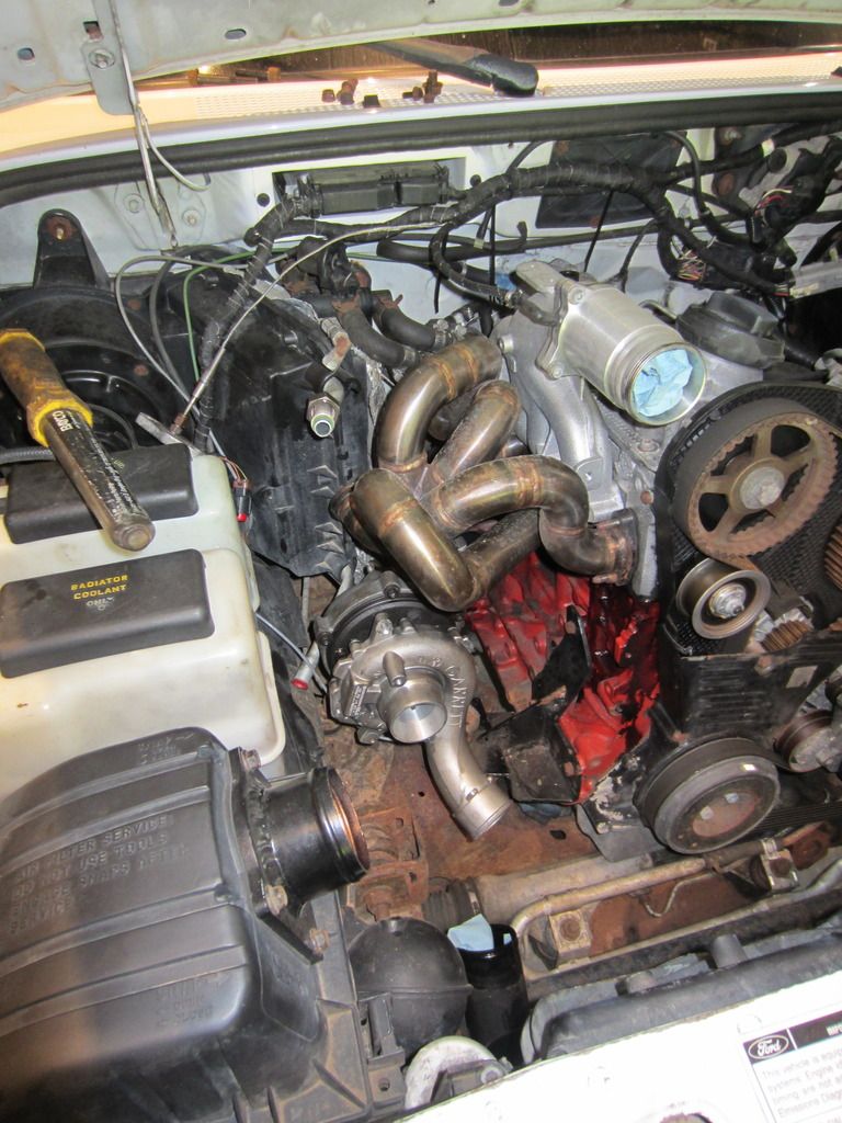

Here's what that second one looks like:
And here is the difference I'd have to make up with a new outlet flange. Not impossible.

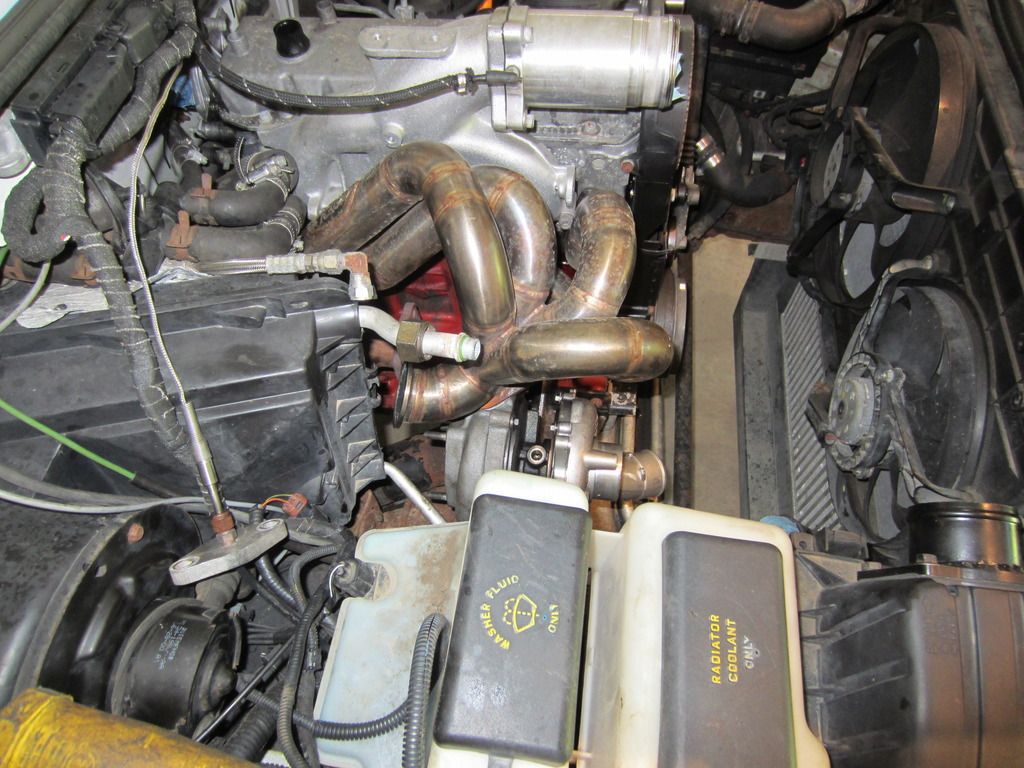

For the longest time I had planned on simply adapting off of a vw manifold so I wanted to see how that fit up compared to the tubular manifold. Overall it is sitting much lower and 1.5" rearward. This would probably work but I'm sure I would have to move my turbo drain line down to the oil pan...something I'd like to avoid.

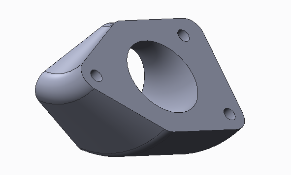

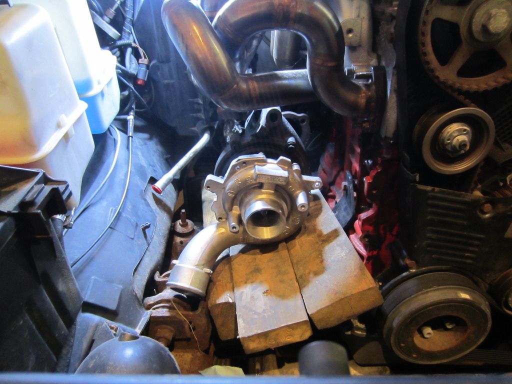

I made up a couple wood templates to see what angle would work best with the manifold. I then modeled up the adapter profile and matched that angle.
3D printed the model to double check fitment.

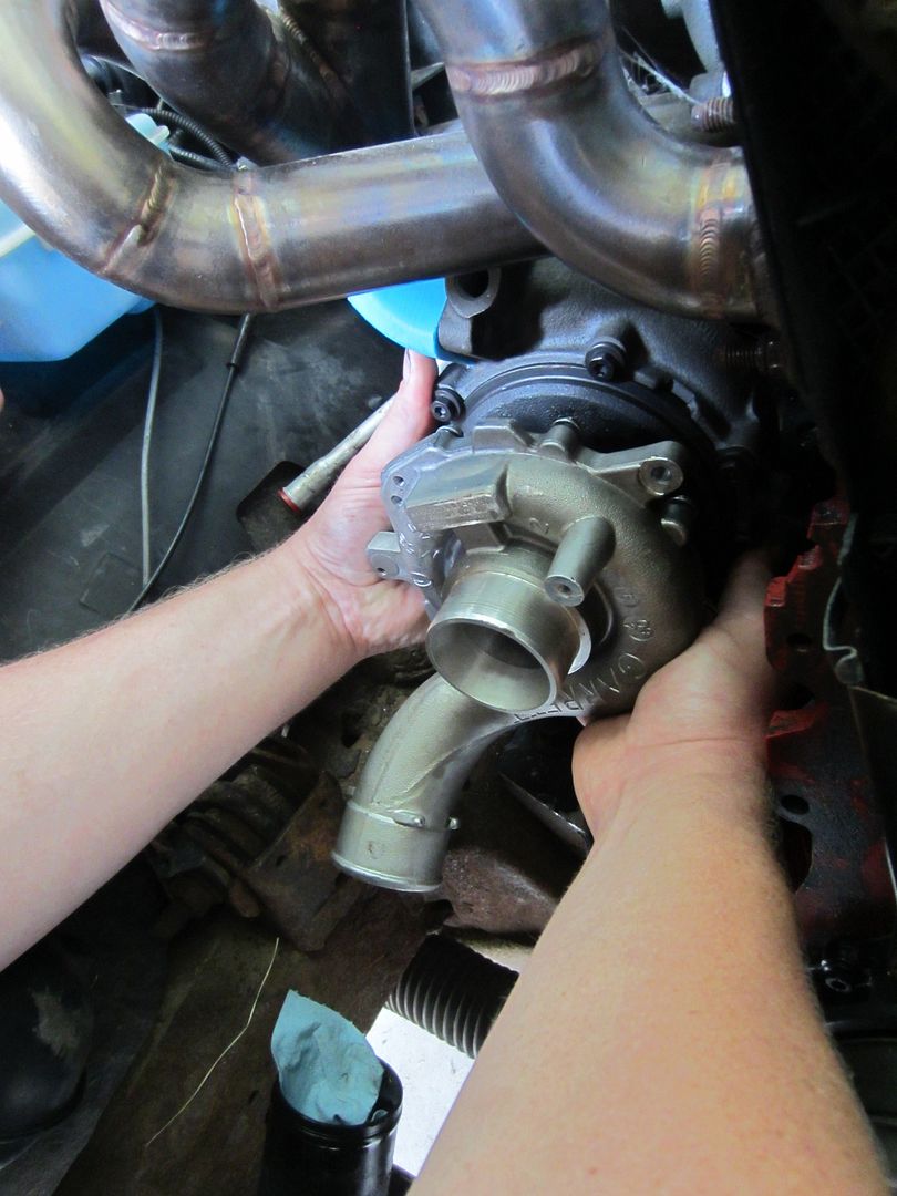

Looks like I won't have to touch the compressor outlet. Very lucky!
There is only one spot that the tooling won't able to get to on the inside radius. I'll blend this by hand.
