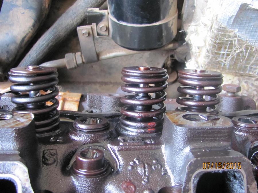

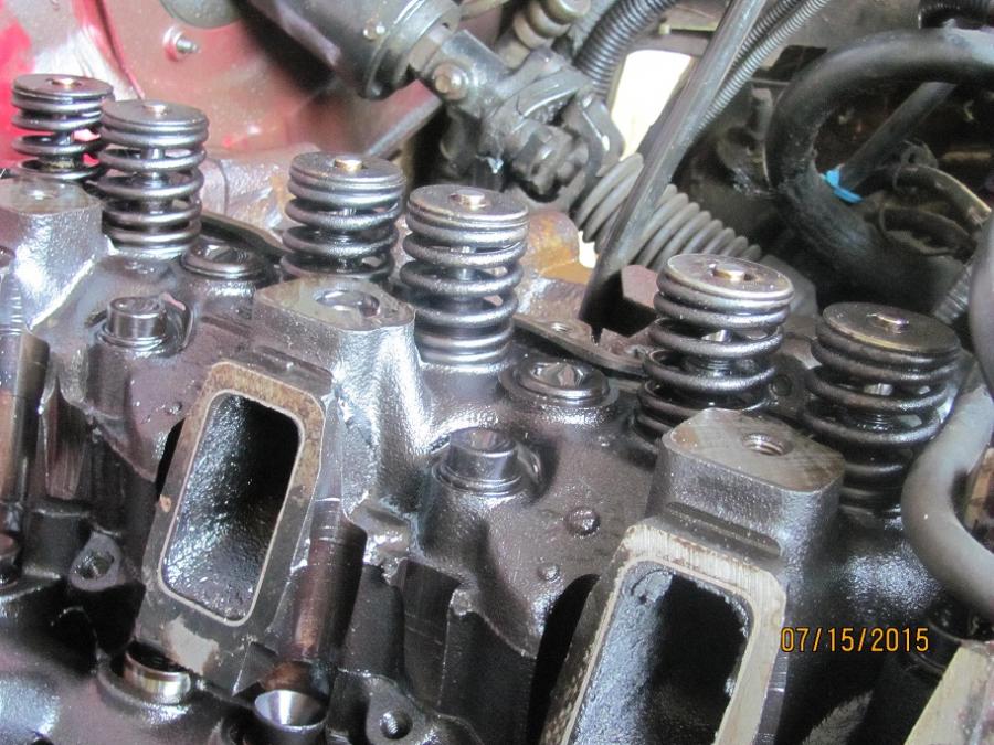

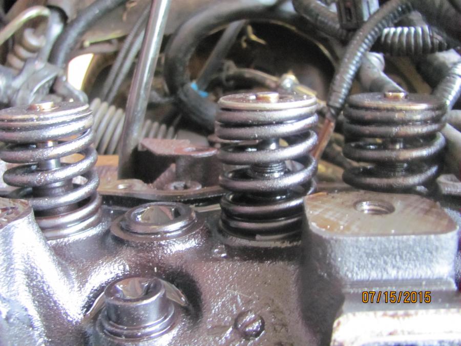

this is a pic of the right (passenger side) of the motor.http://www.therangerstation.com/forums/attachment.php?attachmentid=18936&stc=1&d=1439685639

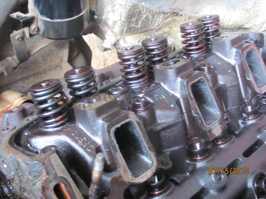

This is a pic of the driver-side engine. http://www.therangerstation.com/forums/attachment.php?attachmentid=18937&stc=1&d=1439685639

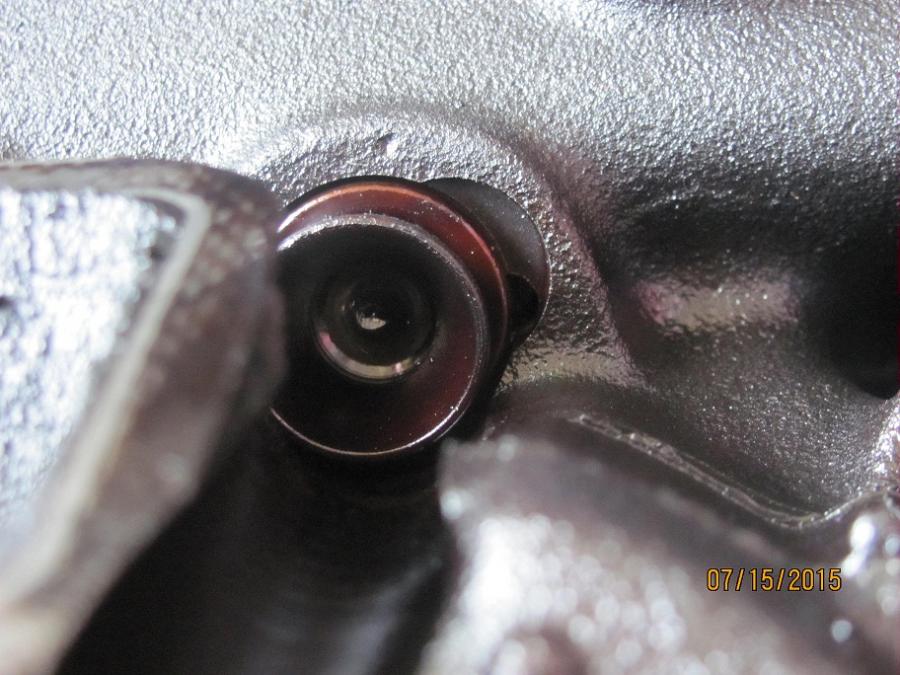

This is the bad lifter. http://www.therangerstation.com/forums/attachment.php?attachmentid=18938&stc=1&d=1439685639
Close up of passenger-side motor.http://www.therangerstation.com/forums/attachment.php?attachmentid=18939&stc=1&d=1439685639
Close up of driver side motor. http://www.therangerstation.com/forums/attachment.php?attachmentid=18940&stc=1&d=1439685639

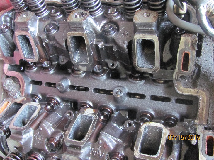

pic of upper intake. http://www.therangerstation.com/forums/attachment.php?attachmentid=18941&stc=1&d=1439685639

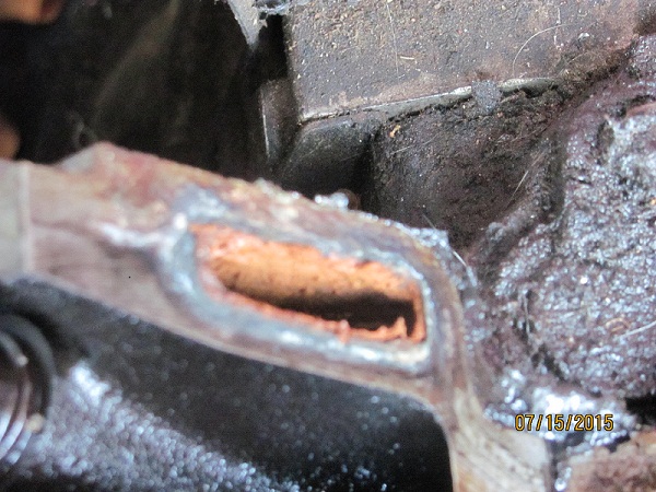

Pic of dirty cooling passages. http://www.therangerstation.com/forums/attachment.php?attachmentid=18942&stc=1&d=1439685639
Passenger side of motor is clean and of good color. Driver side of motor has carbon build up. Why?
Lifter is second from the front on driver side, and it is bad. I thought it was the first one on driver side but I was wrong. I just used a screwdriver as a listening device but I was close.
When I first bought this truck, I knew it had problems. But I couldn't resist the price. I did a radiator flush from autozone per instructions but the results were less than desirable. It over-heater a couple of times and I flushed it again with clean water but you can see the results. My question is " how can I clean the coolant side of the motor and get good results?
Thanks is advance for responses.
