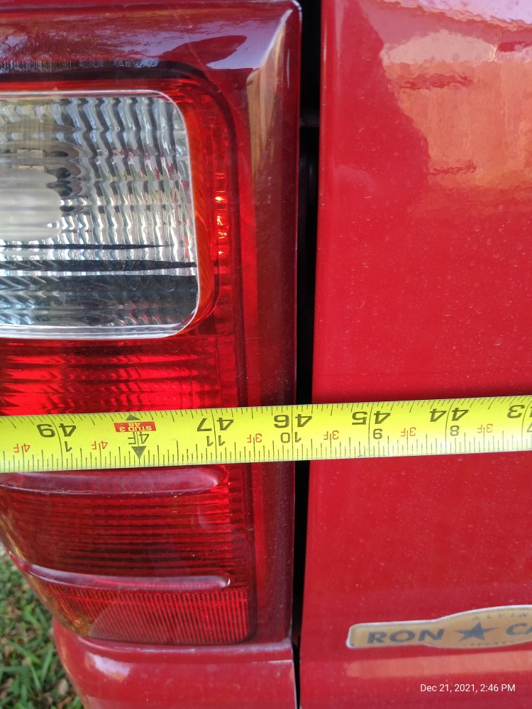

I can measure a stepside tailgate if you need that.

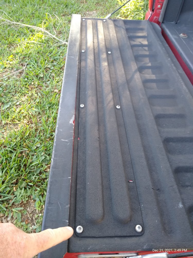

Does the regular tailgate have 8 bolts?
69589
Yes, styleside(regular) has 8 bolts for access panel
Hey guys thanks. Confirmed my friend's tailgate is from a styleside based on visual cues of the emblem to handle distance, measurements and the eight holes for the access panel.
Yes, for sure regular/style side based on distance
Yup, it's got 14 slots beneath the 8 bolt area. My flairside has 12 slots
