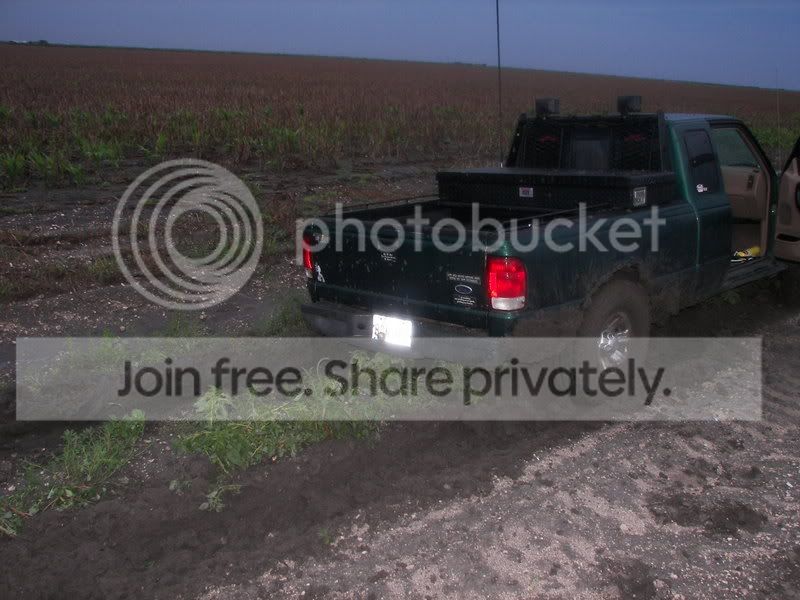

on my ranger, i have the tail lights with the reverse light on the top of the light...
i am wondering if i get a set from a 2000 ranger, that they will work

scott the issue if u use 99 tails is that u will have to separate the single bulb system into double bulb system, u have from factory, 1 bulb for all the functions, running light and stop/turn, in the 99 they had 1 bulb for running/stop and 1 bulb for turn, if u want to have the reverse light in the bottom u can use this tails, they have the single bulb system your truck has, this are from a 2000

scott5640, i didn't finish what I started is that all of the lights back fit and forward fit the only thing to consider is the electrical setups.
Your existing lights and the new ones you want are the sane electrically so there should be no problem. Watch how the harness is hooked up and all should be OK.
The good thing about the new Tail Light Lens is the clear lens, you can use the LED Bulbs to replace the incandescent bulb and they will look great.
The LEDs I put in and the exiting lights were the same electrically so mine were a direct fit and when they are converted to separate directionals it will only be a wiring change.
