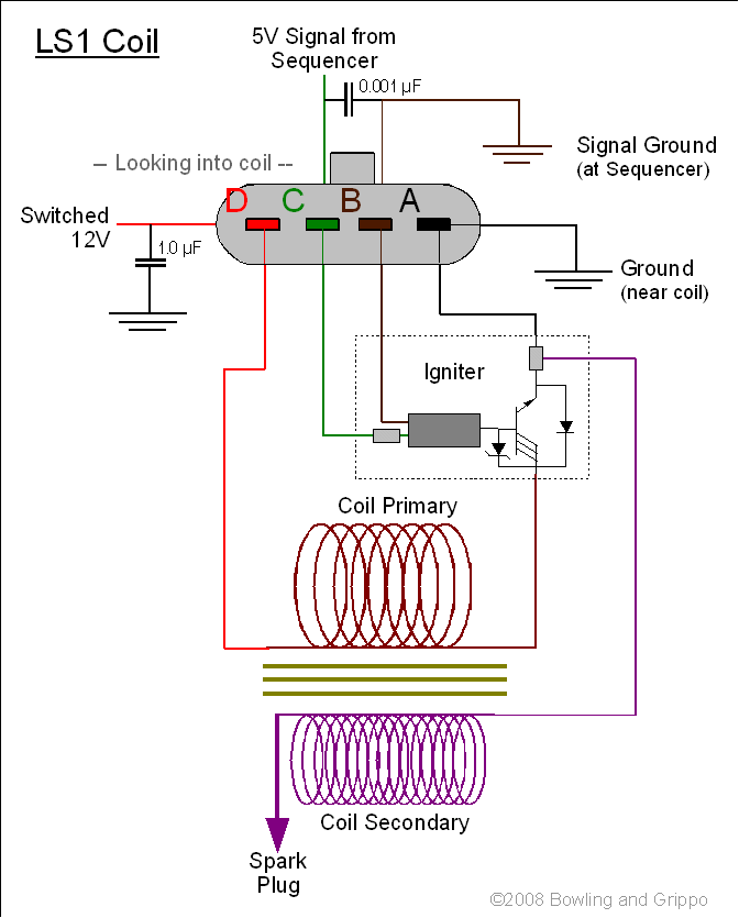

Here's what an LS1 coil looks like inside, the circuit labeled 'igniter' is just a set of transistors so the ECM can pulse the coil without having to handle the full current and without noise/high voltage coming back from the coil (both bad for sensitive electronics obviously). But that should be the same signal as the negative side of the coil was getting as far as I can see... I guess I can just disconnect the coil entirely and hook the tach output from the ECM to the tach input pin on the original harness if that makes sense.
Regular tachs want a 12volt square wave signal this is probably lower voltage at lower RPM and gets higher with increased RPM
Yes, hook the ECM tach OUT to the dark green/yellow wire to tach in dash that should have the full 12v square wave all the time
