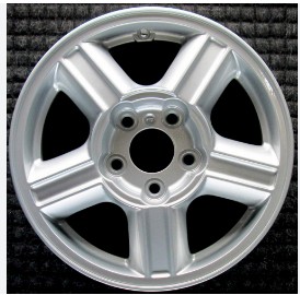

I came into wheels from Ranger 3.0 like pic below with 245/75R16 tires. Are 245/70R16 tires ok replacements for these rims/this 2.5 truck?
Will this size wear out the suspension faster than factory sized wheels?

I currently have 235/70R16, rims from a 2004 Escape as below. Pulling steering to the end, there's a slight rub (but I rarely need to do such tight turns.) I figure it must be the rims offset cause they sit a little bit inside in the wheel well. Another reason I would like to switch, to regain the normal ranger look, & eliminate the rub.
Also is there a huge difference in gas consumption between oem 15" and the 16"?
(Truck came with 15" prolly 225s.)

Google AI says the 235/70/16 tire you have now is 28.95 inches in diameter. It's a 70 series so 70% of 235mm is 164.5mm or 6.48 inches wide
It says a 245/75/16 tire is 30.5 inches in diameter. It's a 75 series so 75% of 245mm is 183.75mm or 7.23 inches wide.
You had better hope the offset sticks these tire out away from the truck, these tires are significantly larger than what you have now.

The Escape rim have significant offset (40mm), while the OEM rims were most likely 6mm (again based on cheap steel rims on XL)
The equivalent 16" will be about a 215/60R16...
The calc shows the 245s would be + .55" diam, + .39" wider. Is this that much of a significant difference to affect clearance?
I can keep the same tire size on the "new" rims. Does the "new" rim meet specs to accommodate 235/70R16? Does anyone have a link to this rim's specs? What is the smallest width tire for this rim (in case I want to go lower in the future)?
I used to run 18" (2006 Explorer rims), they had a way bigger rub on suspension than the 16". Both sizes reduced my take off speed. I have learned to live with it cos once the truck gets going it' fine.
I have spacers from eBay but I never installed them. They don't have the lip ring that a rim sits on and they themselves don't sit on the truck's wheel hub lip, being slightly bigger. All that kind of spooked me and safety concerns made me not install them with the 18" wheels . Instead I installed a sliver of a wheel spacer ring. That made the front wheels flash with hub and still sit on the lip. EDIT: Actually their centerbore was slightly smaller, they wobbled but the ring spacer took care of that. Which means @lil_Blue_Ford all this time they were lug centric.

Tire size and gear ratio affect performance the most with a given engine. Personally, with the 3.0 and 4.0, the max tire size seemed to be about 30” with it being a little happier at 29” for 3.73 gears. 4.10 gears worked well for 31/32” tires. Tire width is a little less important because most of your more common sizes in those diameters are adequate.
Rim size is more about clearing components. Any Ranger rim should clear just fine on another Ranger with a few exceptions like a 14” rim will not fit on a 98+ Ranger because of the brakes and there was a break there on the centerbore as well.
Rangers are lug centric, which means that the centerbore doesn’t have to be a tight fit because it centers on the lugs. Personally I still prefer a snugger fit on the centerbore but my Choptop has been running rims with a larger centerbore for years.
I have a set of 18” Explorer rims for my green Ranger. The centerbore is too small to work and the offset is way too deep. 1.5”-2” spacers are required. I’ve been trying to hold off until I can afford a set of good spacers because I don’t trust the quality of the cheap ones. One of the big failures that a lot of people make is that you are supposed to use locktite on the stock lugs to mount the spacer and check the torque of them after the first hundred miles or so, then check them fairly frequently after, every few thousand miles to ensure that they are staying snug. I have a thread on here about spacers somewhere.
Rims and tires do not significantly affect suspension wear, that’s age and abuse that do. Overly large spacers can as well (you ever see the trucks with like 6” spacers and rims that stick way out? Yeah, those will trash wheel bearings, a 1.5-2” spacer on a deep offset wheel to make the rim and tire combo sit in roughly the stock position shouldn’t really be any worse than a stock tire and rim).

Also the main question I had earlier has come into focus properly. Is there a significant wear on bearings switching to 245/75R16 from manufacturer 225/75R15?
I've run from 215/70R15 to 255/70R16 on various stock wheels with no appreciable change in wheel bearing wear. It's really wheel offset that affects it most.
The stock setup keeps the center of the tire roughly in line with the space between the wheel bearings. When the offset changes it starts putting more weight to one side so acts like a lever trying to pry the bearings apart.
