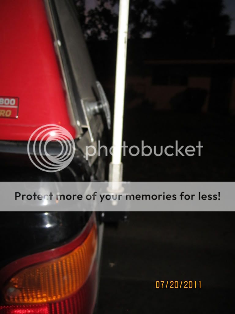

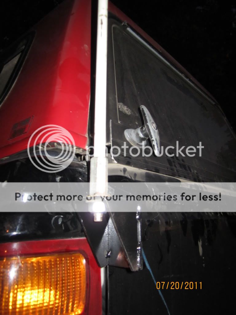

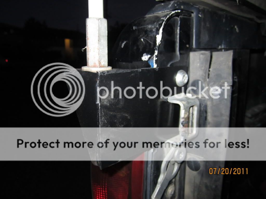

this is the latest creation. sand whip mount. im planing a trip to pismo this weekend.

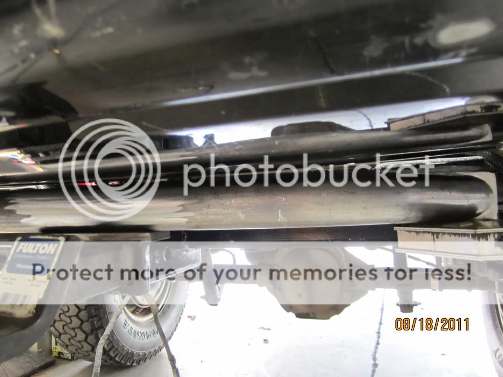

no problem. thats a good list but this is what i would change. (refer to the red)
1.bed cage from dixonbrosracing or camburge
2.deaver F-31 leaf springs
3.fox 2.5COLOR] shocks or 3.0 in 14" or 16" travel shocks
4. use stock flipped shackles and rear hangers

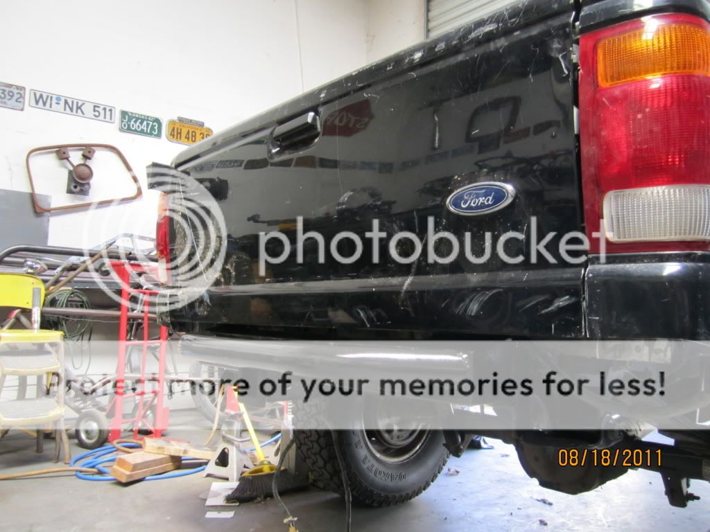

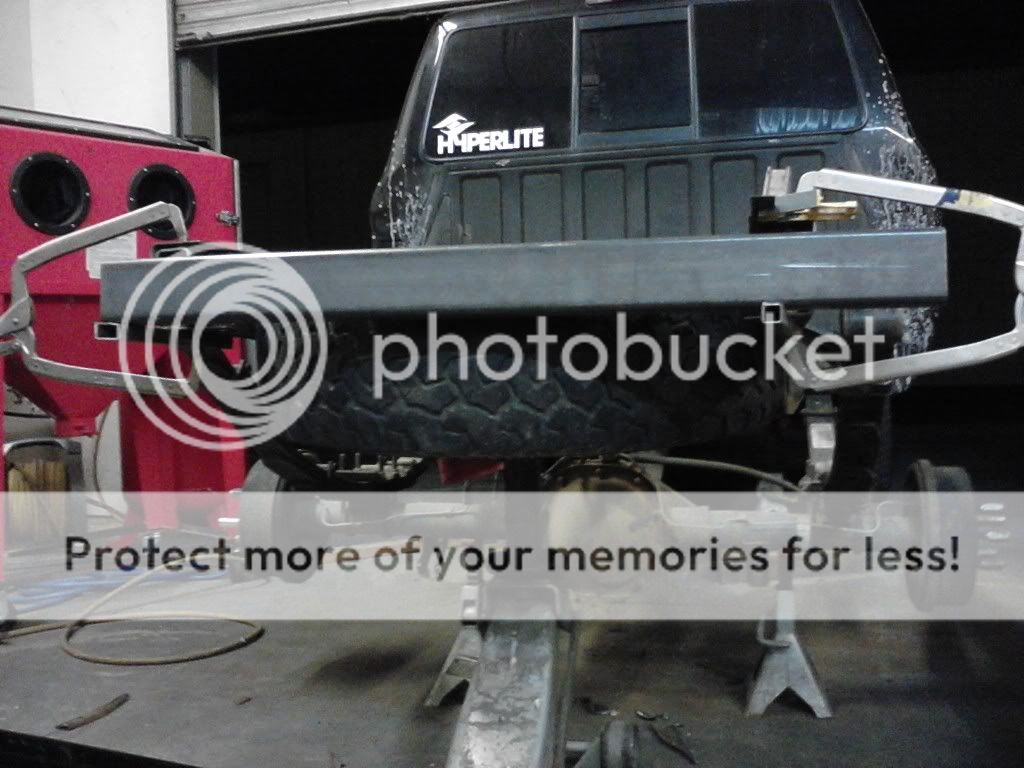

this past weekend i melted and burned new metal to the truck. im building a receiver/ bumper and making space for a 32 tall spare. future plans for the rear area of the fram to be for canti shock set up or fuel cell.
VV this is what i ended up with as of now.hopping to finish ever thing by weeks end.

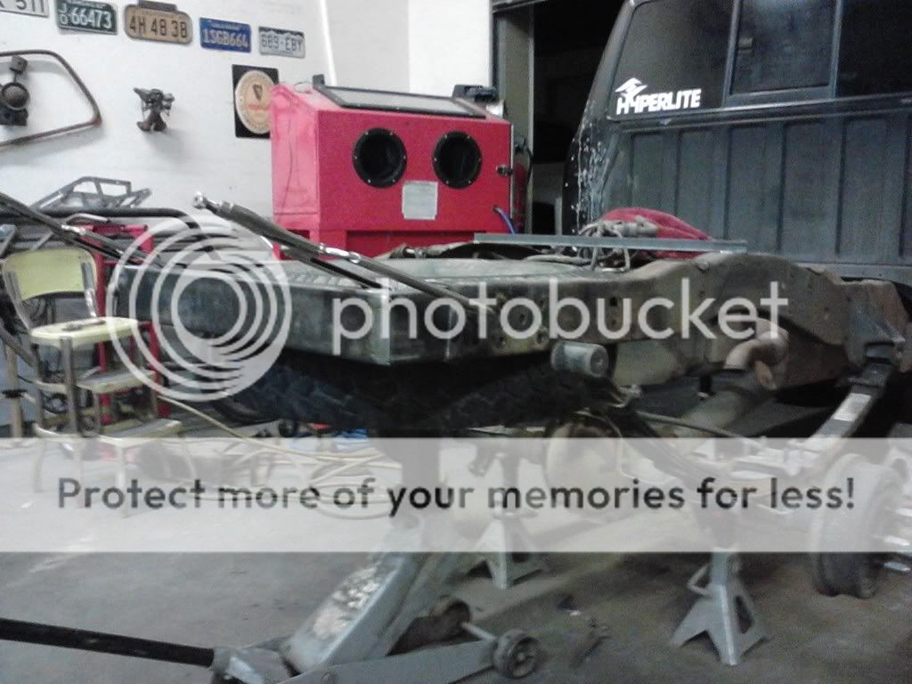

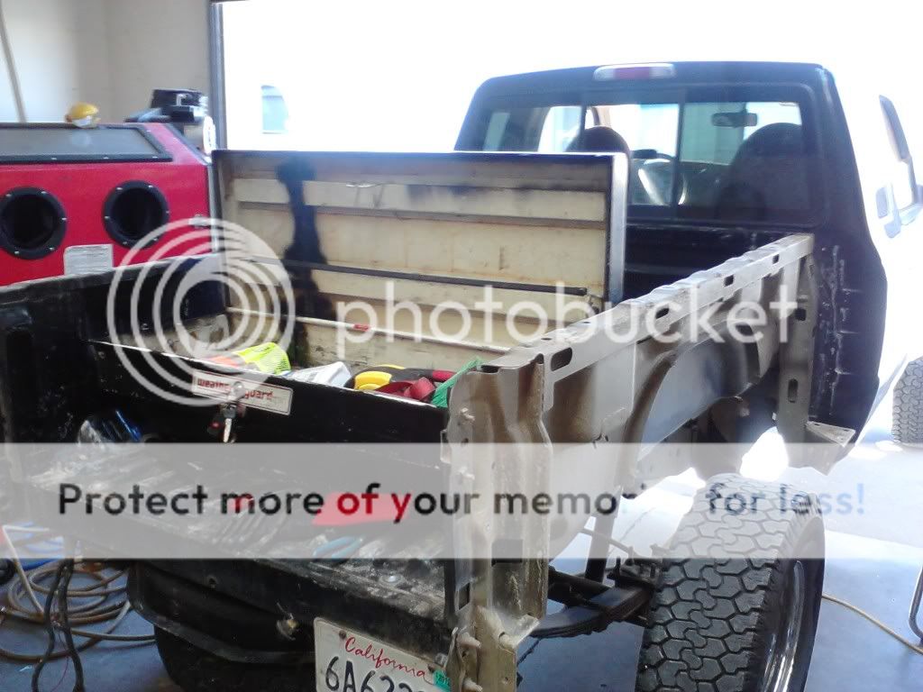

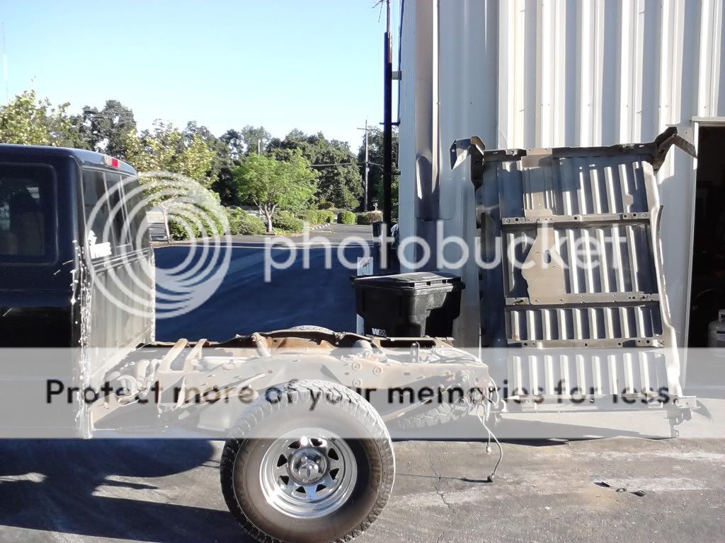

the bed is off.
Swick's Prerunner

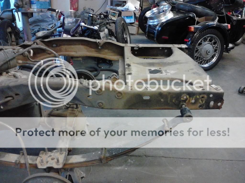

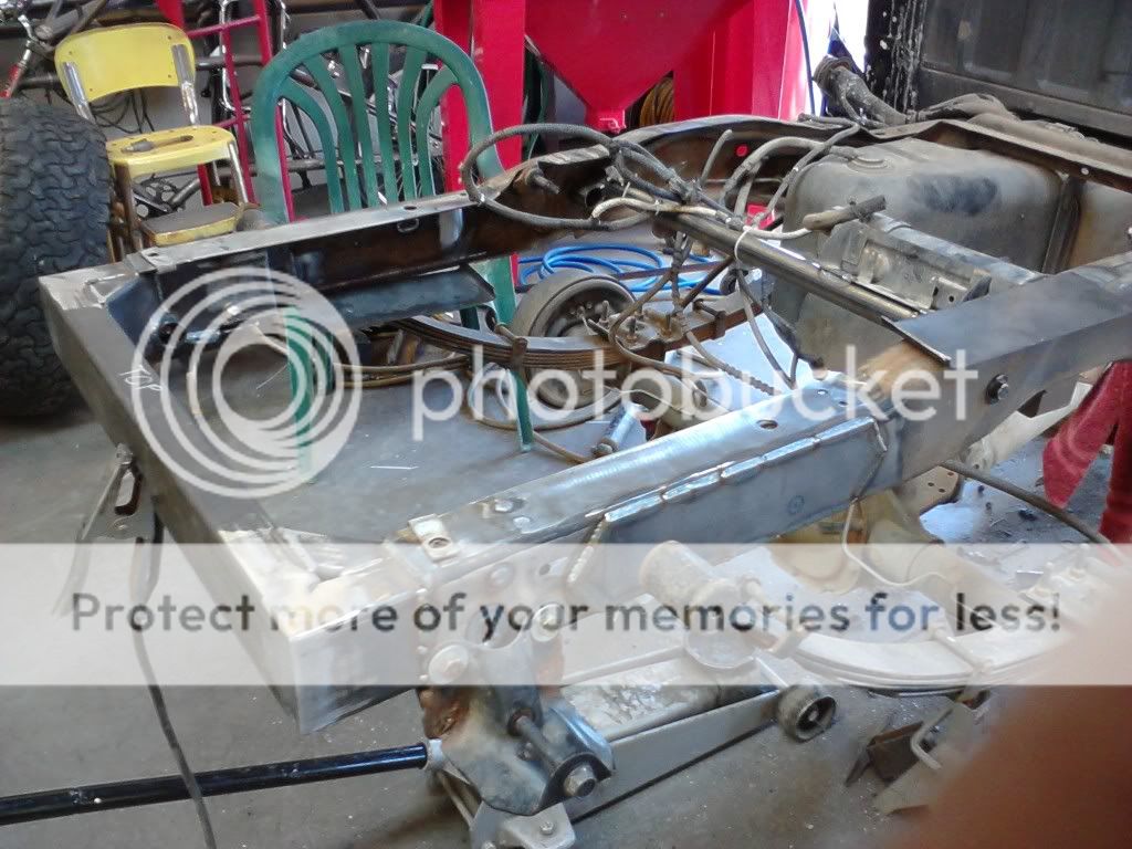

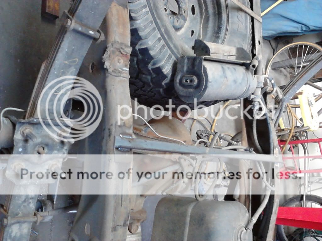

in the process of tear down. if i did not have the use of a plasma and air hammer i would have completed stage one.
Swick's Prerunner
getting an idea of what stays and goes.
Swick's Prerunner
Swick's Prerunner
Swick's Prerunner

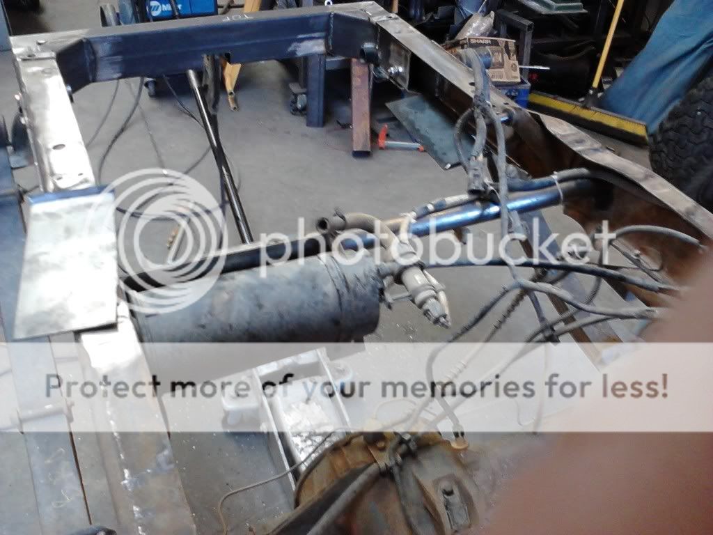

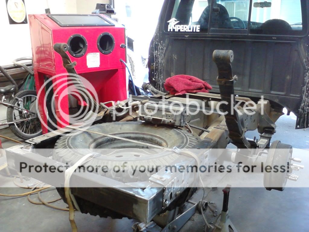

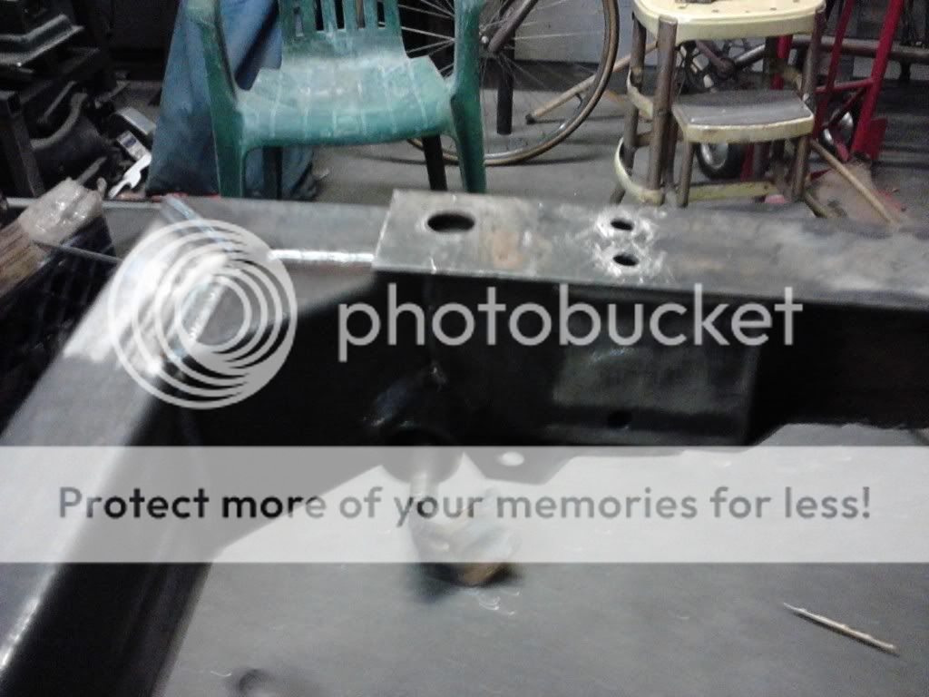

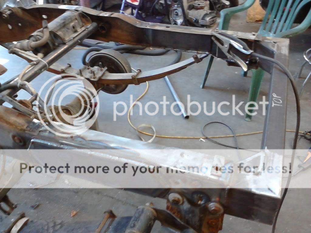

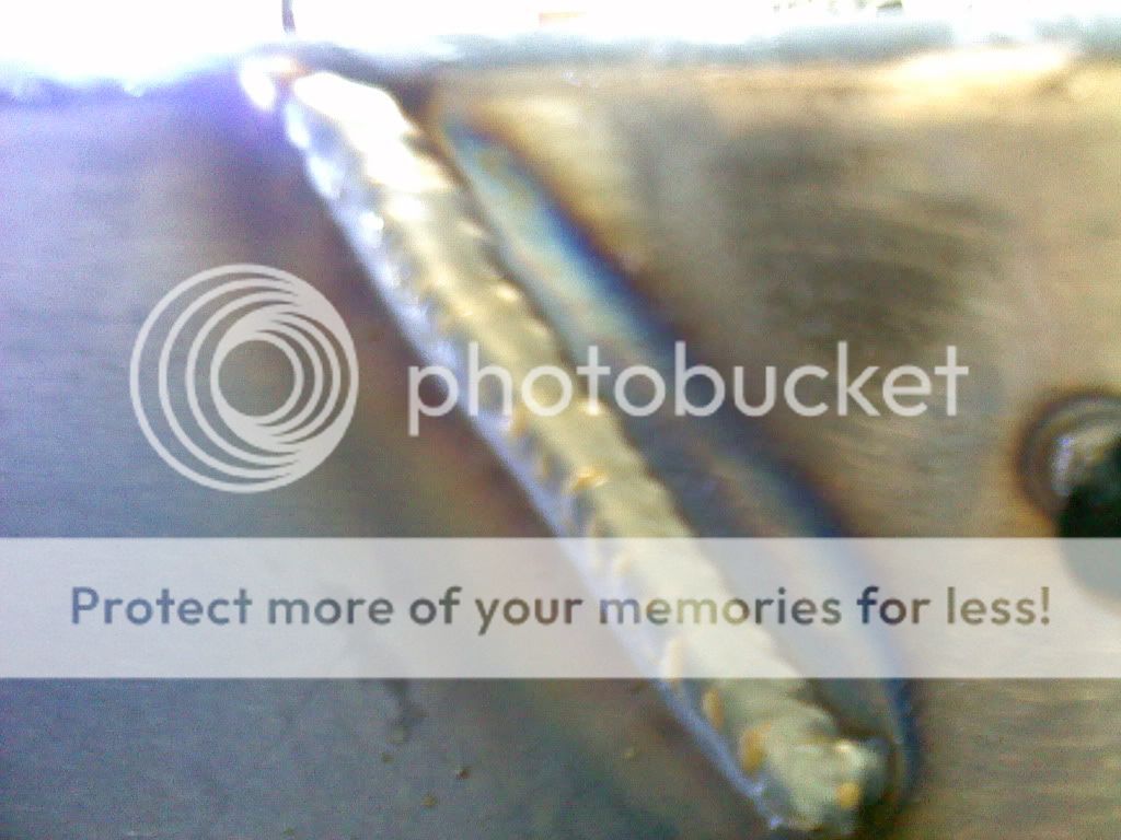

rear most cross member completed.
Swick's Prerunner
Swick's Prerunner
Swick's Prerunner

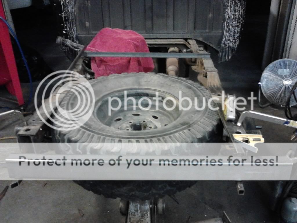

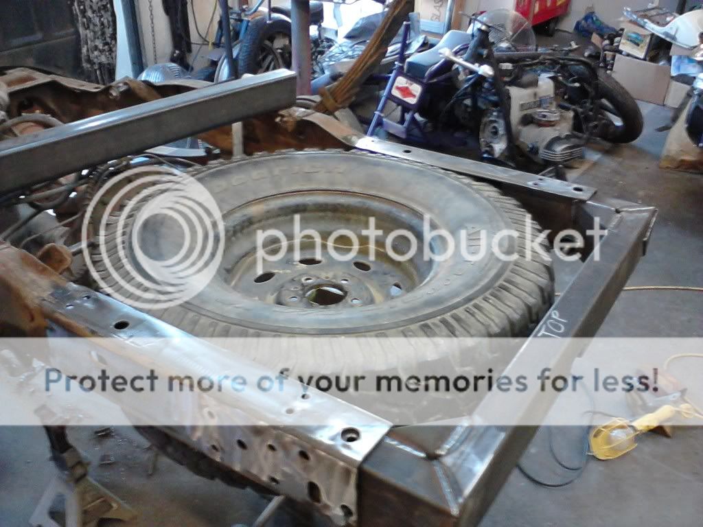

final mock up of tire and charcoal canister.
Swick's Prerunner
Swick's Prerunner
Swick's Prerunner

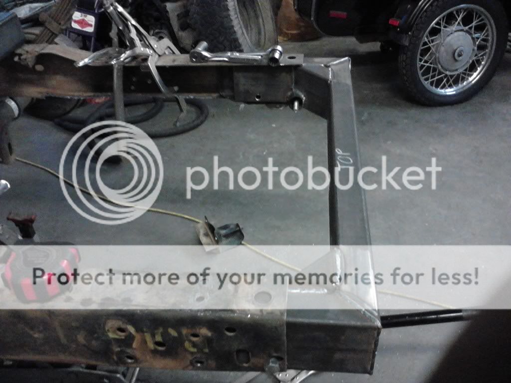

charcoal canisters new home. trimmed frame boxed and over laid with plate.

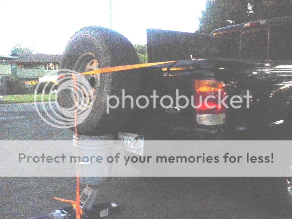

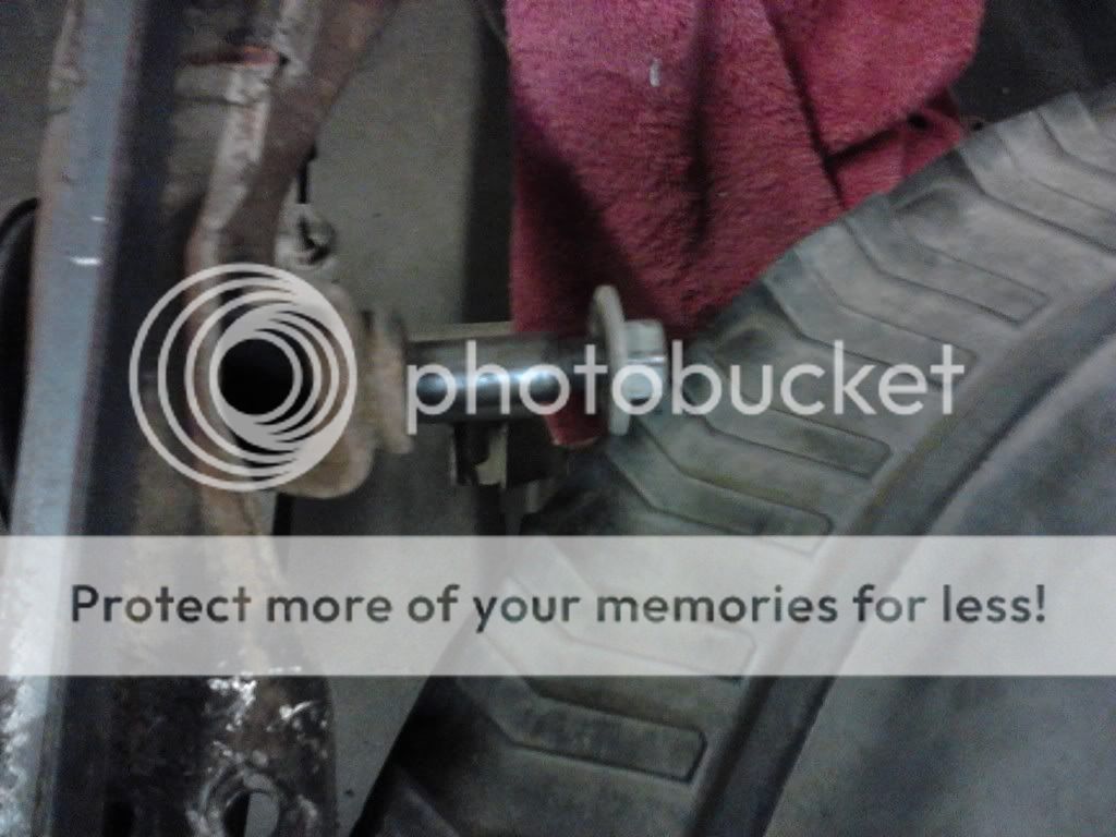

i been having thoughts on my spare tire placement. like mentioned above future plans are to canti and/ro fuel cell.
so the current location of the spare will be needed at one point or another.
this is what im thinking. spare tire gate that will hold a standing single tire, HF or HL jack, all weather storage box or jerry can. ( i do not have the other items). also bee thinking of a lowpro roof rack for the shell to hold a spare but im not liking the thought of lifting a 80lbs tire above my head.
Swick's Prerunner
My cellphone night shot turned day light editing.
so please share your thoughts and criticisms.

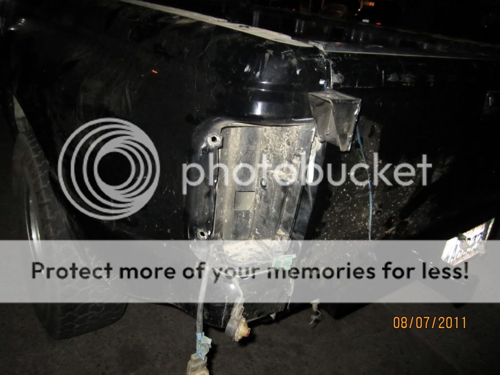

my truck suffered some carnage. i lost my driver side tail light which i recovered still intact but the light sockets did not fair well. my optima red top did not like riding in the up right position so it decided lay on its side for most of the time. looks beat to hell but the side of it is still solid.

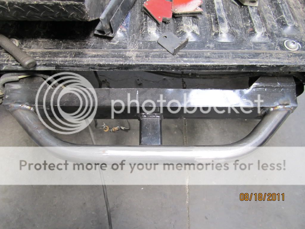

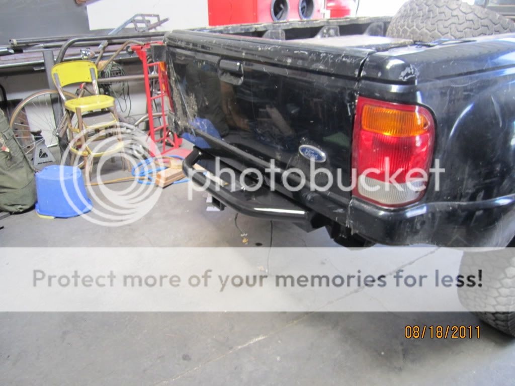

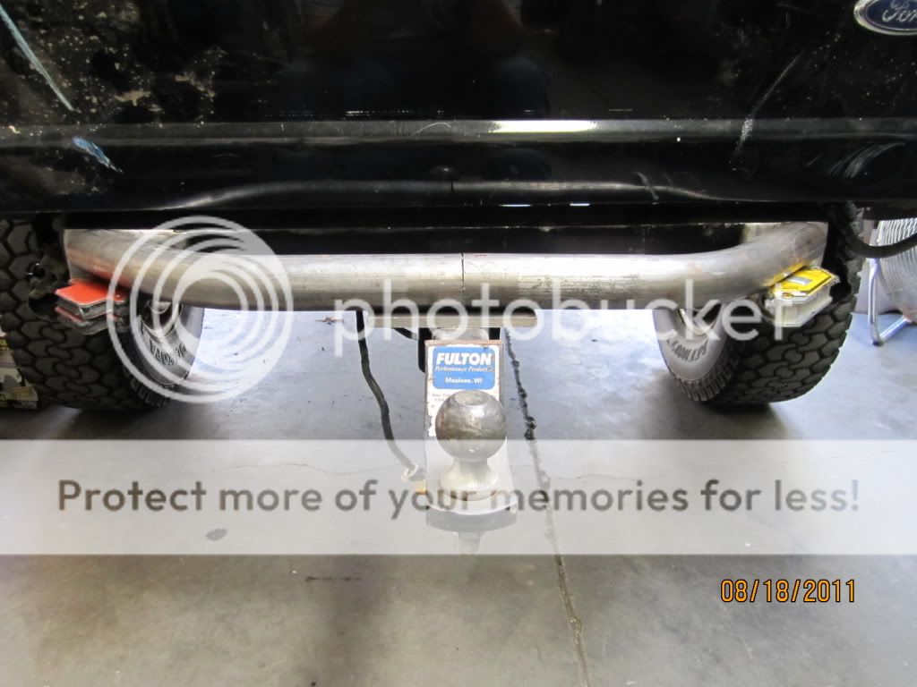

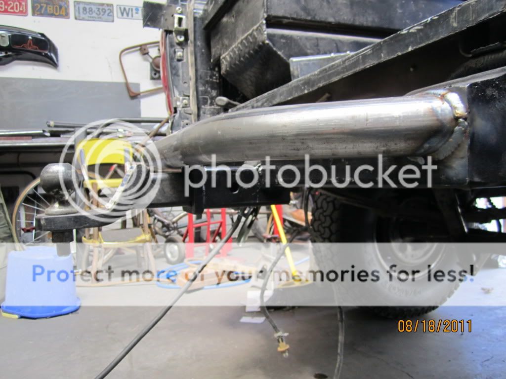

today i finished my receiver. next weekend i will make a bumper with tire gate mount.
Swick's Prerunner
Good progress. I like the bumper with hitch.

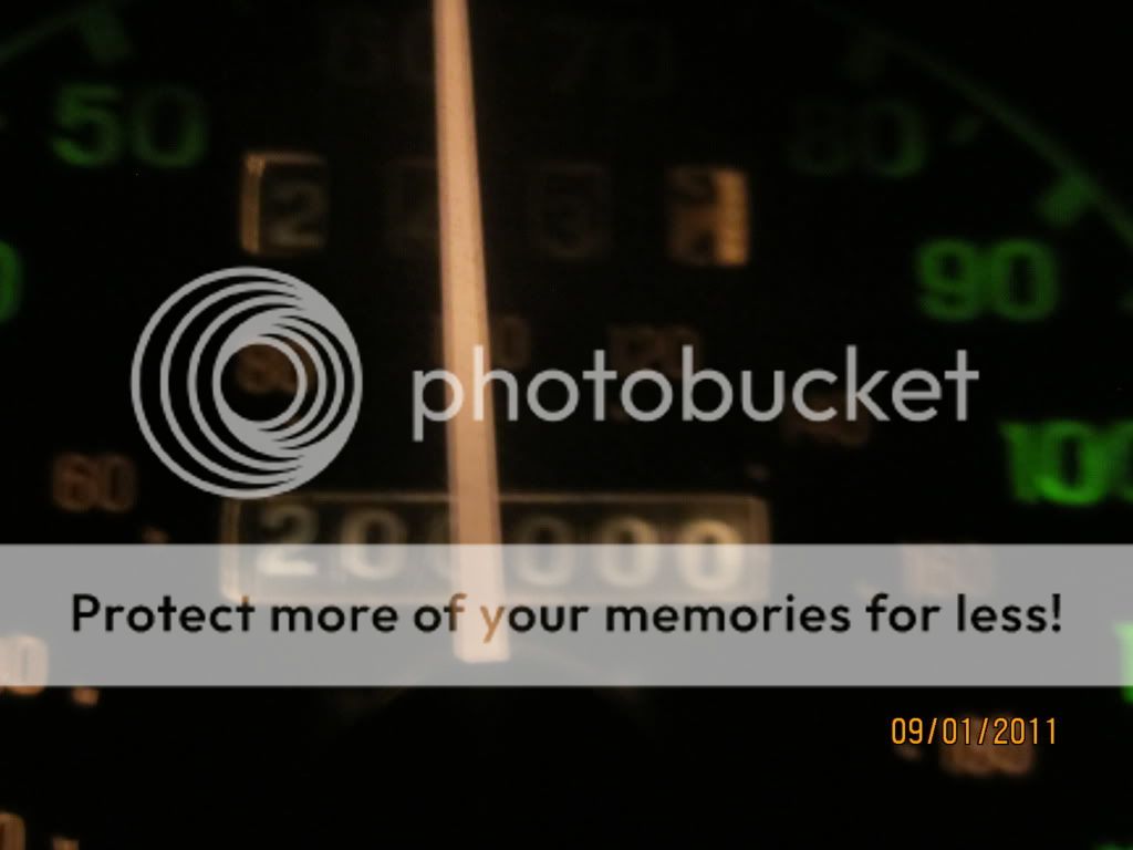

truck turned 200 officially a last night. if you do the math she turned 200 a long time ago.

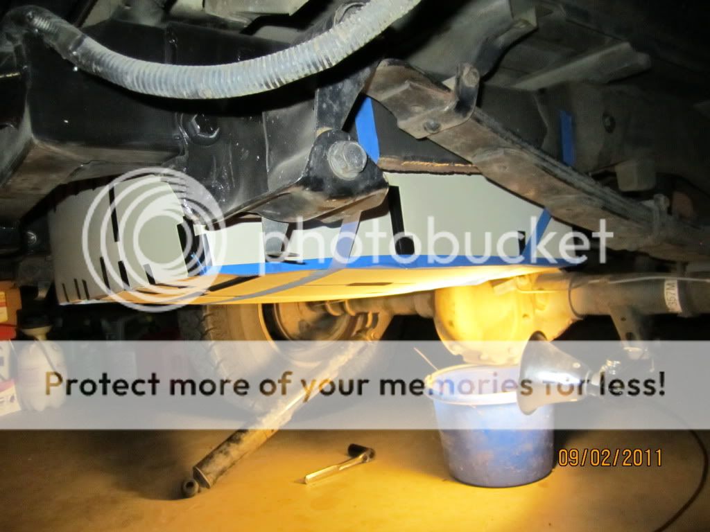

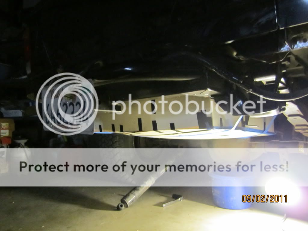

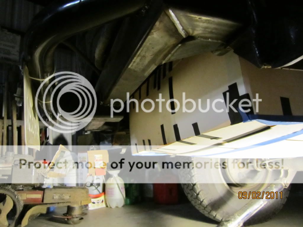

got bored today so i spent an hour with card stock, electrical tape, and a yard stick. mocked up a tank with the dimensions of 26"x26"x10" but slopes up to 8" at the rear portion of the tank.
Swick's Prerunner
Swick's Prerunner
Swick's Prerunner
Swick's Prerunner
there was one challenge that i saw with placing the fuel tank rear of the axle. that problem would be relocating the fuel fill tube and do so as clean as possible. it would have been supper straight forward if i had a fleet side bed. i would have done the same as the guy with the yellow straight axle ranger. find a jeep thingy at a wreaking yard.i mean the jeep thingy would work but would not look clean with the flowing lines of the style side bed. but i found a solution to this predicament. i will be using a fuel door off a 08+ sport trac. (refer to the image below to help visualize) from the naked eye the lines of the bed side of the sport trac follow very close to the ranger style side. i would like to get my hands on a contour gauge or card stock and scissors along with time to and put my theory to the test.
Swick's Prerunner
It doesn't appear to hang much lower than the stock spare....
