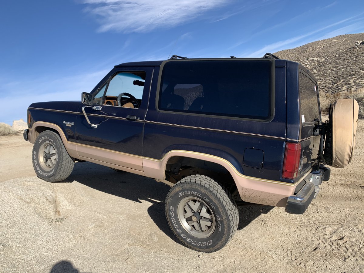

So I’m injured and don’t really feel like hittting pick n pull with a bad back. Does anyone know where to get a good set upgrades without killing my wallet? Not sure if I want to go to the Dana 35 or 44. Still torn between upgrading to 33” tires or 35” but from everything I’ve been reading it seems the Dana 28 won’t hold up on 33’s..

Very sharp looking BII. Lots of potential there.

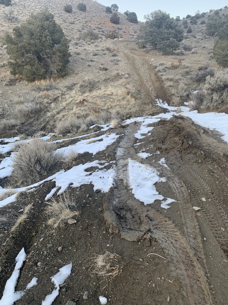

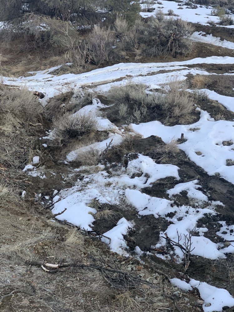

Have to say that after yesterday and almost rolling my little buddy that those D28’s hold up pretty well!! Rear end slid out on me coming down a snowy/muddy hill. I was able to wrench the wheels to the right before I dropped into a little wash out. Probably would have broke an axle if I wouldn’t have corrected as I slid. Second pic didn’t do the drop justice but it was a good 2+ft drop. Held up under the weight of being up on 2 tires and half way on its side. No damage to the body thankfully 😅!! Wish I would have got pics in that position but I probably would have rolled if I got out..
