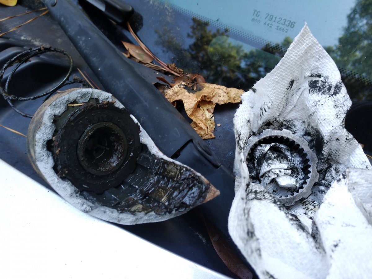

Well, with p235/75r15 tires I managed to blow out an OEM hub last year, now I have WARN, (see how those last) and in the past in deep snow with 235s I have managed to twist the ears off the pass. side drive shaft. The first one, I was pulling about 3000# of trailer off road, so, that did not help at all.
