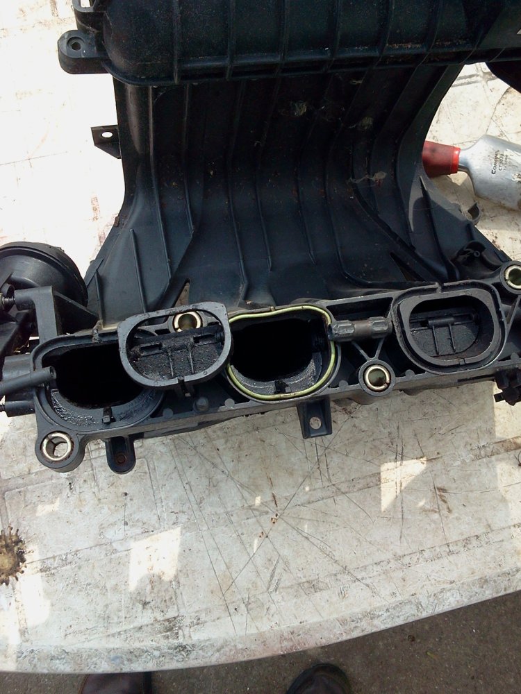

on a 2002 manifold the flappers come in separate housings.
the housings are needed to form the channel for the green intake port gaskets, and to match the shape of the head ports.
they also locate the bushings for the square shaft.
there are several bushings, small at the actuator, larger between the runners.
the flappers can be removed from the housings. caution,,the housings are a bit fragile.
then put it back together and the PCM will be happy.

It looks like the newer manifold is the same from pics, minus the flaps and it's axle....even has mounting holes for the IMRC...was going to mount it where it normally goes, and just have the little arm control "nothing" looks like the ports are the same, uses same gaskets I think. It obviously doesn't need those plates, or they wouldn't have stopped using them, lol

the later one has a wierd funky fitting on the back for the pcv valve, but other than that they look identical minus the flaps...even has the mounting hole for the vacuum control for the flaps...I'm thinking just mount the vacuum control, and let the computer think the flaps are still there, and live happily ever after, lol
that weird funky thing is where the 3 hoses attach. it's removed with 2 screws for easier access to the hoses.
the big hose is the vapors from the PCV , 2 smaller hoses are coolant to heat the tube where it enters the intake.
the actual PCV is mounted on the oil separator.
