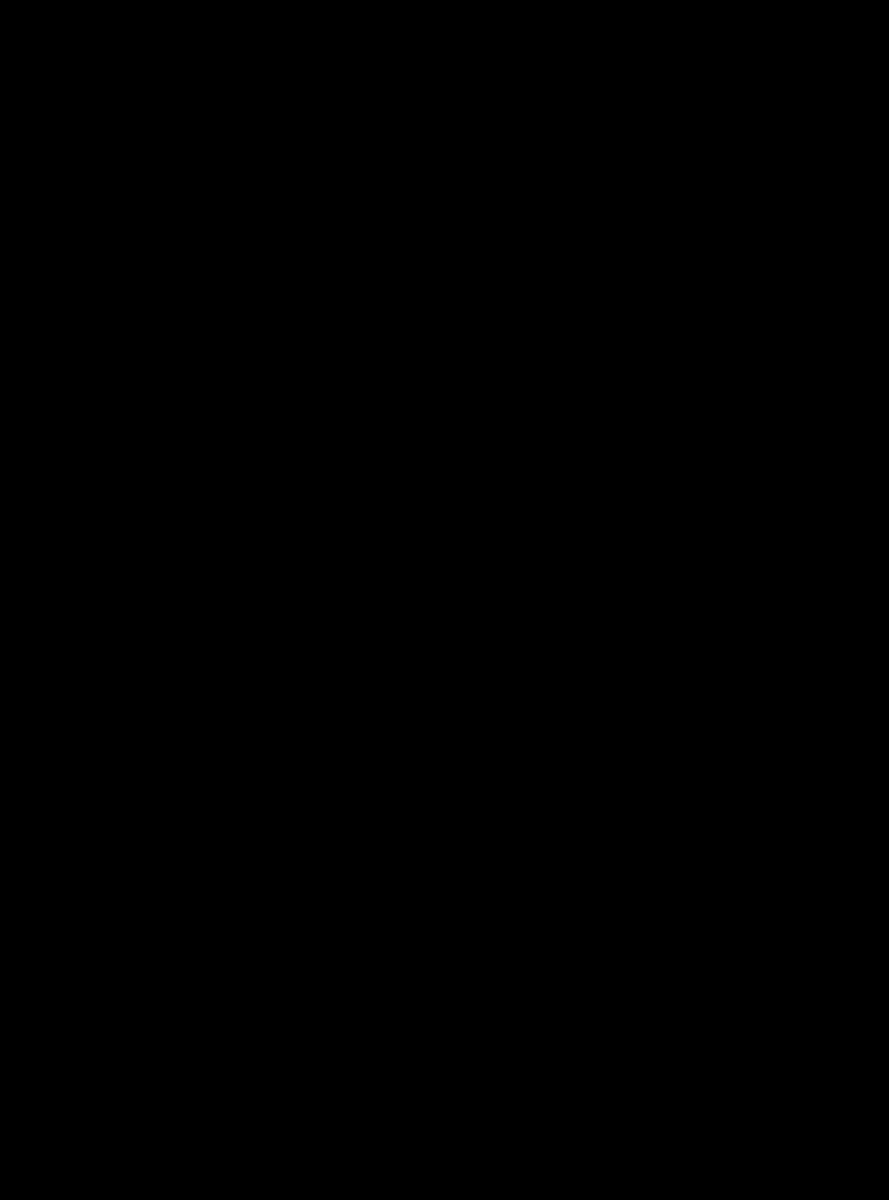

These are pictures of the 2003 intake with the imrc removed. Then all I did was seal off the individual intake ports with a plastic welder which you can pick up at harbor freight for relatively cheap. Also JB weld will work.

Well I see the pictures didn't upload so I'm not too sure what's up with that I'll have to see if I can get it figured out and try to repost them.

Okay yeah then this would definitely apply. Like I said I'll try to get the photos up as soon as I can I did send a message to forum to see if they possibly knew why the photos are blacked out.

So close yet so far… pretty sure the minimum post count for DMs is 10 because we were getting too many spammers blasting out messages. Might also apply to pics or there might be something else going on there, not sure on that one.
