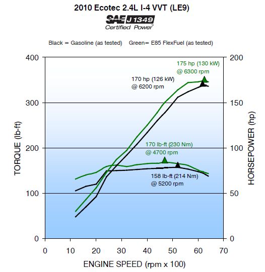

Here is a 2.4 VVT Ecotec which s a serious piece of 4-banger hardware without a turbo--these are SAE installed ratings--if your 2-valve, pushrod motor is carved out and cammed to run 9,000rpm it would have a hard time sucking a ladybug into the intake at anywhere a pushrod 4.0 can spin at--there's too much port area for the air with that small of displacement and low rpms.

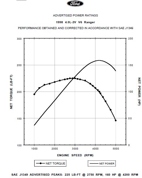

This is the simple and unsophisticated pushrod 4.0--it's just so big that it can't help making torque--there's 200ft# right off of idle. Not much power there, but these are great for doing things a field truck needs to do. It's the exact opposite of your race 2.3--small valves and ports, lots of displacement, lots of low-rpm airspeed. It's a truck motor and was never put in anything but a truck.
Swapping a 4.0 to a 2.3 carbed
  • Swapping a 4.0 to a 2.3 carbed
