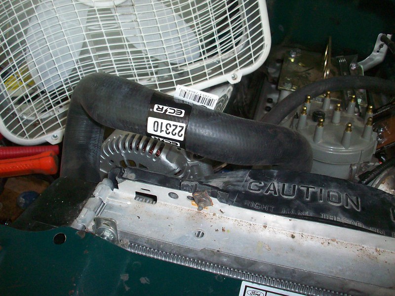

Hose Setup:
Cut and trimmed 4.0 Explorer upper hose.
Swap Radiators
I believe the lower hose is from a 5.0 Explorer, cut with a splice.
Swap Radiators

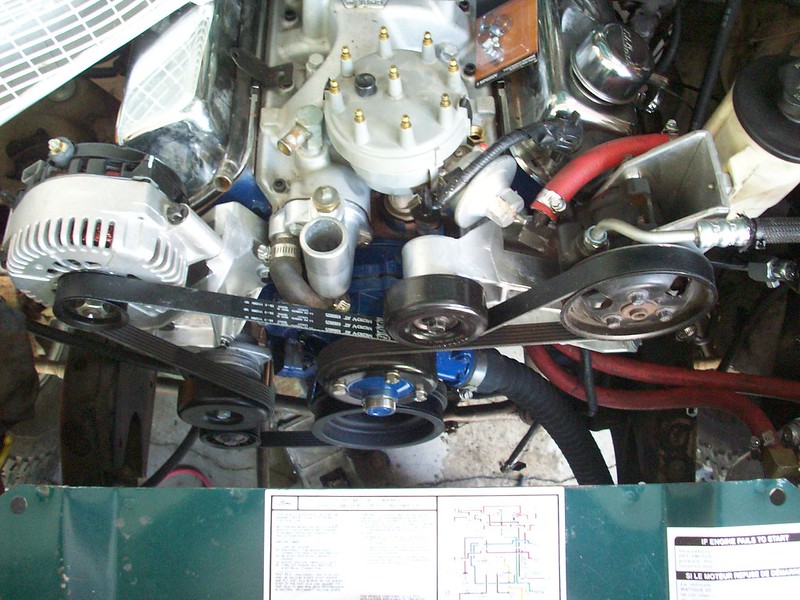

Belt system?
95-01 Explorer
Swap Radiators

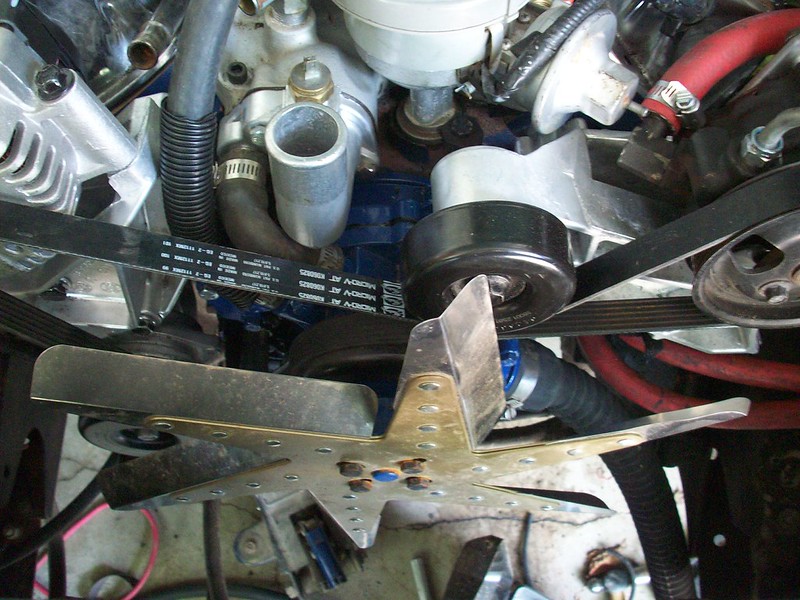

Fan setup?
Low profile flex fan
Swap Radiators
And two A/C condenser fans for a Mercedes C230 Kompressor for pushers
