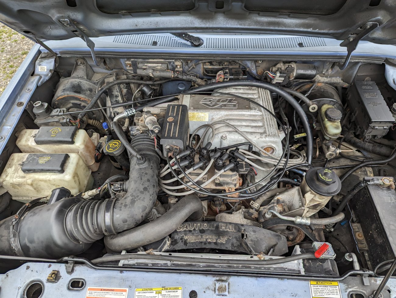

I am running a factory single core 4.0 rad in my 97 Ranger with an Explorer 5.0. All factory Explorer accessory drive including the clutch fan. I only have a small shroud on on the top of the rad from a base model 80's non A/C Ranger. The single core rad still has a thick tank on the driver's side, so that and the top shroud make up 50% of a normal shroud .lol
Swap Radiators
I have zero cooling issues. It runs right around 195* with the AC on in 100* heat. If I beat on it for 15+ minutes at slower speeds it will get up to 205* and then cool back down soon after.
I think I just used 4.0 hoses upper and lower after deleting the water/oil cooler on the 5.0
Only tricky part of my whole setup was that I had to trim down the OD of the metal fan blades by about 3/8" to clear the radiator tank....method shown below.

So, the Explorer radiator I have is roughly 25 1/2" square to outside edge of the tanks and about 3" thick. Plus mountumg tabs and stuff hanging off of all that. That means, with the top edge aligned with the top of the core support, it will hang down between frame rails and interfere with the front cross-member. It just barely fits between the frame rails, by "rough" tape measing. Either I have some major cutting and fabbing to get that in there or I need a different radiator.

I didn't read through everything, but I learned the hard way that the 95+ Explorer rad does not fit between the frame rails of a 94-97 Ranger. Now what I dont remember....is if it was because of how I boxed mine...or if the factory frame horns had the same issue.

I Measured the frame more accurately. Frame is 1" narrower than the radiator.
