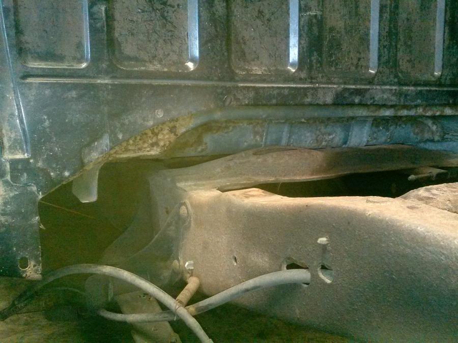

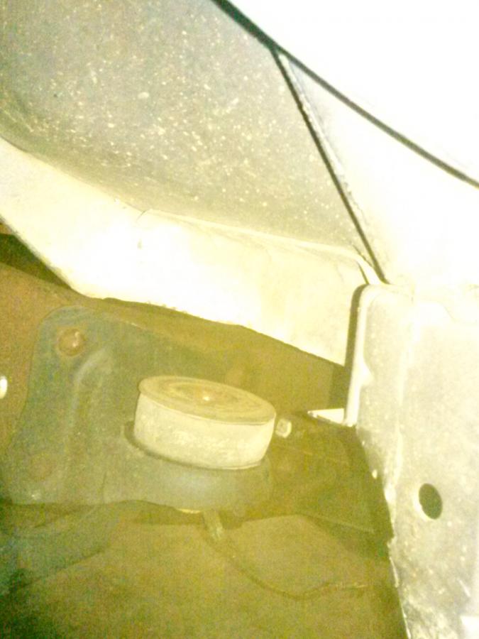

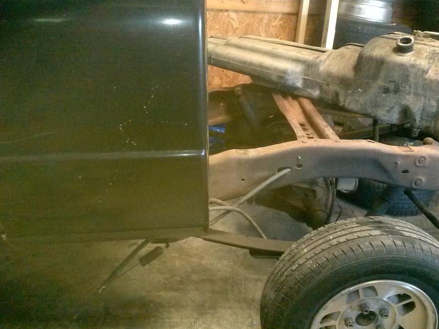

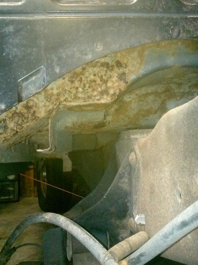

Issues with using the SuperCab on the regular cab I see are:
1. Back of the cab is too high. Even relocating the rear mounts won't help because the frame rises too much. So, I'd have to use a 3" lift on the center mounts to even bolt them, and then the cab would sit with a lean down rear to front. Using a 3" lift on the front mounts would probably level the cab, but the middle brackets would have to be raised up.
2. Rear mounts have to be relocated to basically where the front of the leaf shackles are mounted. I think I could make it fit.
3. cut out the floor of the cab behind the seats and raise it up to lover the cab in the rear. Haven't really looked at it but probably doable. Plus, the rear cab mounts would have to be relocated up as well to clear the frame. would probably have to hack out about 3-6 inches of the back wall of the cab and move the floor up the same.
Will try to get some pics up tomorrow or weds to show what I mean.
Oh and the front I-Beam going to the driver's wheel is bent with a curve to the front and I'm pretty sure the other beam is bent(front wheels are splayed out). However, the frame looks straight so I think it is repairable with some parts.......
The 1st pic shows where the rear cab mount on the reg frame is in relation to the Super.
The 2nd pic shows the back of the Supercab in relation to the back tire.
The 3rd pic shows how high the supercab is over the center cab mounts now. didn't measure it but looks like 3 inches.
The 4th pic shows the bottom of the Supercab sitting on a crossmember. You can see that the cab mount has to be basically where the front leaf shackle is.
Like I said, I think my only option would be to cut the floor of the cab out and relocate it up about 4-6 inches so that the rear mounts of the supercab would level out the cab.
Or I guess I could also move the mounts forward a few inches to clear the shackle mounts as well at that point.
Or maybe I could remove that crossmember(since the bed would be custom built anyway) or relocate it down to the bottom of the frame. That might improve the height issue.
If I lowered the rear cab mounts when I relocate them after removing that crossmember it might be a better fit......dunno. What you do guys think?
Oh, and I towed it about 45 miles with just the 2 front cab mounts bolted and a ratchet strap around the center of the cab floor and frame(you can see the strap in the 1st pic in front of the tire at an angle.). Didn't budge a bit when I was towing it.
