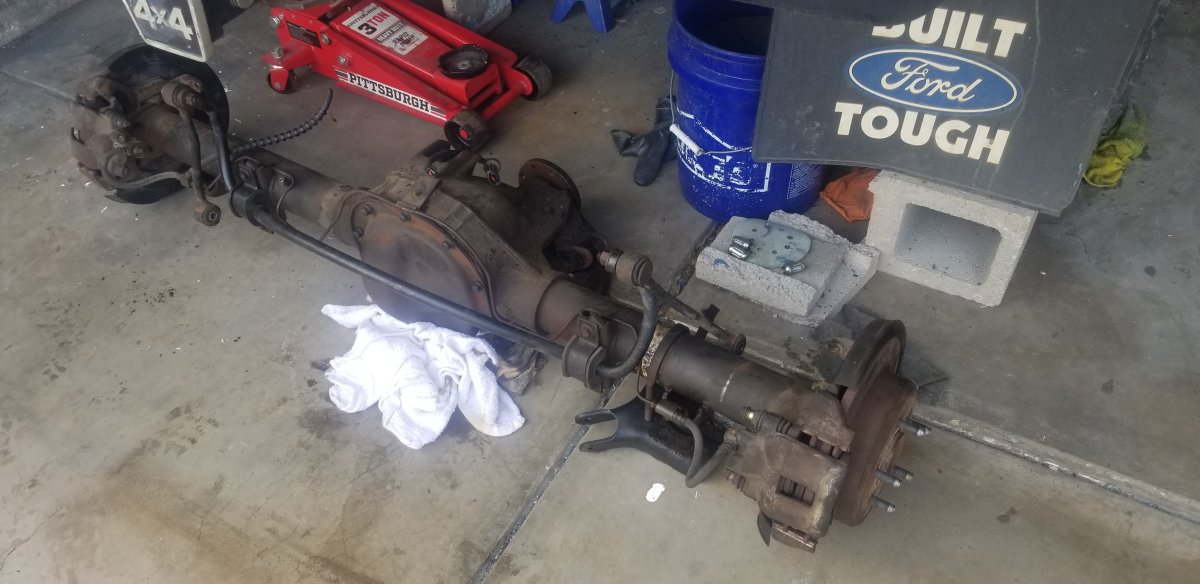

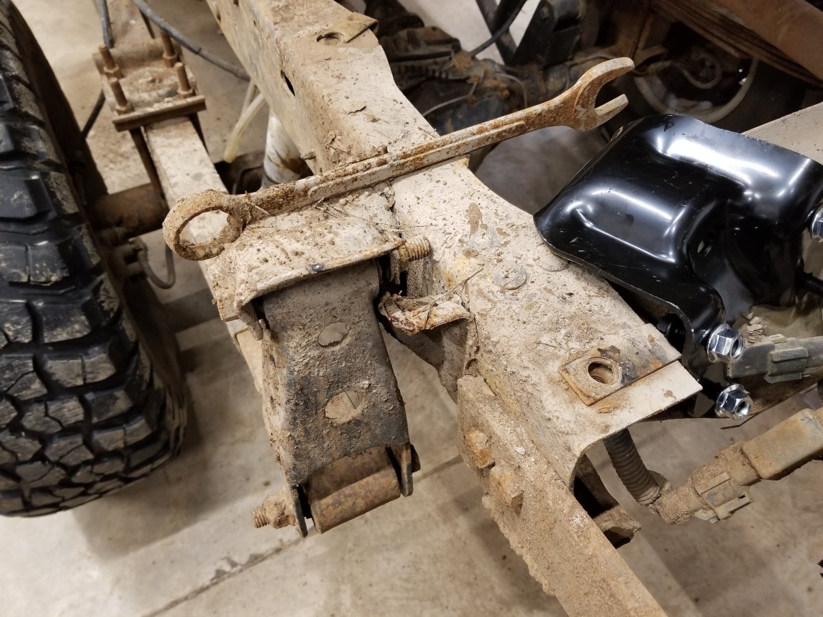

Got the 8.8 from a 97 Ford Explorer with a D4 axle code. Should have 3.73 LS. Pulling the axle was a pain lol. now I'll have to get the leaf perches, a driver's side strut mount or reuse the ones of the axle. Weld everything together and make the sure the pinion angle is good leaf spring wise. The strut mount positioning is not very clear to me yet.
