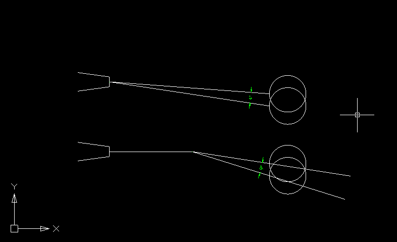

The angle of the driveshaft doesn't change at the same rate when the driveshaft is 2-3x longer.
However the 2 piece driveshaft is less likely to be harmed offroading because it doesn't hang down as much.
I quickly drew up something using no real numbers to kinda show it, if you extend the rear "driveshaft" to be as long as the other one the change is easier to actually see (second pic)

the angle of the drive shaft isnt what causes driveline vibration
If the t-case is at 5* and the diff is at 5* with a one piece, you have to get really wild on the lift for the driveline angle to matter.
