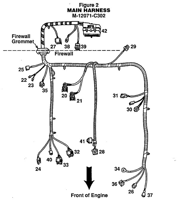

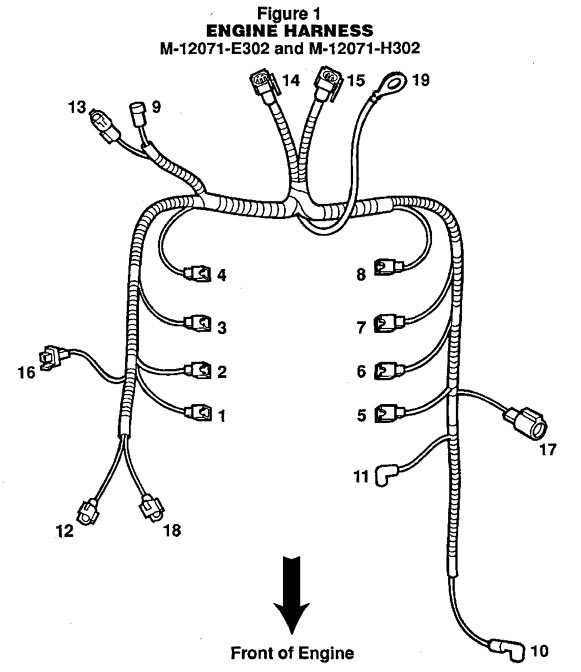

only if there was lost over this page One not that bastract diagram like these:

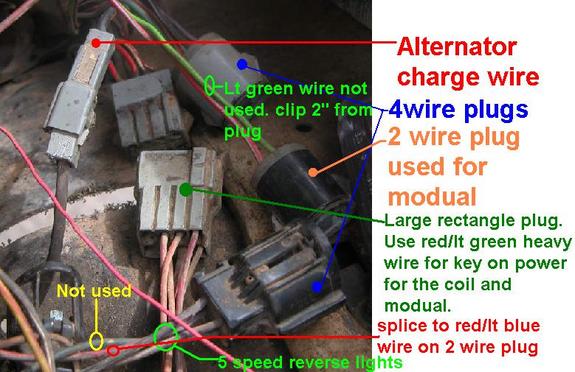

would be ideal to see some photos indicating the connectrs an it's fucntion like this picture but mor specyfic:
