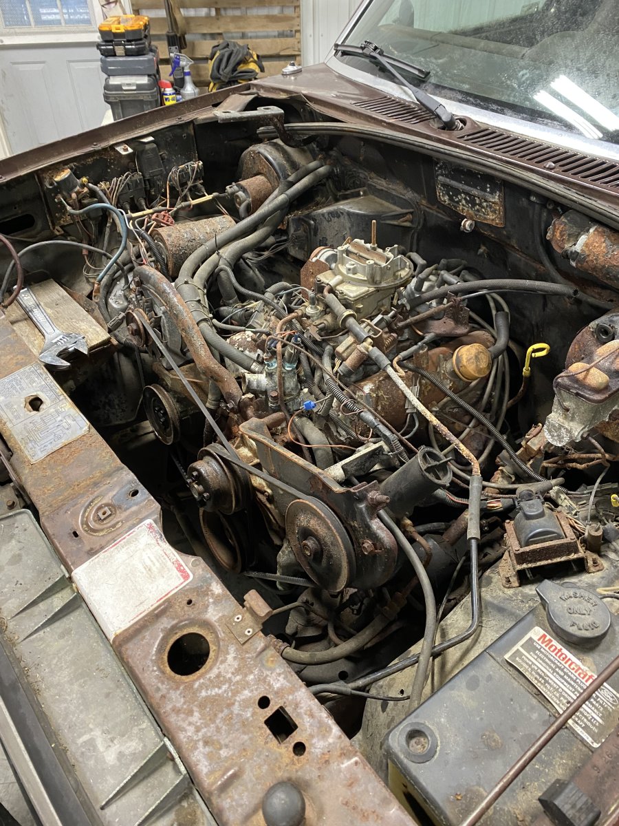

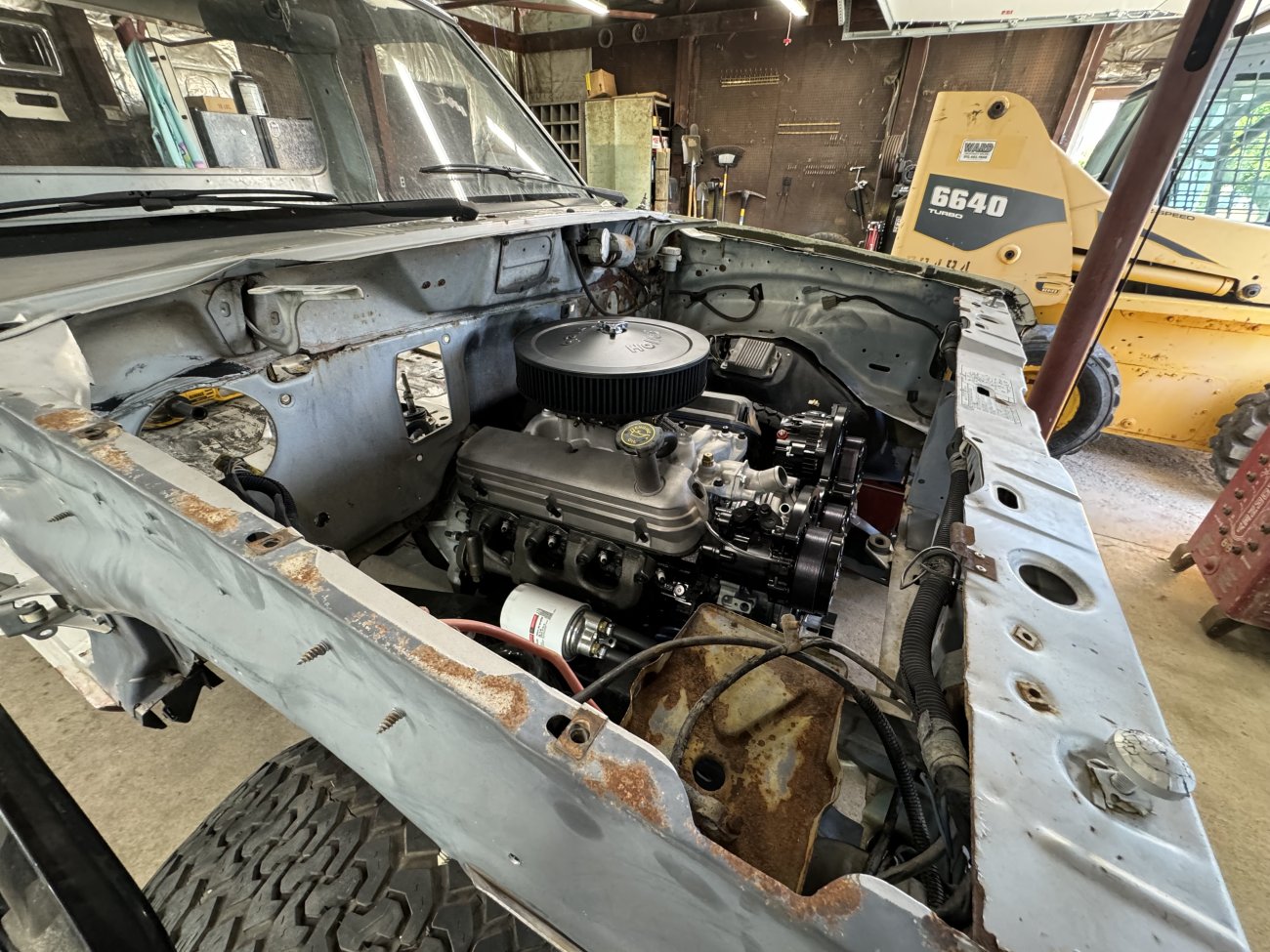

Here’s a peak of my engine bay preswap and after
I deleted everything over there. But the starter relay (judging by your belts you may have a voltage regulator over there too.
All the rest is junk for your 2.8 that you won't use.
