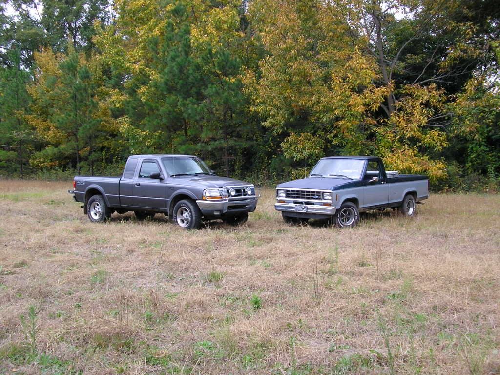

Here's a slightly more practical comparison. Both of these trucks are mine. The one of the left is a stock '99 Ranger Extended Cab 4wd. On the right is a stock suspension (with 21 years of sagging) 1984 Ranger regular cab, long bed 2wd.
There was only a couple inches difference in ground clearance between the two trucks. That 84 2wd went nearly everywhere I took that 99 4wd, before the 99 did it. The only thing affecting ride height on the 84 was tire size. I was running a taller and wider tire than stock that fit the wheel well much better. The only changes that I ever made to suspension were sway bars on both ends and air shocks to level the truck for the few times I ever really carried a load. I can honestly telly you that that 84 carried heavier loads in its life than that 99 ever did. It also rode better and handled better than most other trucks I've ever driven. Unfortunately that made me cocky after I upgraded to 16" wheels, which resulted in the demise of the truck.
Honestly with the condition of your truck (pretty good for the age) and drive train, I wouldn't lift it or a lot larger tires. I'd start with doing what I did. Fill the wheel wells more. Put sway bars on it. If you need to carry a load invest in some air shocks. Save your money for a better lift and upgrades later on. One thing that no one talks about when installing those larger tires is the added wear and other supporting mods that come after adding that lift and larger tires. All those things cost money too.

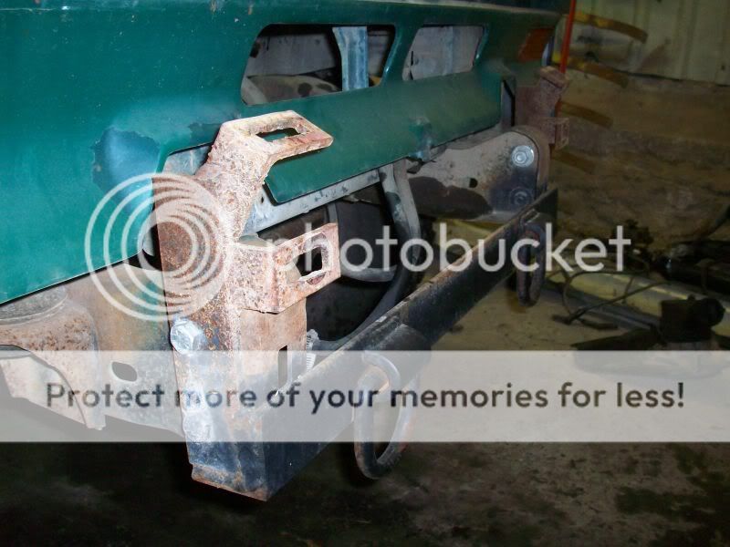

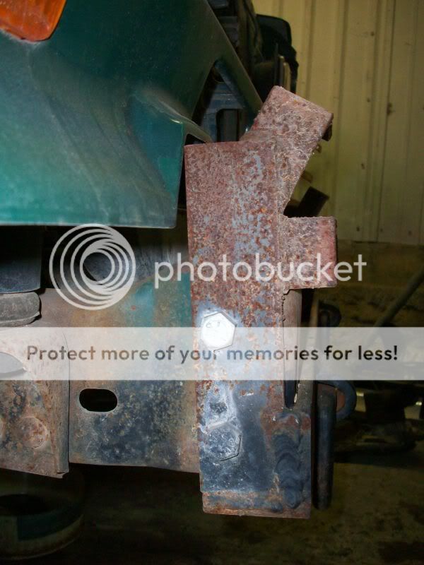

Yes you can just make a bracket. Don't hold me to its strength but the stock bumper really isn't anything to brag about for strength either. If anything I think it would be stronger with a hunk of angle iron of your choosing (mine is 3/8") tying the two frame rails together than the thick sheetmetal of the stock bumper. The bumper sits out a tad farther than stock and I cut about 3/4" notches in the bottom of it.
With a standard cab there isn't much of the frame to see, the frame is narrow so unless you also get a suspension lift it stays tucked under the cab fairly well.
Trim the airdam to fit around the angle iron to clean up the looks a little and I don't think it came out too bad... and you can gain the sorely need towpoints that Ford never graced a first gen with.
