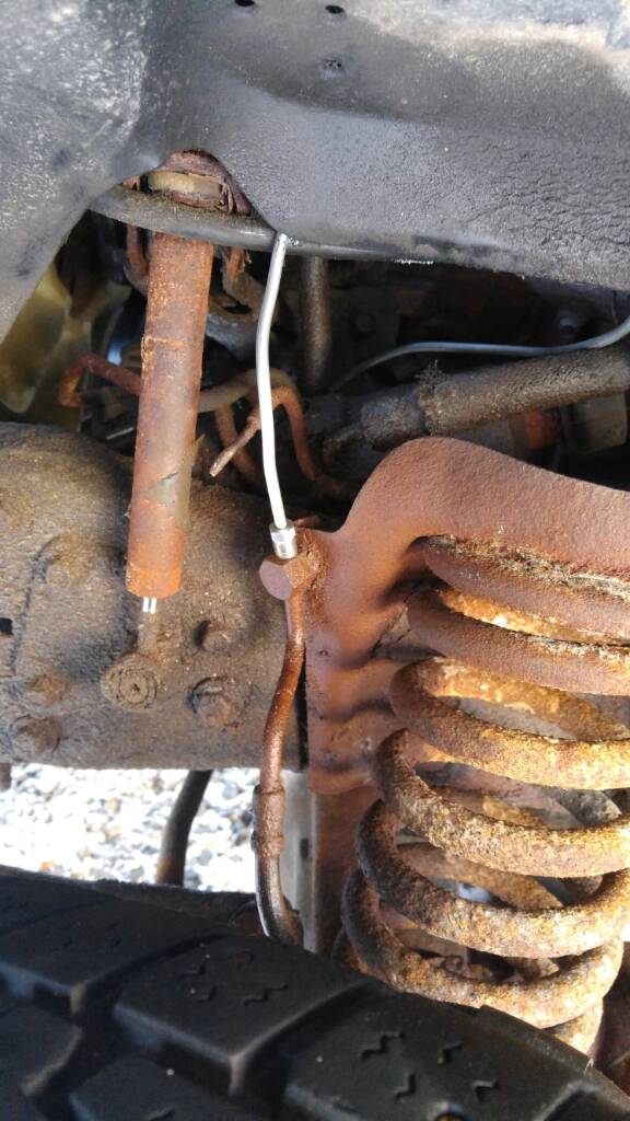

So i managed to get a new line ran over from the proportioning valve (see image) over to the passenger side caliper (this is the line that had rusted out). This was a huge pita magnified by -20 degrees and no garage. The coupling on the passenger side fit together no problem. Of course, this went too easy and nothing on this truck can take just one day - the coupling in the pic wont start threading. I bought a brass union just i case I needed it - and the old connector fits fine into said brass union - the new connector fits fine into said brass union but be damned if the new connector fits into the old proportioning valve. I spent three hours trying. How is this possible? Any tips on getting this thing to screw in? Any work arounds?
