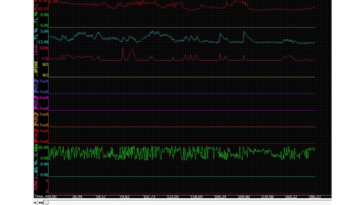

Attached is a screen cap of the Forscan log I did this morning with the truck at rest in the driveway. The only anomalous reading was the short-term fuel trim which ran -5-10%. I think this could be due to the misfire causing unburned fuel to go into the O2 sensor. I'll know tomorrow anyway. I wonder what other items I should run on the forscan log to get a better diagnosis.
Installed new coil pack. No change. Still misfires under load from 1800-2500 rpm. But while Forscan and I can both see and feel the misfire, it doesn't throw a code. Smooths out when I get the revs up. Still running rich. Now the mystery begins. Unless someone here knows what I should look for.
I'm going to start with checking for an exhaust leak, then try a compression test. I suppose changing the plug wires should be done to rule that out, but this set isn't very old - not more than 2 years and less than 10K miles.
