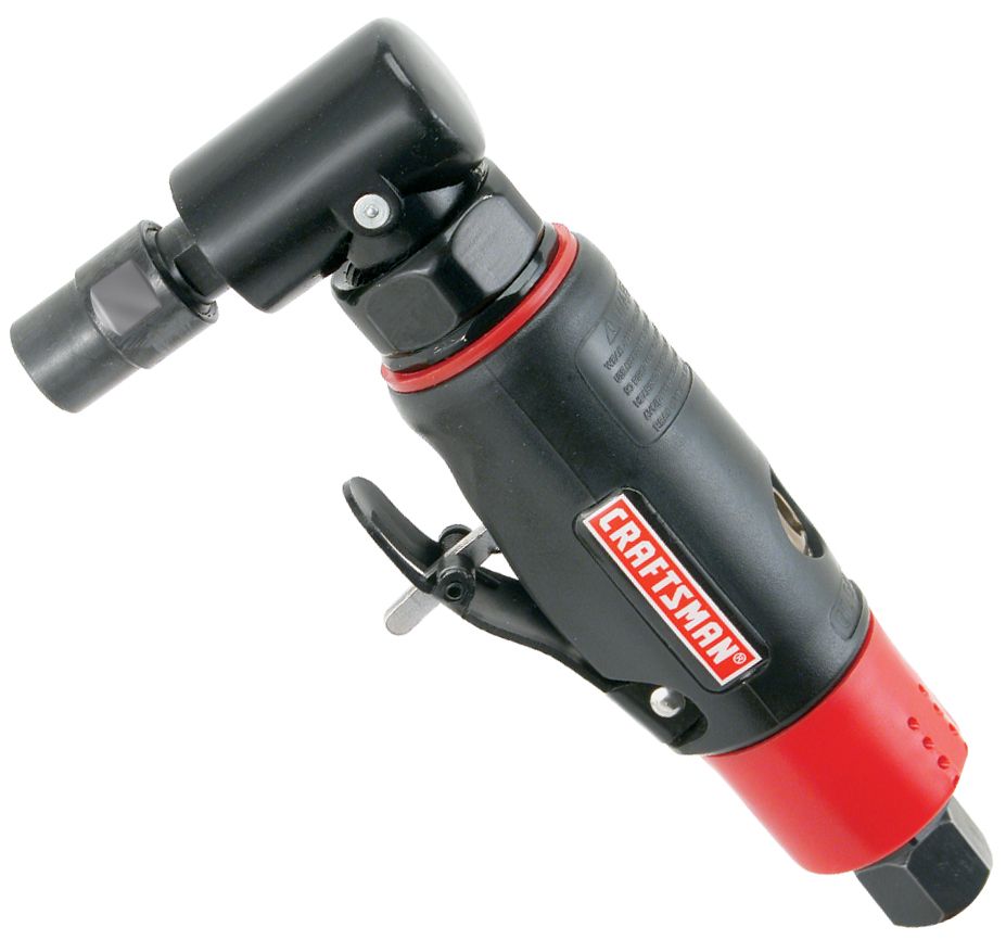

But, I've found the easiest way to remove rivets is to cut an X in the head with a die grinder, then chisel or grind the head off, then punch it out the other side.

If you cut an X in the head first, it takes 1, maybe 2 blows from a hammer and chisel. (I use a 3lb sledge)

Something like these:
00919951000
I do not have access to air tools, nor can I afford any. Basically I'm working with the few tools I've been slowly buying throughout university, being a 14.4V drill, 4.5" angle grinder, and good wrenches and a good 1/2" socket set.
