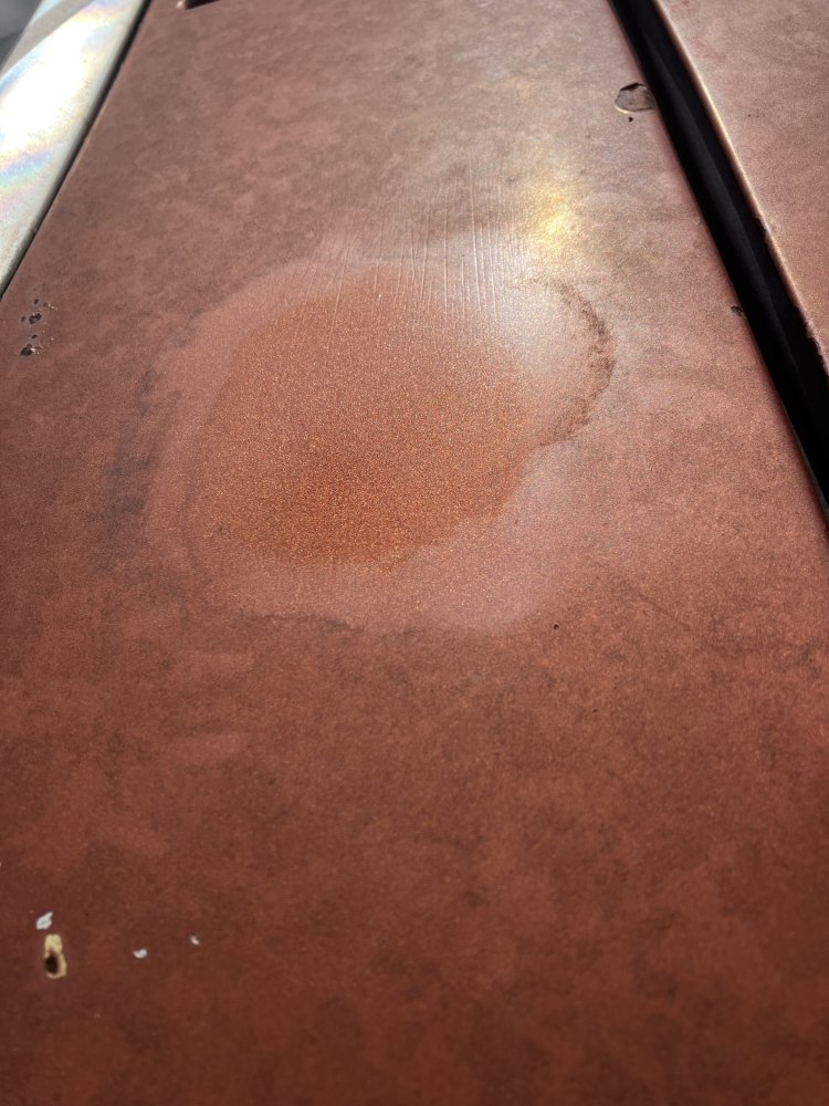

Results are in:
1994 F250 has no clearcoat. I tested a few spots and the white paint rubbed off. It is also chalky everywhere, oxidation I assume.
1983 Ranger I believe had no clearcoat from the factory. The driver door and pillars are shinier than the rest of the truck so it probably had bodywork done at some point. The towel turned paint color everywhere else. I will say the coppery metallic paint looks awesome with the grunge removed and a little polish.
