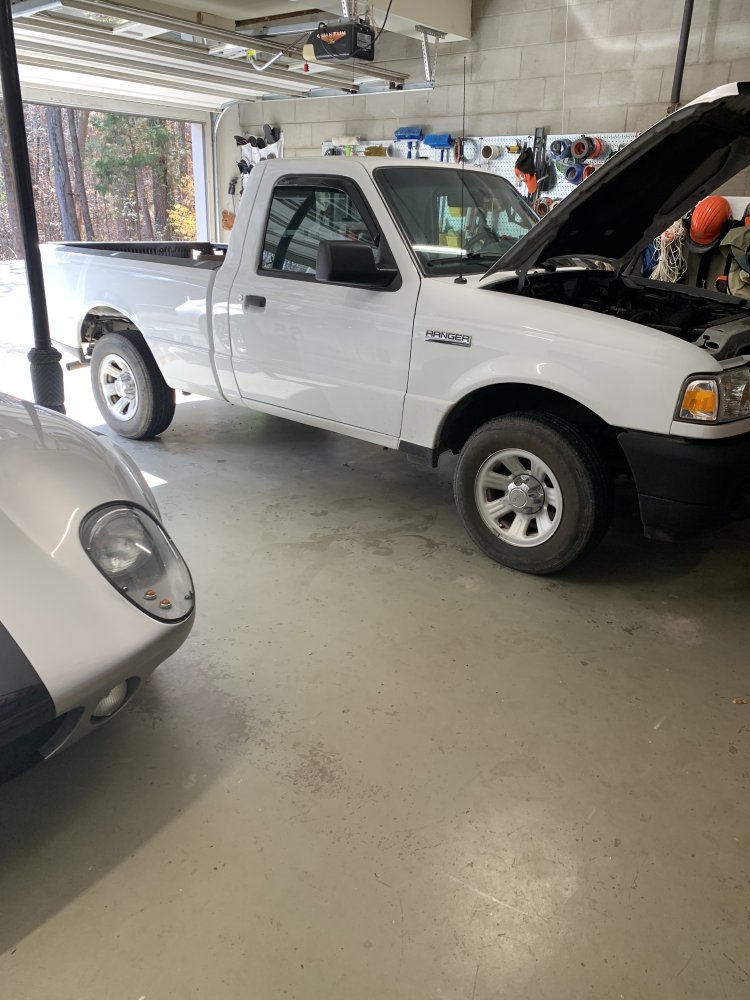

Here she is serviced and ready for more action
