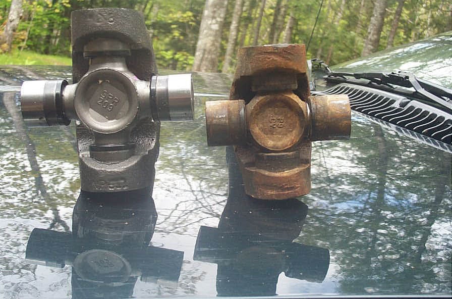

I think the F-150 uses the same size 1350 joint and slip yoke that we have. I don't see how you're breaking that...it's a pretty beefy setup. Todd runs that same shaft, and has never had problems that I know of, and that's with 35x20 tractor tires.
You could go to a larger joint, like a 1410. You'd most likely have to make a custom shaft. But my guess is that you have a problem somewhere...I don't know what it would be though.
1410 vs 1350:
