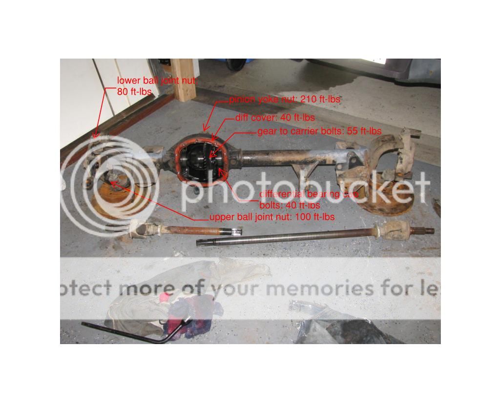

On another note, I got the old lower ball joints pressed out of the axle last night, and my new lowers showed up in the mail yesterday too. Though with working late I didn't get much more accomplished than that. Want to get the new knuckles on by the end of the week or next Sunday.
You do know you will have to weld 0.025" spacers onto the wj knuckles to align the ujoints properly, might be easier to do before they are on the axle.
I don't think you HAVE to weld them, though I understand the peace of mind it would bring. But yea I plan on purchasing those soon, as in I have to buy 1 new unit bearing as well...I think it's actually .25" though, isn't it?
In other news I got the new lower ball joints pressed in tonight. So I need to buy the finish coat of paint for the knuckles and I can torque them down to spec.

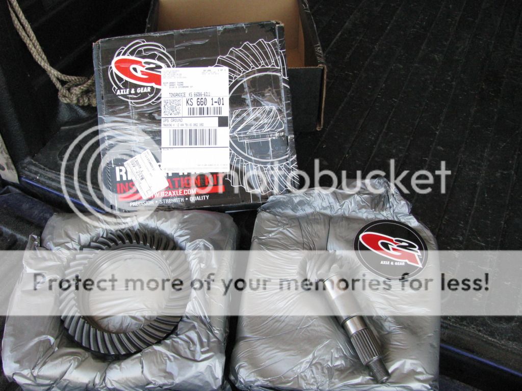

Been trying to secure some gears. Lost out on 2 different Craigslist deals, but am now trying to track down a deal on eBay. Found two good leads. Funny thing is, both CL and EB, have had one of each: 4.56s and 4.88s. But even if I do get either set here, I'll be in need of a carrier yet.
Gears and install kit showed up last Friday. I would have pics up, but life's been crazy lately. Have a deadline for a project at work due on Wednesday. Worked 72hrs last week, looks like I'm on pace for another 63 or something.
Well it ended up being 67hrs this week too :flipoff:
But now for the photo evidence:
