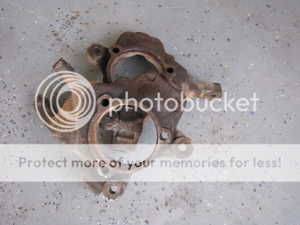

The catch there would be two different calipers with different mounting holes with one wj and one xj knuckle. You have a tj axle though? I can't speak for those. Tie rod holes might be different too, but if that was the case you could drill out the smaller one to be larger
i gotcha. from all my research the the XJ and TJ suspensions were the same. i have no idea though if there are minor details that are different. i've never really worked on jeeps before.
yea I'm not completely savvy on the differences in all of the jeeps, but I do know that these are WJ knuckles!
They really need some cleaning up!

picked up a sponge clean off wheel for my cordless drill last night and got one knuckle cleaned up and primed. Hope to have them painted undercoating black soon because I won a pair of Grand Cherokee lower ball joints off of ebay for them. Also will get new axle shafts in less than 48 hours, I'm excited. So once I get the knuckles on, I'll need to get the gears in sooner than later so I can seal this bad boy back up! Hope to have some pics within the next week for everyone!
I thought that when you run WJ knuckles, you had to run WJ lower ball joints due to an angle thing with the C's, at least when running them on an Xj axle? As for the top, you can run the XJ.
Grand Cherokee lower ball joints = WJ lower ball joints

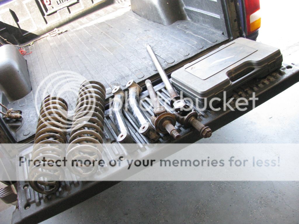

Here's my parts haul from the weekend. I have some closer up shots, but whatever it does the same affect with all of them in.
A pair of u-297 shafts for $50 from friend A.
Then the same guy I got my axle from for free (friend B) hooked me up with the other remaining parts that were on the heep before they tore into...so,
I scored xj lift coils, and the lower control links for FREE! I plan on sectioning the links throwing some solid stock between the two ends, :icon_welder: and even probably sleeving over the top of the stock too, to make them long arms + y-links. I figured these arms were worth sectioning and extending b/c they have great bushings in them. He also let me borrow his ball joint press.
