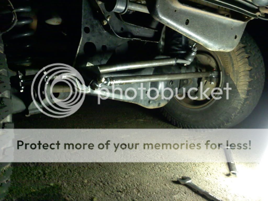

SPDCRAZY, just use a DRE, or draglink chevy one ton joint like so for the pitman arm connection:
Stone crusher steering system

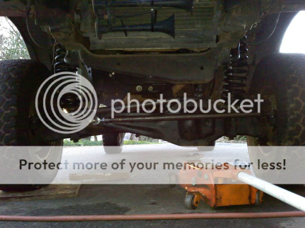

Its a longer joint (overall) than a regular chevy one ton TRE, and has the ability to accept steeper angles of rotation/deflection.
Doing it yourself with TRE's ain't cheap, I've spent just shy of $400 on my setup. Probaby could be done fairly easily for $300 though.
Anothony has the best prices, and if you aren't concerned with running heims, go with his product.
I just finished my setup this past weekend.
