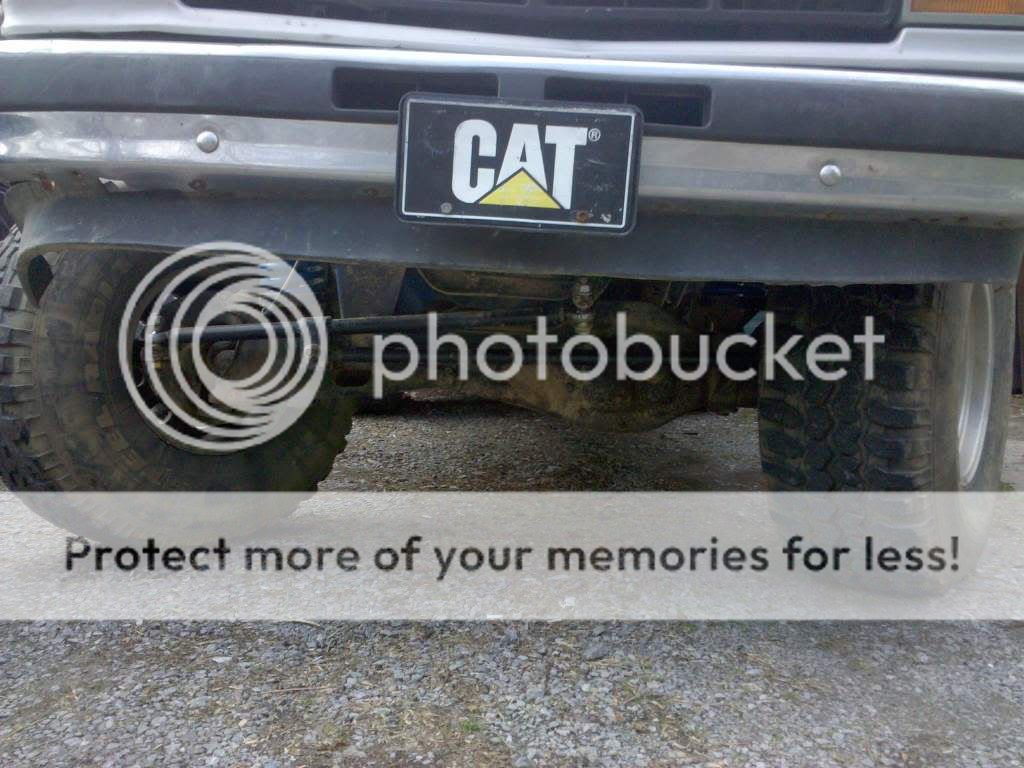

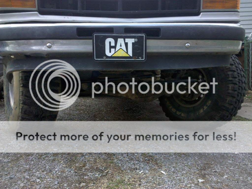

I never noticed this until you posted it. You are correct, the heim should be mounted to the bottom of the pitman arm. There is no way it can touch, the pictures are decieving because they don't show 3-D. The tie-rod actually runs behind the drag link and even at full lock, they aren't close to touching.
These aren't full lock pics but it kinda shows what I'm saying.

Figures I'm the dumbass who put the rod on the wrong side of the arm. Should the bolts go up thru the bottom or down thru the top? I wondered about that when i copied "most" of ThatGuys instructions. I'll git on it tomorrow AM after work!
Thanks fer the pics Bonedoc!!

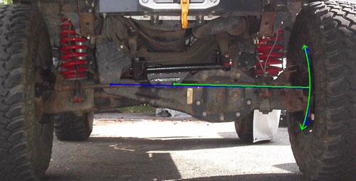

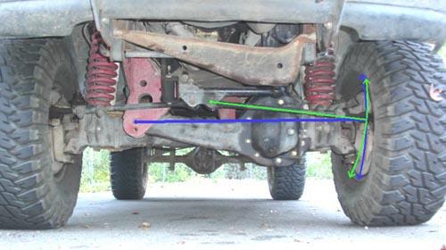

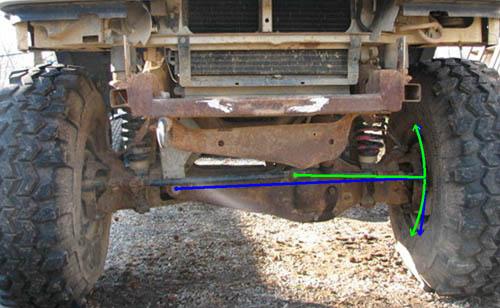

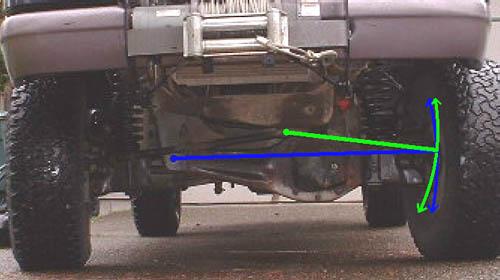

"In phase" simply means the steering link and axle beam are inline (or in sync) with each other centered right at ride height. This allows the steering & suspension to travel with each other for as long as possible so that the amount of bumpsteer is minimized.
An example of a steering linkage being 'in phase'
"Out of phase" (steering's pivot point is too high = lots of bumpsteer):
Almost 'in phase'
Way out of phase:
Taken from this article:
http://www.therangerstation.com/Magazine/winter2008/steering_tech.htm
