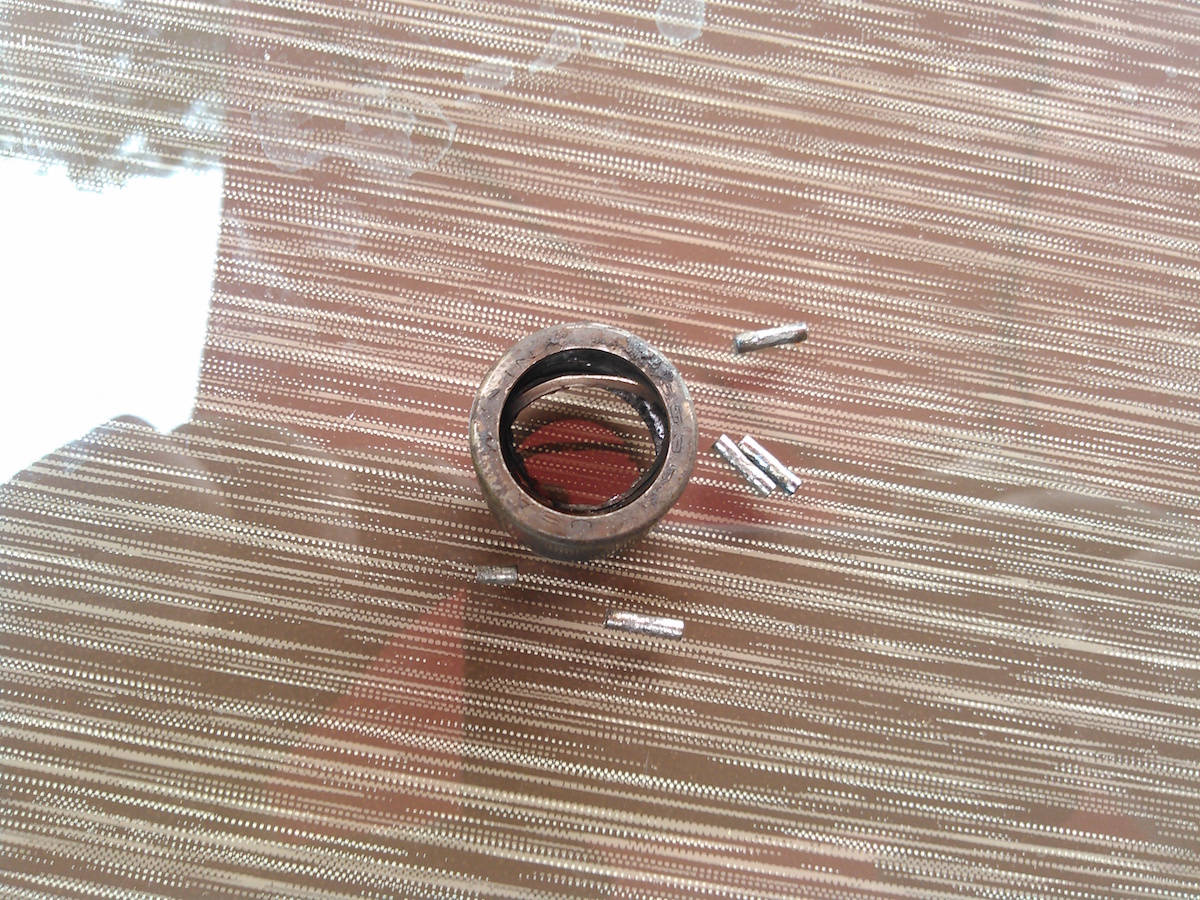

So it turns out the pilot bearing is shot. this is all that was left of it.
I also found that the slave was full of air again. I can't find any evidence of a leak but I bought a new one anyways. the throw out bearing was not in the best shape either.

be sure to clean up the input shaft. that pilot probably left some damage on it.
